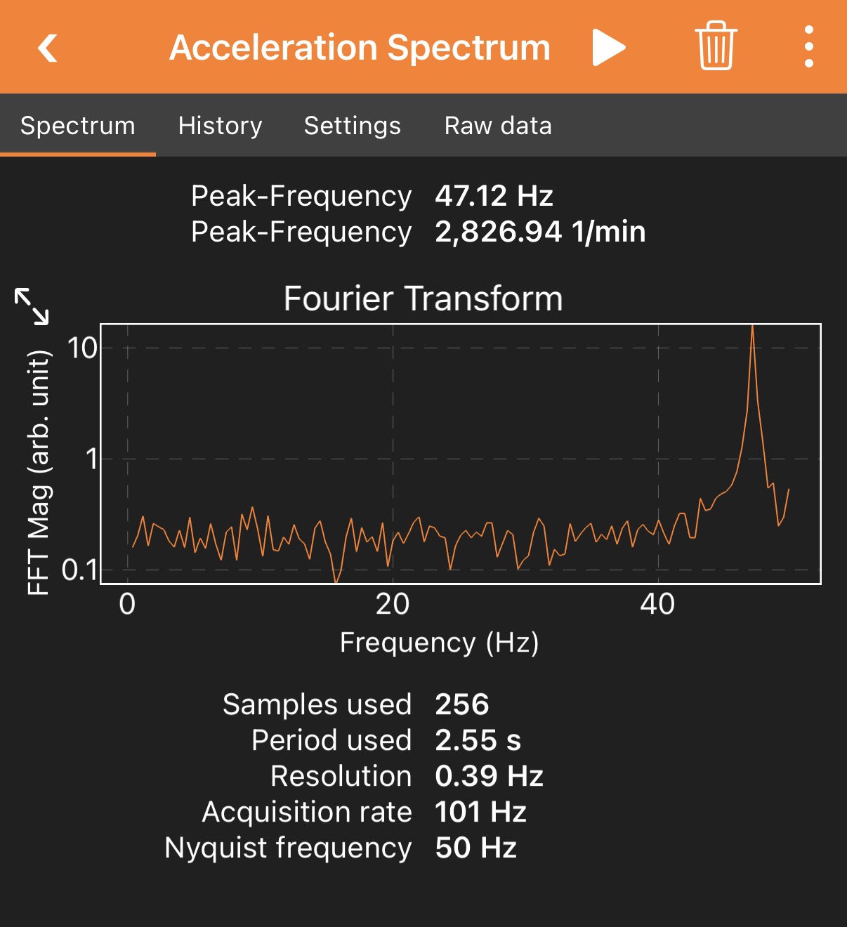

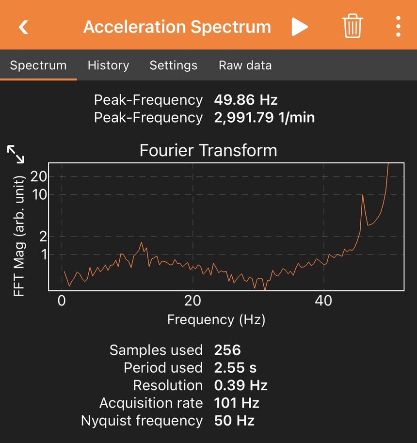

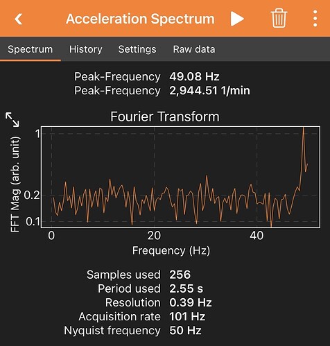

I gathered some data tonight on a DHW run to see what the peak Hz was being produced at various points: top of the unit, base of the unit, the pipework immediately behind the unit, the wall inside the house, pipework in the cylinder cupboard. I still need to do another measurement in the loft at the clips but I’m fairly certain it’ll fall into the same range 45-49Hz is the peak across all those locations.
The engineers are back on the Mon 7th Sept and based on the above, the plan is likely:
  • rubber-lined clips to replace the existing hard white plastic clips used throughout
  • base with scope for allowing pads to be slotted in (although I’m assuming new feet are softer rubber?)
Plan is to rework the pipework off the back of the unit with a new approach using PEX-A. Currently there are four 90* bends before the pipework goes up the wall to the loft. Instead, switching to PEX-A it can be changed to a smooth sweeping bend which will reduce resistance and being rubber it should help dissipate the vibration especially coupled with rubber-lined clips.
That’s the plan but scope for change on the day. Thankfully with the the phyphox app it’ll help compare/contrast with any changes made.

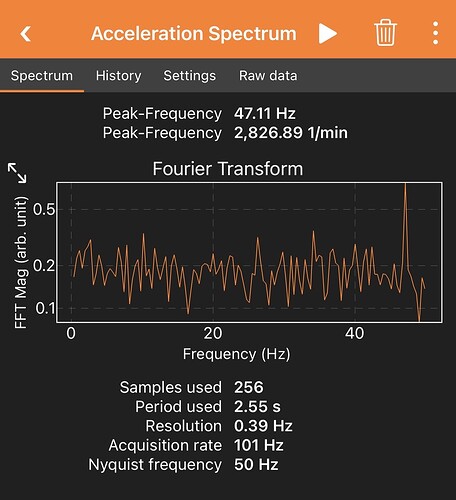

On top of the Cosy 6:

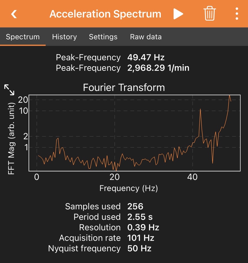

On top of the slab base:

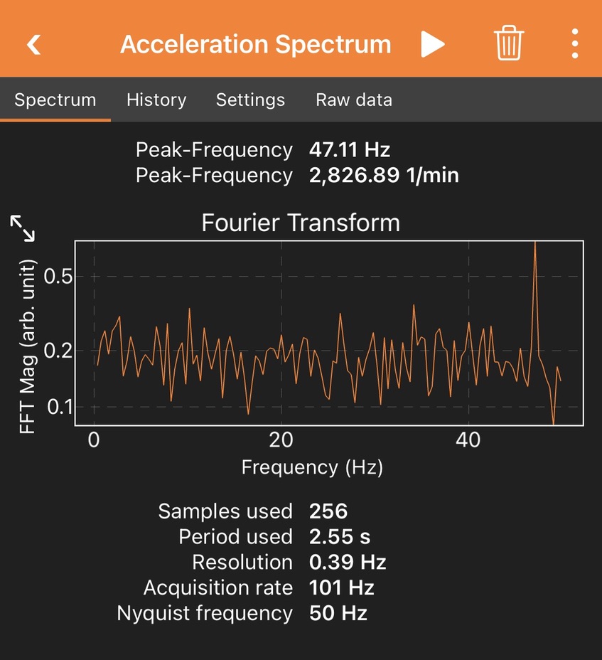

On top of the pipework behind the unit:
On top of the trunking on the wall:

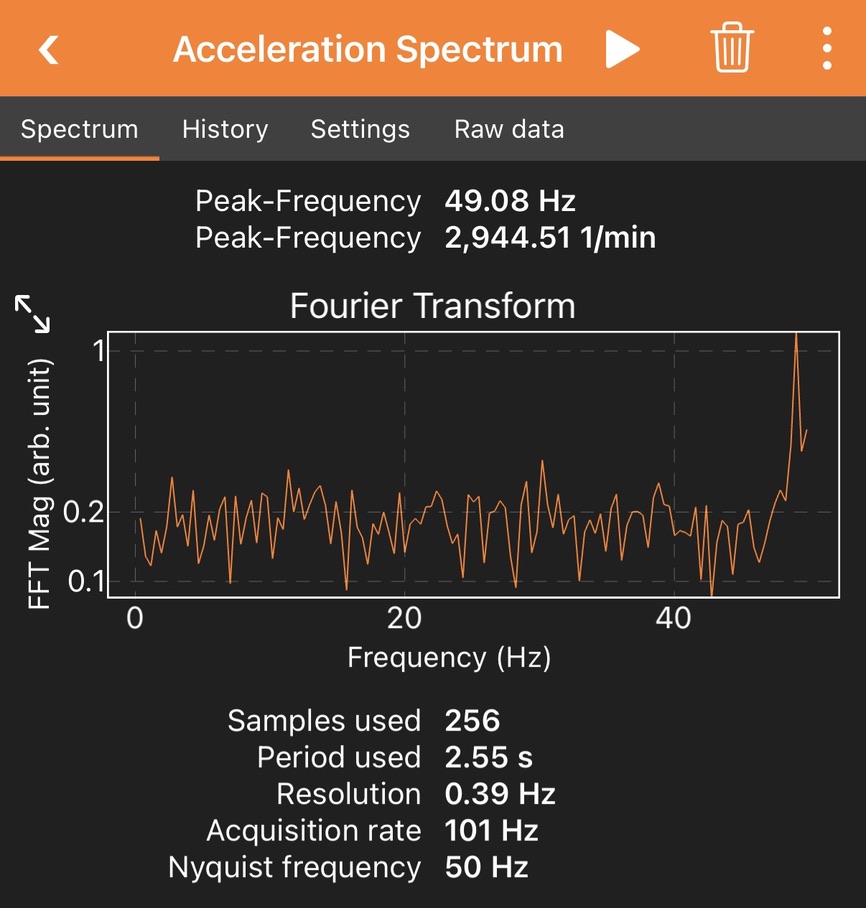

On the plasterboard inside the house which is directly behind the pipework on the brick outside:

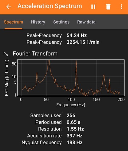

Haha you have accidentally gone the other way, your phones accelerometer is not high enough frequency to be super useful, it would be better to find a phone that goes up to 200Hz.
You are not really searching for the peak frequency, but looking at the magnitude at a particular problematic frequency that should “pop” out. But it does look like you have found it, and hopefully being able to live visualise aids in resolving easily.

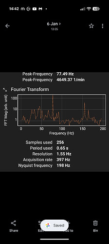

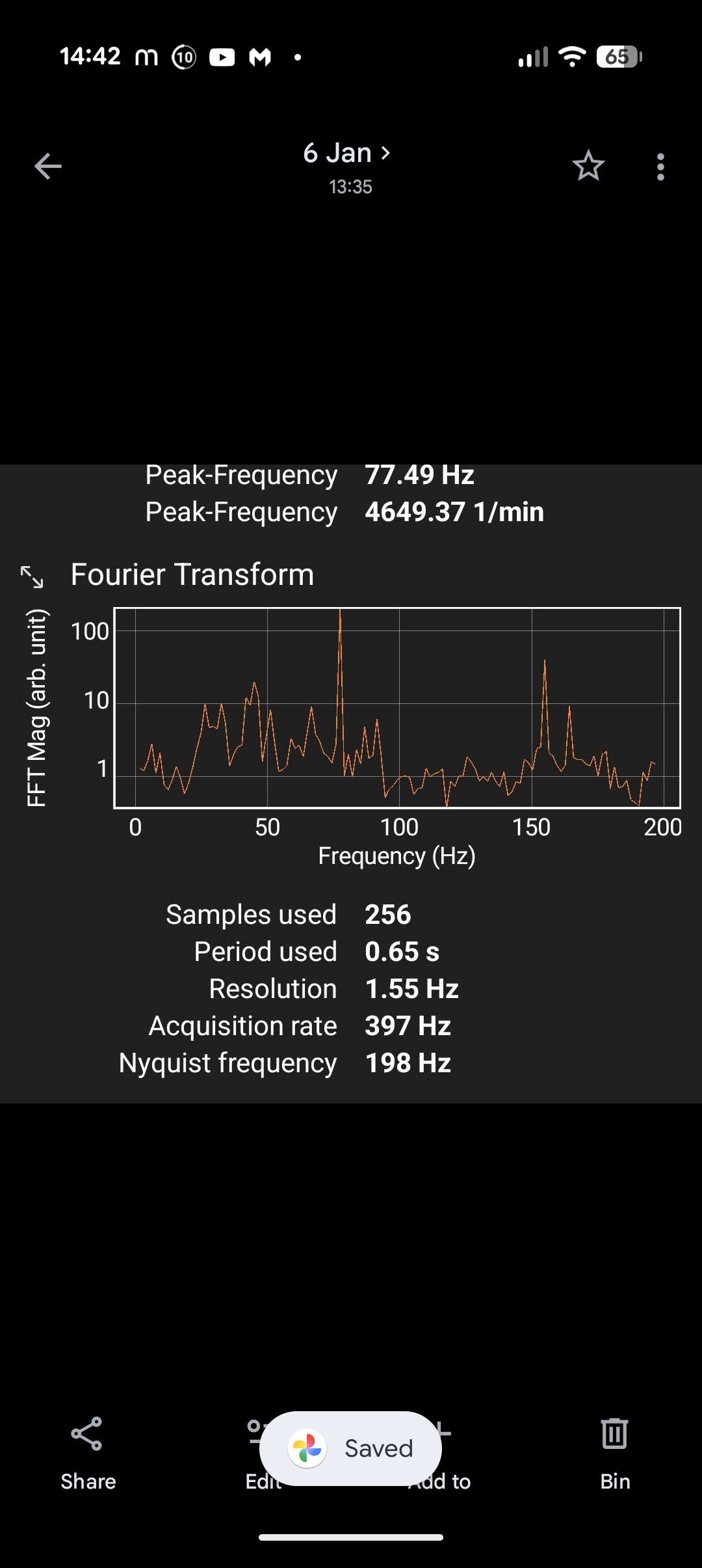

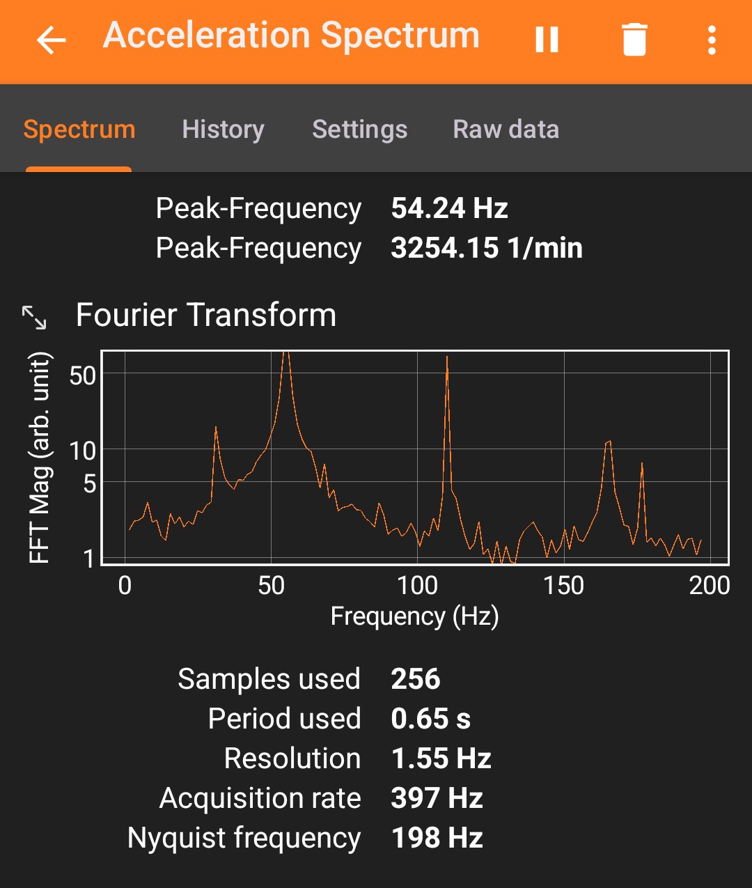

Here is mine directly on unit.
Thanks for sharing the comparison. I’ll see if I can borrow an Android phone which typically has a high resolution. Unfortunately all iPhones seem limited to 100Hz
What results do you get on the slab and on the pipework or clips internally?
A similar profile; but the magnitude is below 1 now that the fan is not spinning at the problematic rpm.
When it was bad it was easily above 100 on slab and over 20 inside on the bedroom wall. Id say anything above magnitude 10 was audible in my house, keeping in mind is arbitrary unit.
