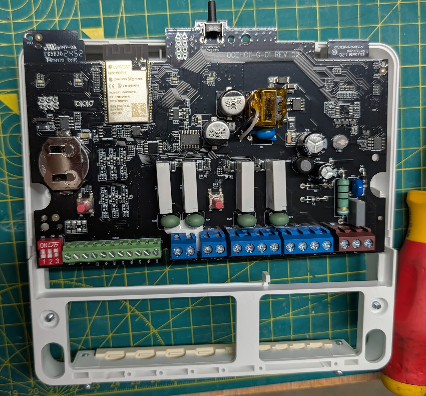

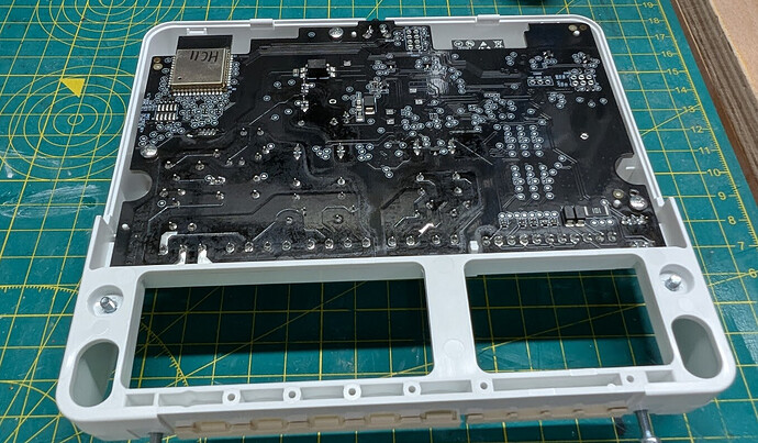

Might as well post some internals now I have paid them.
Cosy hub: Seems very similar to hive. esp32 rover and zigbee radio.

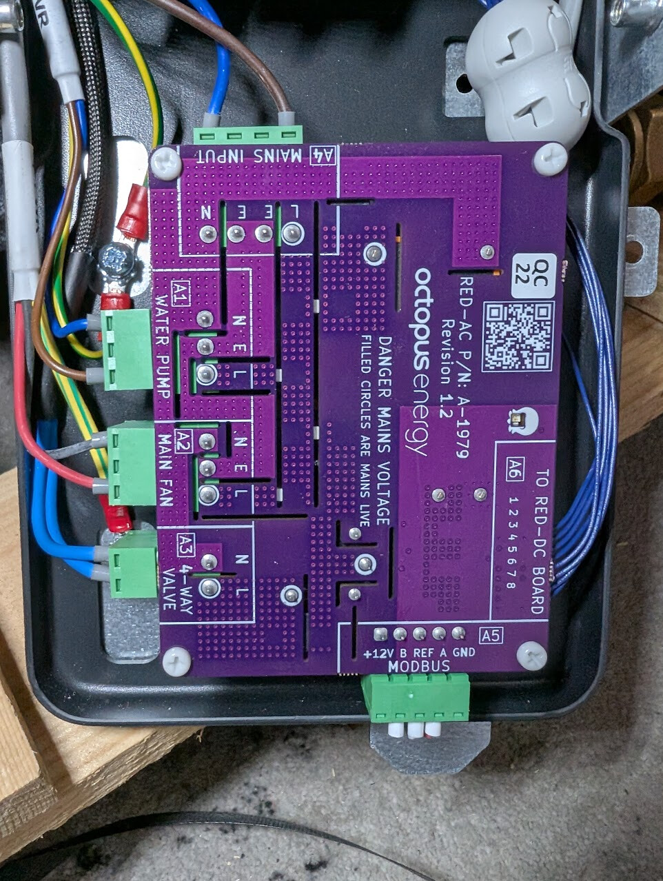

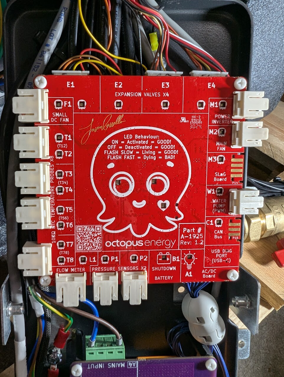

Heat pump:
Backwards firing smd leds… gold immersion signature… STM32G4… some nice effort went into it.

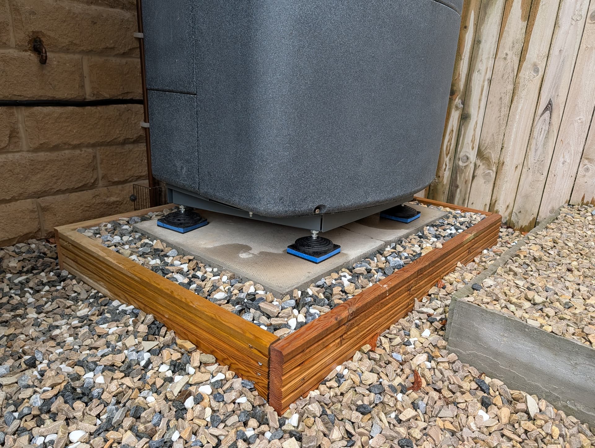

The leg base mostly solved it. My EVA blocks even more so. I can only really hear it at maximum ramp for a hot water call but it’s nowhere near as intrusive as it was.
Have they not put the flexi directly from the unit to the wall? Maybe ask them to troubleshoot and suggest a service bend with the flexis.
Other than this everything is great the performance has been excellente.
Can you post some photos of your install, with all of your mods visible? Intrigued!
Sure. You could calculate the required material and thickness with some maths but these were £15 on amazon for 4.
The leg base feet are kind of a hard plastic. So I’m sure later versions will be rubberised. You can easily just wind the legs up one at a time to place these under without moving anything.
Octopus have said they will visit and put rubber bushings around the central “bolt” too. I didn’t want to move the unit off the base on my own to do this.

In reply here, yes there have been improvements, via firmware or myself? I can’t tell exactly - because I had the keg kit installed, which helped about 10%, I then put EVA pads under each leg, this has helped about 80% and almost solved it. I can now only hear it on initially very hard ramps (for about 10 mins when it ramps up before modulation) or hot water calls. It’s still enough to be an “issue", so I don’t run the unit overnight.

No, the legs of the base kit are quite hard plastic, so wouldn’t really decouple anything.
The leg kit is very new, so I suspect this will change. My guess is that the keg kit is primarily intended to reduce groundworks as you could put it on non-level sites.

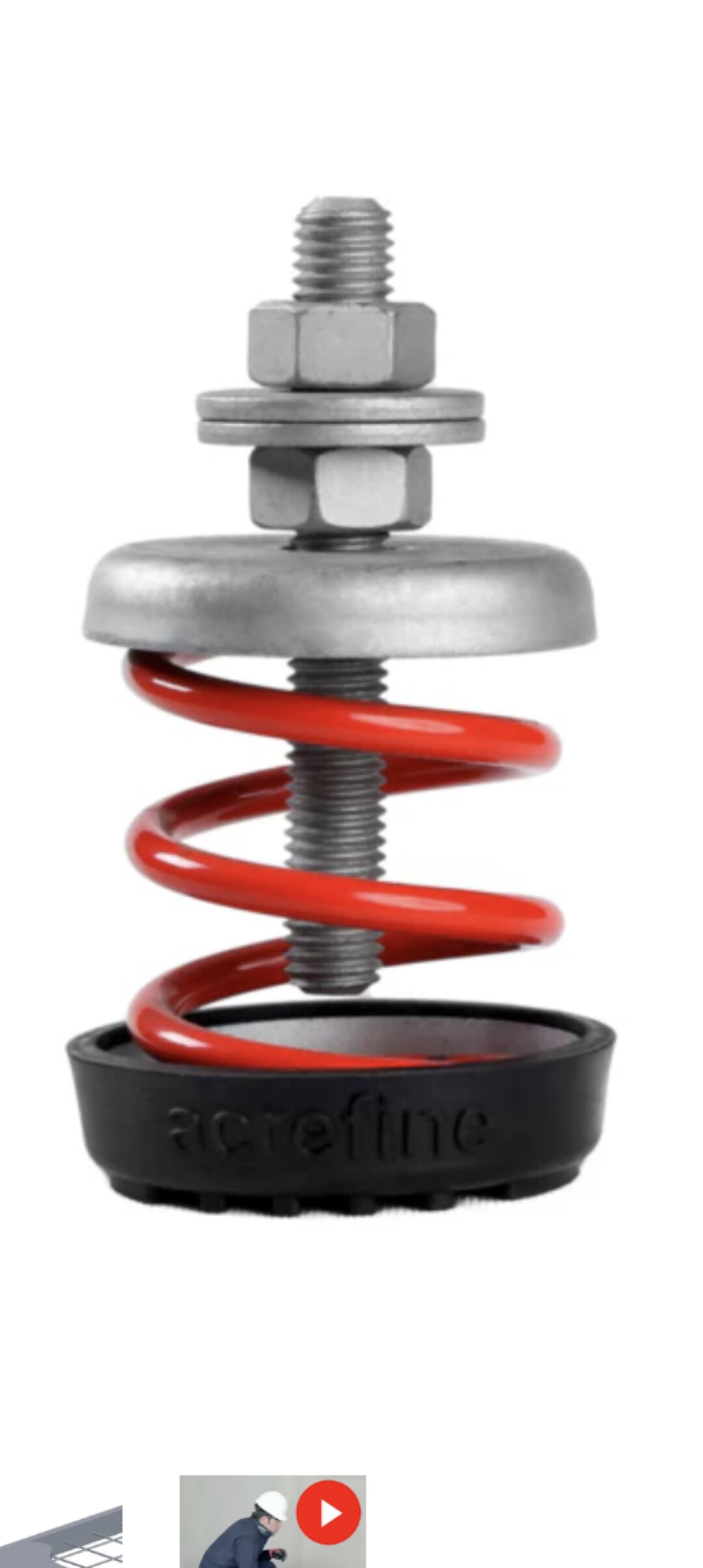

I’m going to try some proper spring mount legs next.

Waiting for the spring dampeners to arrive, which will be a direct replacement for the legs.
