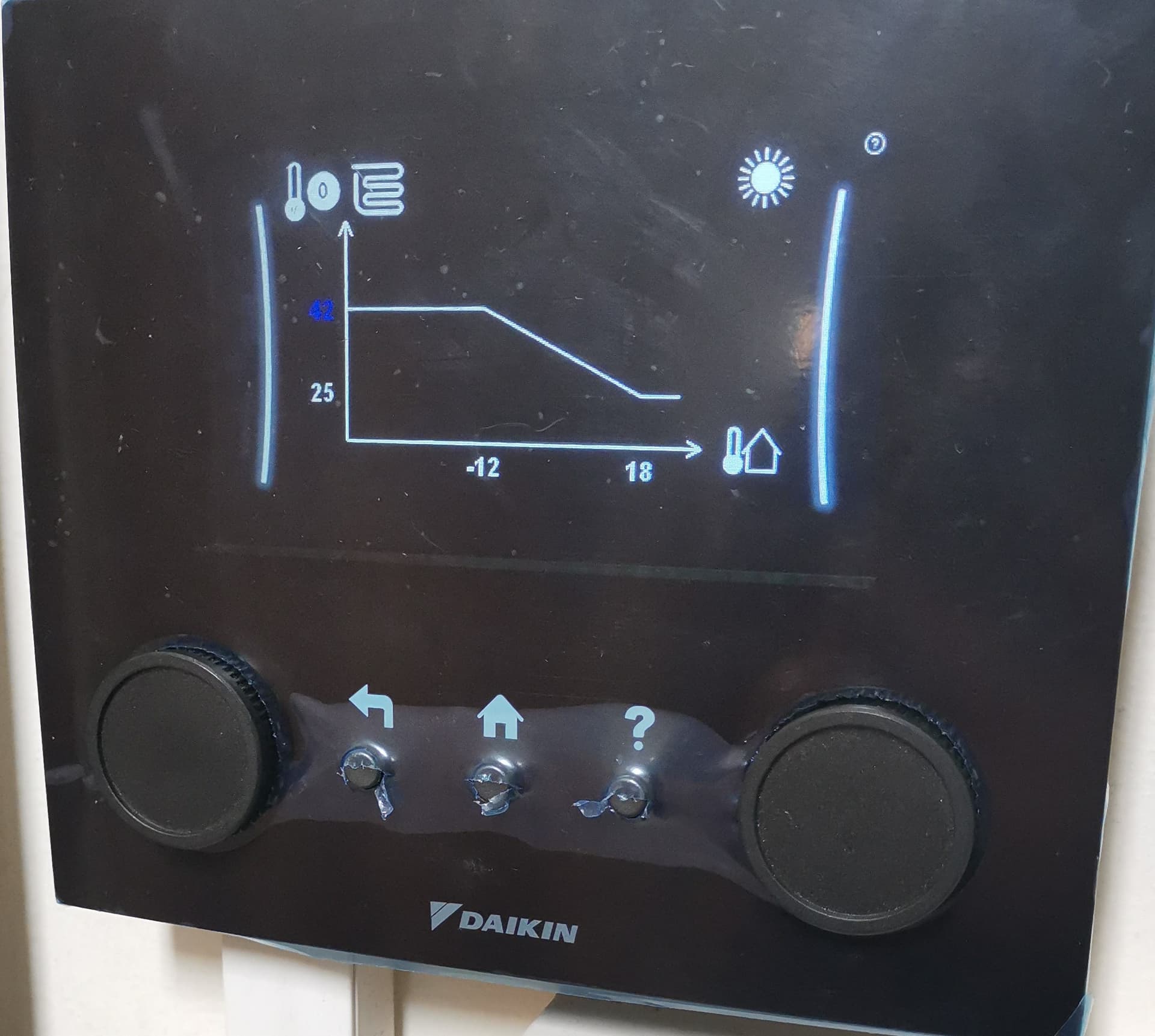

Here’s the weather curve we’ve evolved!
I presume the shallower the slope the more it has in decision resolution to draw on?
Might be totally wrong though or it’s a pretty blunt instrument in its calculation?
Today that gives us a steady state of
It seems to work right down to 25C output and then shuts off itself.
have you tried reducing the heating off at xx degrees c , mine is set to 14 degree outside temp and the heating shuts down
but agree i also have had to shallow of the curve quite dramatically
I’m
Still
Playing around a little bit , but never needed over 35 degree flow temps this heating season
design temp was 50 degree flow at -2.7
That’s interesting.
We had xx at 35/ -3 for a while during a mild spell, then it got too cold for that, but the slope was right.
Recreated the slope by dry wipe marker on the screen😂 but with a higher xx and much lower -.
Working pretty well.
It will of course never get to the upper temp!

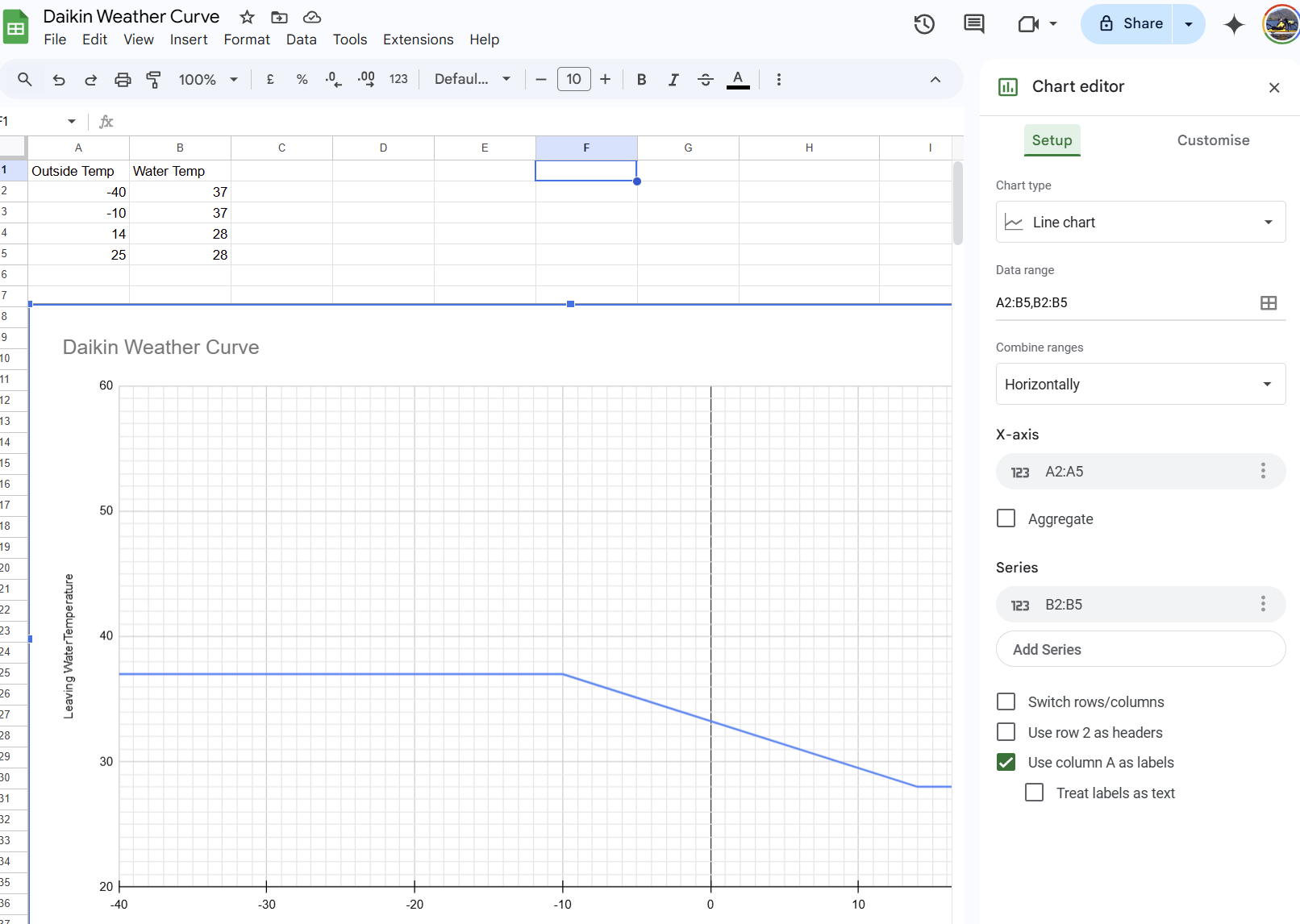

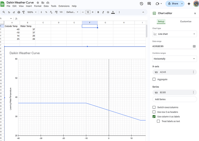

one neat way to recreate the weather curve is in a spreadsheet. Here I am using google sheets, which also give me a version history for every change I make. Also makes it easy to check what flow to expect at any given outside temperature

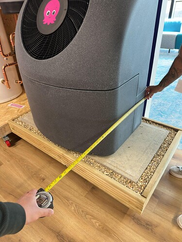

As an update, will get install date soon. There has been a bit of back and forth if the Cosy 9 has a door or not, it has a regular removable panel.
