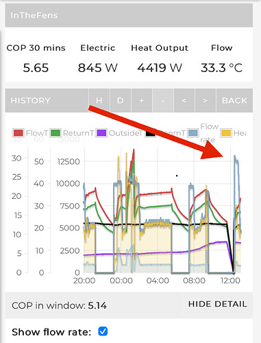

Since I installed ESPAltherma, I can now see flow rates, which seem(ed) stuck around 24L/M - yet I seem to remember soon after installation (September ‘22) seeing just over 30L/M……and have seen other similar units with higher flow rates
I had to ring Octopus in October re: annual servicing, and the earliest they could do was start of Jan ‘24 :grimacing:
So decided to investigate and came across two pretty easy serviceable elements: filter/strainer that when particles accumulate, flow is restricted, and magnetic filter.
Note: Octopus did not power flush/clean the existing system prior to connecting heat pump. (Controversial I now know…)
I used these resources amongst others:
Service Manual for Daikin Altherma 3M
Service Manual altherma_3_m.pdf (7.1 MB)
Mine was filled pretty badly with black gunk (but maybe not as badly as I expected and forgot to photo it prior to cleaning out.
I’ve gone from 24L/M to ~30L/M (yay! But wait til the end…)

Up to a max of ~34L/m now - that’s up ~10L/m (~40%) from yesterday after cleaning out both strainers/filters (the other way of looking at it, it was down to ~70% of a near clean system at my house):
My system clearly needed flushing, and still does.
Until then I’ll keep cleaning these both out and keep an eye on flow rates which if monitored over time, can show how healthy things are.
