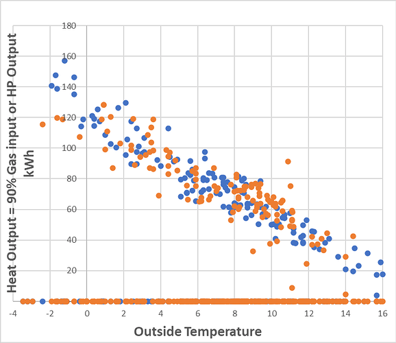

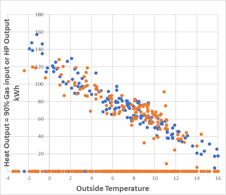

Here is my heat input for well over a year - both gas boiler (blue dots) and heat pump. (orange). Each dot is a day.
As you can see the daily kwH at -2 is approx double that at 7 to 8c although my heat pump does struggle at -2 due to the defrost issue so the internal temp was lower than desired. So I would say that a good method is to take the heat required at 7c and double it.
You will see from this that the 150kwh I would like to put in at -2c equates to a rate of 150/24= 6.25 kw but as it is set back at night my heat pump operates for a max of 18hrs and so has to put heat in at a rate of 6.25 x 24/18 = 8.33 kw. During defrosts my 10.6kw heat pump only averages about 7.5kw which is why it is struggling at -2c.

Your HP is clearly too big. I’ve just spotted an easy way to use my data to get your sizing correct.
My maximum daily gas input was 158kwh at 90% = 175.5 kwh actually purchased
Your is 110kwh so mine is 1.6 x yours.
My heat pump is slightly undersized at 10.6kw so your will be slightly undersized at 6.625 kW

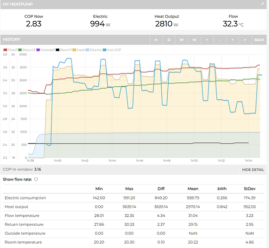

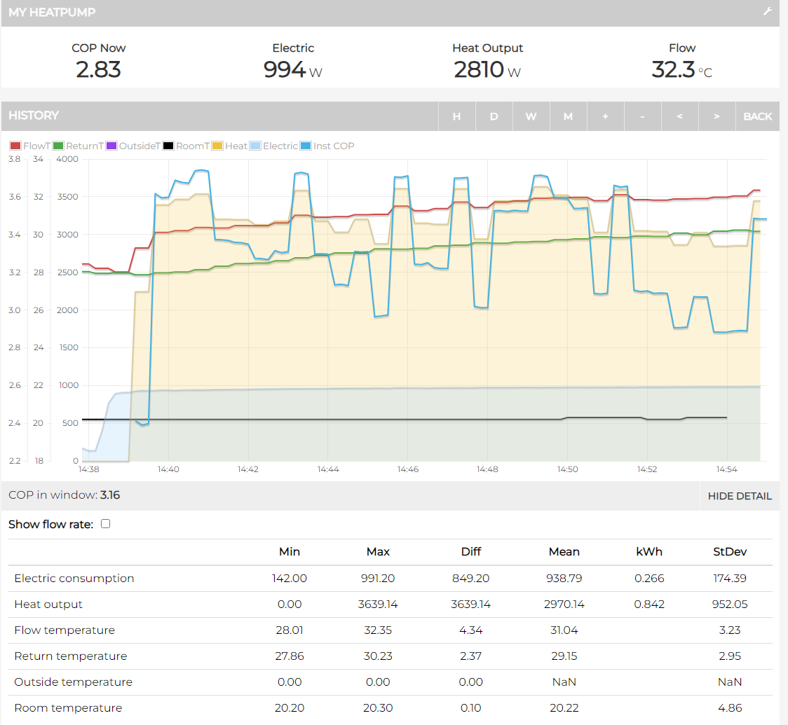

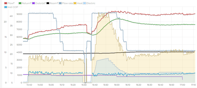

What is it doing?
It is set at a fixed flow temperature of 42c but it just sits there building up slowly at 32c which we all know my radiators cannot cope with. Why doesn’t it just heat the water to 42c as requested.
I guess the answer will be something to do with radiators and room temperature but if the room is hot enough I wish it would just stay off until conditions allow it to run as it has been asked to.

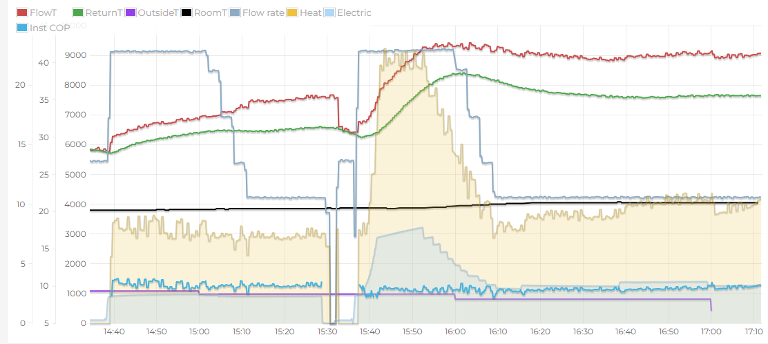

I cant say I understand why the cycle that started at 14:40 should be different from the later one - same flow but no boost in compressor power at the start. Also the 14:40 COP was better. Could you try dropping the flow set point to 39c to see if it settles there?
In testing mine with Trystan yesterday there was a massive difference in performance when I simply raised the fixed temp 2c and took of my ±3 modulation. I wonder if yours, with limited radiators is in some kind of unstable equilibrium.
At about 15.35 the flow temperature was still only 35c
The Madoka is set at 22 and the displayed room temperature was 23c.
I turned the requested room temperature up to 23c to see if I could get the flow temperature to increase but of course the heat pump turned off because it was already 23c in here.
I then increased the requested room temp to 24c to get the heat pump to start again.
That used a lot of electricity.
I may be better removing the Madoka influence and just running a fixed flow?
It has taken the best part of two hours to settle down into some sort of reasonable operation.
You are putting in 3.8kw at min compressor power when the house loses 2.7kw - so it is going to have to cycle.
Your flow temp is stable at 42 and so you are not radiator limited … which is a good result!
I would not remove the Madoka influence as your house will just get warmer and warmer until the radiators become limited again and your COP will get worse. The key is to get the lowest flow temp that will give you the flatlining flow temp profile. So I would drop the ‘fixed’ temp to 40c and add ±1 Modulation to see if it can find the optimum flow temp. between 39 and 41. The Madoka will switch the unit off at room set point +0.5c and off a degree below that.
It’s not clear yet if the Daikin detects that it is cycling and changes its behaviour to optimise that but it might do.

I was just checking the electricity usage and note that my back up heater was used this morning. Is that necessary?
I have a confession to make to Colin.
When I changed to fixed flow rate a few days ago I was sure I switched off modulation but I don’t think I did it properly as when I went to turn it back on it was already on at 10.
Explains a lot.
Sorry Colin!
