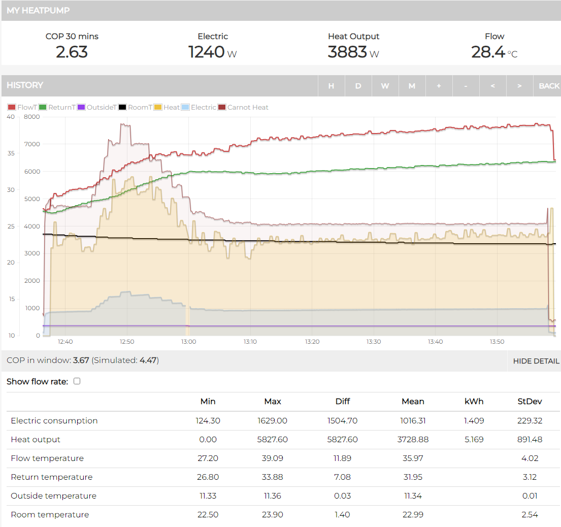

I feel that a lot of the inefficiency that I see comes from the initial phase of a heating cycle, once it has settled down it is pretty good but it takes a while, 90 minutes this morning. Overall though it was ok.
But after the initial heating cycle it just seems to go wrong. I can do what Tim has done, simulate the heat output using the carnot COP equation and it’s off unlike the morning when it had settled down.
I don’t know what is different from the morning for the rest of the day but it just doesn’t work as well.

I think the low COP at cycle start is just the energy needed to heat the flow and return and the pipes and radiators back up to the operating temperature. You do in fact get this back at the end of the cycle - you can see some minutes when the compressor is off but the heat out is still positive (infinite COP). SO we need to look at the full cycle COP.
I am not sure that Matts system had stabilized at 42c , especially when the outdoor temp rose to 12c where the ‘potential’ COP and min compressor speed output will have risen. It also looks as though it is switching off at 38c - is this because the setpoint has been lowered or modulation has lowered it? Or because the room thermostat switched it off? If the former then try setpoint = 44c. I think we have to find the system equilibrium as a first step.

Your COP this morning when it was nearly stable was 3.98 from 7am to 10am. My quick estimate using the carnot formula suggest that this would rise to about 5.5 when you can lower the flow temp to 35c. That is the equilibrium level and not the overall level.
This is perfectly consistent with my system which produced a COP of 5.6 at 35c flow for a 3 hour stretch earlier this afternoon.
So we know your HP is working as it should and that the potential is there to get better.

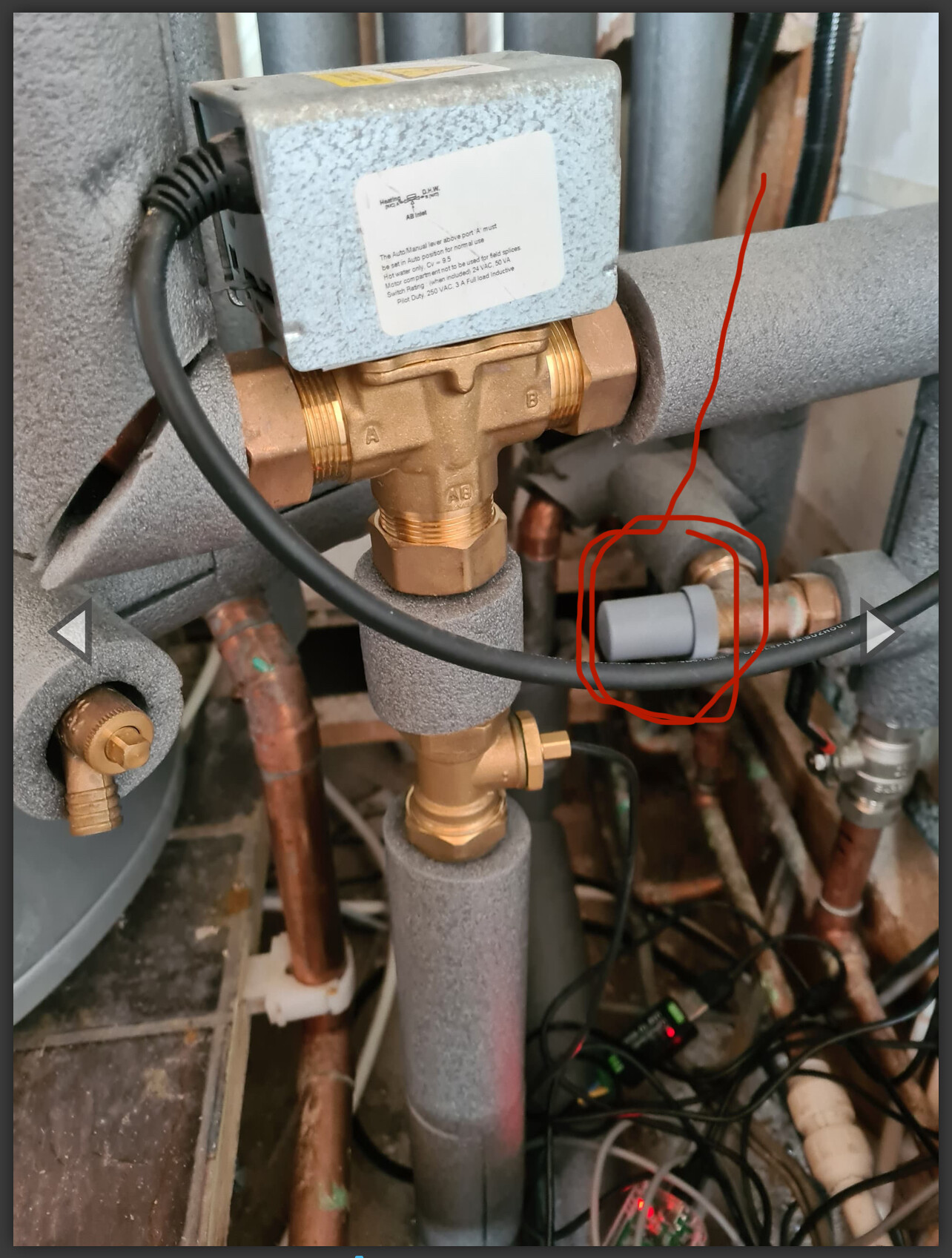

It looks like you have an auto bypass valve fitted. I have one of these, and I believe it’s unnecessary if you run an open circuit, or even have one rad with no TRV, I’m sure others can explain better.
If it’s not setting correctly it can cause issues. On advice I shut mine in completely so it won’t activate.
Might be nothing but worth checking on its setting, screw off the grey gap to check.
Edit: additionally I have just recalled its position close to the valve is also poor. If installed, it should be located at the further point in the circuit from the pump. Mine is installed in a similar position to yours, and early on was causing a short circuit under certain conditions.

Yes agree with @HydroSam, I have the same auto bypass valve fitted by Octopus. Try closing it fully ( noting current position to be able to put it back)
I promptly closed that down fully after they left! No issues…

If the auto by pass is fitted then I wouldn’t close it completely but set it so that it only opens when all the TRVs are closed (and any non TRVd rads) . There is a set up procedure for this on the Daikin. You will find that the pump trips below about 7 lpm as far as I can remember, so you want to set the bypass just above this trip point by trial and error. Although it is not ideal to be close to the pump I would imagine that the above procedure should take care of that as the Daikin will be running the pump at maximum in the test and so the pressure across the bypass will be at the highest it will ever see (the bypass is really a relief valve).
Just before anyone else says how bad their installation is - I found that my installers had a) duplicated my 22mm pipes to my HW tank with 28mm (really? the pressure drop across 10 m of 22mm is hardly an issue) and b) connected the flow and return of the original 22mm with a ball valve which they left fully open. A brilliant set up! So I bought and fitted a bypass and set it up as above.
