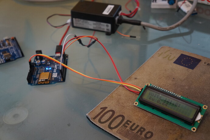

the MTU runs are 3 volts so it compatible with both UNO and esp and the CT are 200 amp and very accurate and rated both indoor and outdoor usage
the MTU unit that i hacked it came from my old TED1001 - I bought a few off ebay when they were selling $20 RDU and MTU a complete units :slight_smile:
basically just connect a wire at this point it is TX of the MTU CPU sending data to the POWERLINE encoder ( orange wire)
and one to a Grounding point ( “black wire”)
then basically connect the black ground wire to Ground on the arduino/esp and the orange TX to the RX of the arduino/esp
as you can see it works both in negative and positive flow. even thought the ted 1001 RDU does not support it. it is very accurate from my testing

what the serial display from from the device it has always being accurate for both for me… as you can see from the above picture
