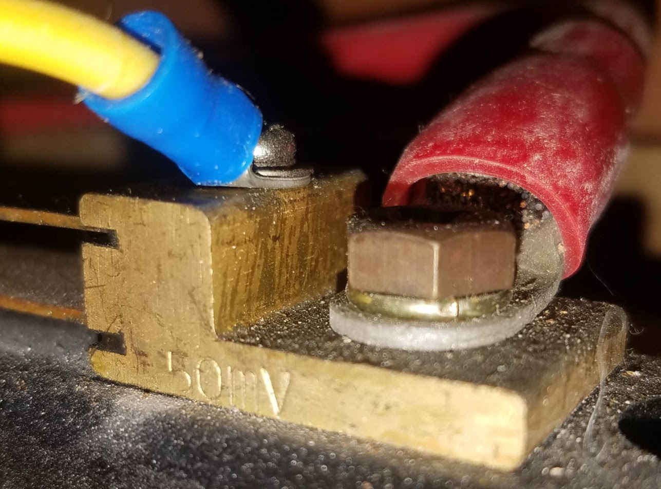

DC Ammeter connected directly to the shunt below (100A/50mV)
DC Shunt
If my above suggestions are correct, then it comes down to tapping into the DC shunt to get to DC current. How would I do that?

I think a small isolating transformer (aka a.c. adapter) giving you anything above 1.6 V followed by a voltage divider - just like we do for normal mains - is the easiest.
This is the tricky one. As one side of the battery is common to the Arduino common, for the voltage it’s a simple matter of dividing the voltage down and putting it straight into the Arduino ADC.
The shunt is in the other pole of the battery, and so you’ll need an op-amp having differential inputs that can accept a voltage above the op amp’s supply voltage (unless you feed the Arduino from the battery side of the shunt, in which case equal to), in order to amplify and shift the shunt voltage down into the Arduino ADC’s operating range. As it is, if your Arduino is a 5 V one, the ADC input is 0 - 5 V and shunt gives you 0 - 50 mV, so you need a gain of 100 to use the full range of the input. That’s not straightforward if, as I suspect, you have a fairly large temperature range over which you expect to operate (I’m thinking thermal drift, etc). A 3.3 V Arduino would ease matters slightly. You probably don’t need the full 1024-step resolution, so it should be possible to trade resolution for stability by reducing the gain - a resolution of 0.5 A is still probably better than you need, and would help the stability significantly. I’m thinking in terms of a specialist high-side device designed for the automotive applications.

I get the “drift” no pun intended (well maybe a little) re. the DC current situation. If I am reading this correctly, I would be using the differential op amp to pick-off the voltage differential across the shut then condition to get it into the 3.3v arduino. It’s been quite a while since I worked with op amps so another skill to dust off. If you can point me to an appropriate link that might be related to this situation to get started I would appreciate it.
I’m looking for a single supply, voltage difference amplifier. And I’m struggling. The Texas INA149 will work on a single supply, it can handle an input voltage way above what you need, and shift the voltage down into the Arduino’s range, but it’s unity gain, so you need another stage of amplification to get a decent output for the Arduino.

If you use any op.amp (i.e. one not specifically designed for this job with closely matched resistors on-chip), you will have a problem with matching the resistors so that you maintain common-mode rejection. You don’t want the zero to move about as the battery voltage changes, for example.
Simplifying Current Sensing (Rev. A) is worth looking at.
The INA220 does look appealing, I think it will do the job for both voltage and current, but you’ll need to write the software to extract and process the data.
The INA260 isn’t ideal. From the above link: TI’s INA250, INA253 and INA260 devices feature a current-sense resistor integrated inside the same package as the current-sense amplifier. You’ve already got your shunt, you’d have its 2 mΩ shunt plus the resistance of the connections in parallel with your 0.5 mΩ shunt, I’d hate to have to estimate contact resistances etc to work out how the current would share between them. And the calibration of your ammeter would then be wrong - by an equally hard to estimate amount.
But if Adafruit has done the software for that, what you’d need for the INA220 is probably almost a clone thereof.
really appreciate your insights Robert. I’ll do some more digging today.
Did some more digging and found this Adafruit product. Overview | Adafruit INA219 Current Sensor Breakout | Adafruit Learning System. Has shunt on board vs onchip with the previous product so I can remove it and use boat’s shunt. They have a library for the device so should be straight forward. Will keep you posted and open to comments.
