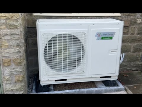

This video may be helpful, explains buffers and volumisers and when (not) to use them:
Not quite the same, but Michael removed the low-loss header from his system, did not see any difference: (see accompanying video by Urban Plumbers)
