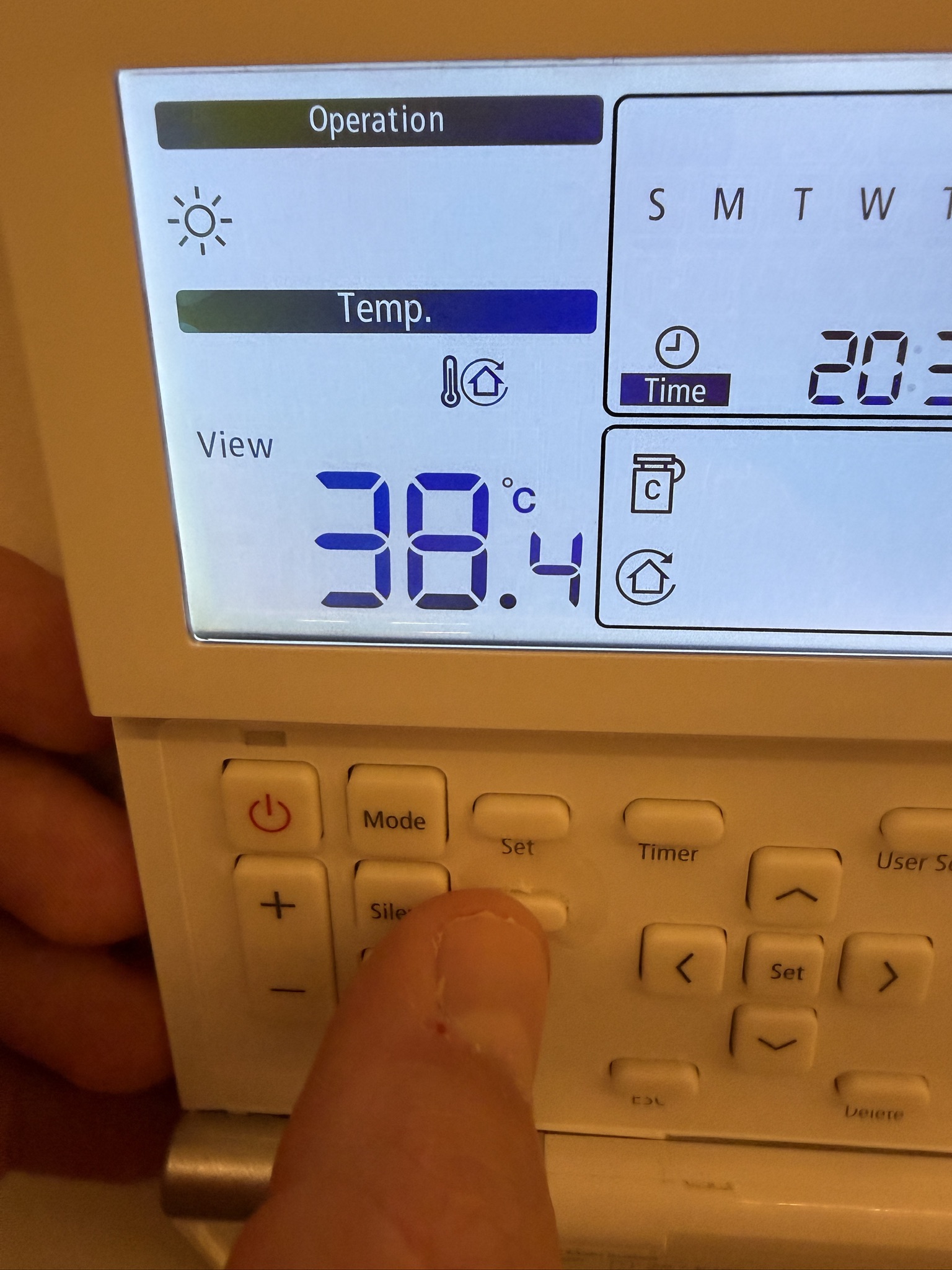

Hello all
Very interesting topic that help me to understand and troubleshoot my Heatpump high energy consumption problem.
My Samsung Heatpump is 2015 gen ( AE160JXYDGH/EU ) with Samsung wired remote controller including 2 Nest thermostats for downstairs and upstairs - upgraded from the analog ones that the installer provided with the installation.
Over the years the settings was 2091 to 1 and 2092 to 0 meaning that weather compensation was not used. After reading this thread I changed the settings and I have set the H1 & H2 of 2011(0) 2012(15) 2021(39) 2022(36).
Which Point to use:

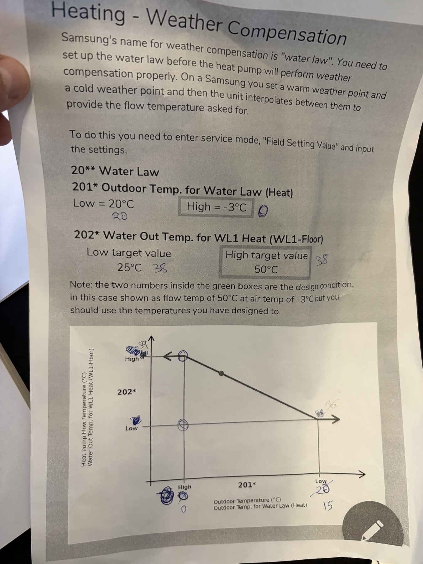

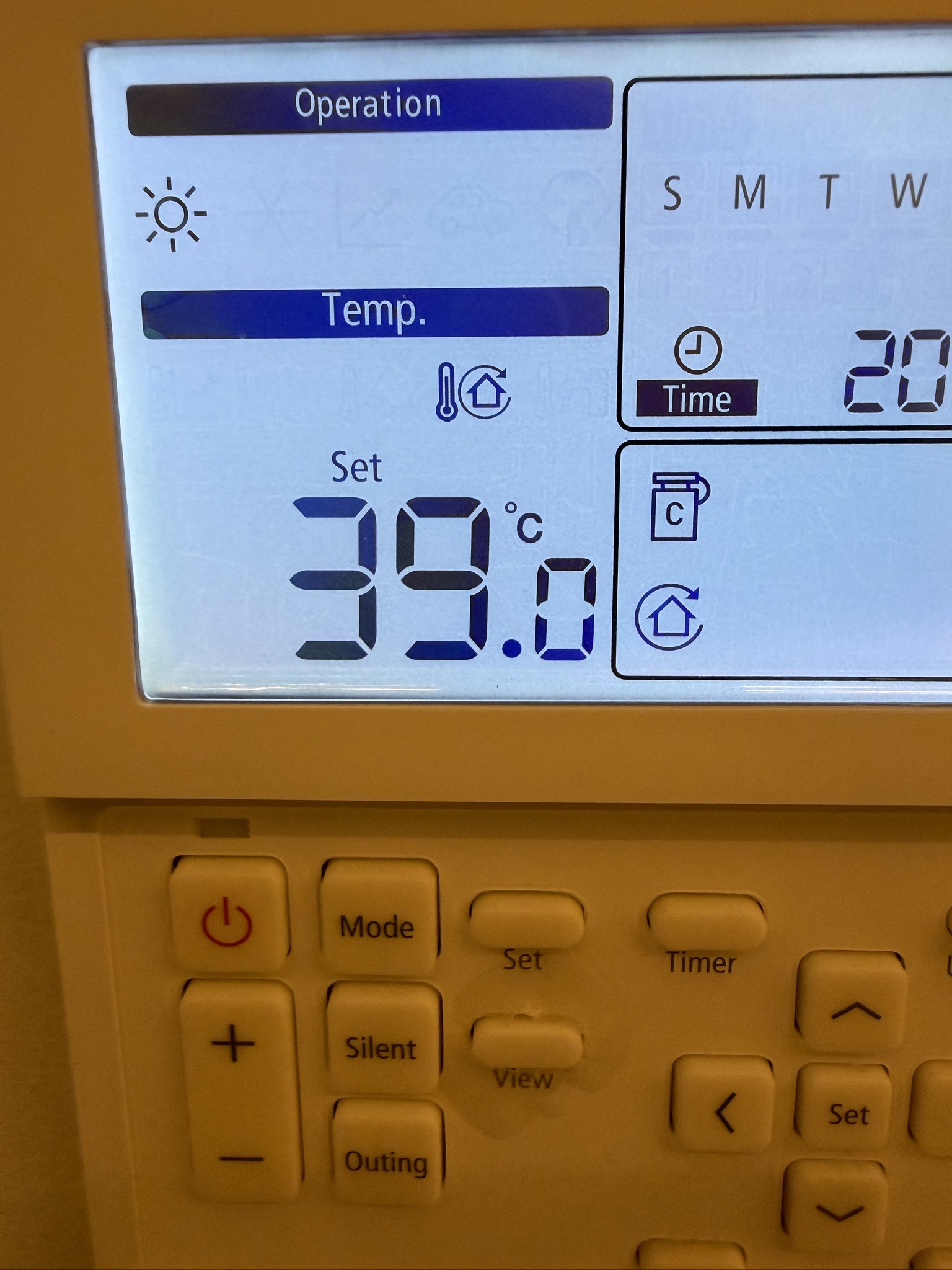

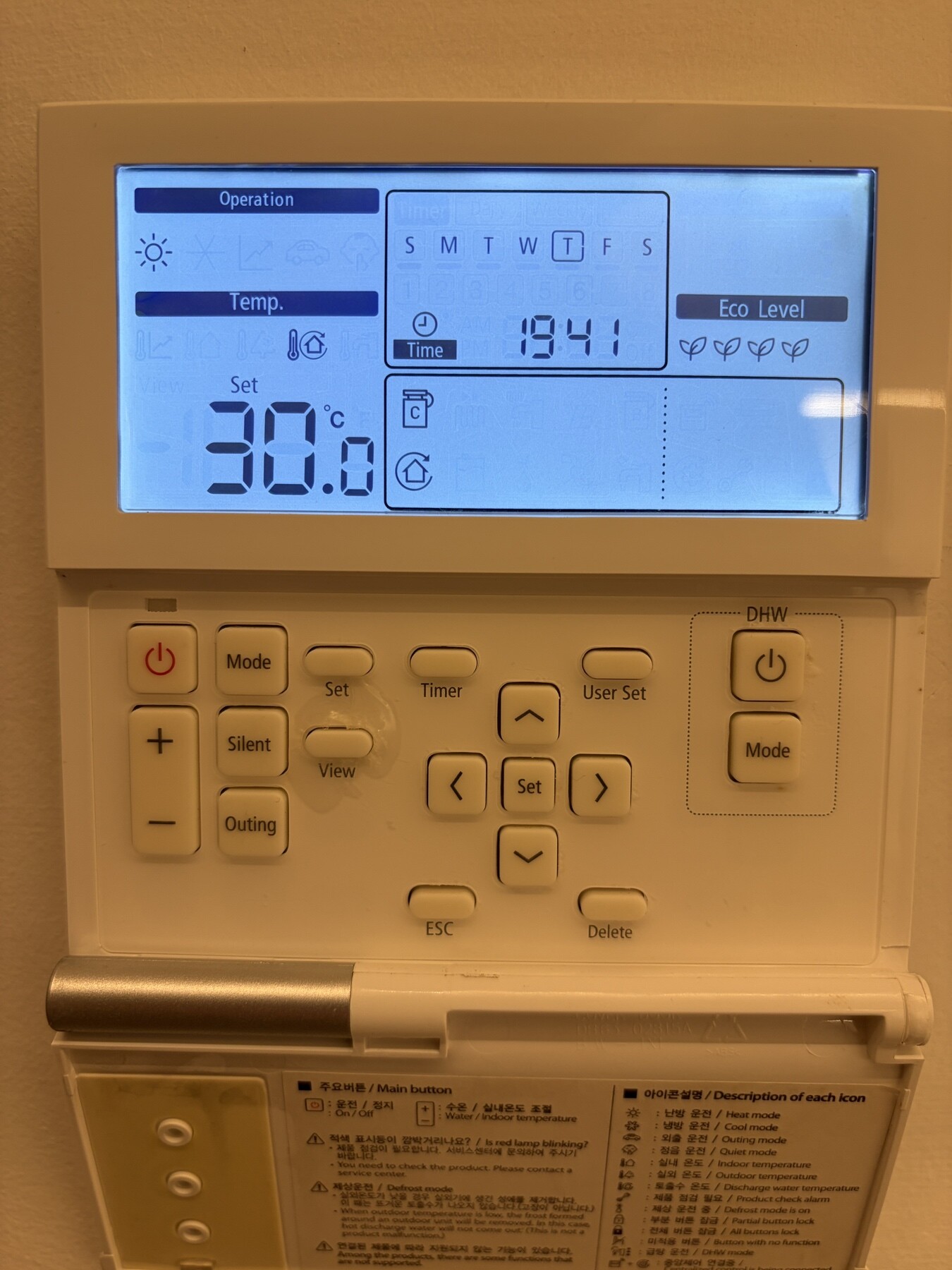

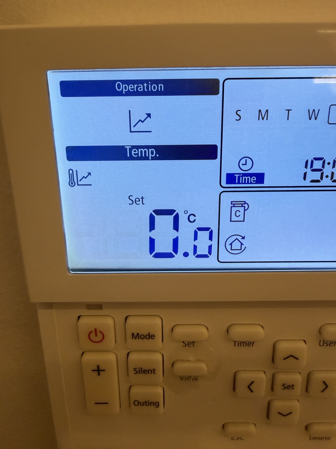

( A ) I have set in the wired Samsung thermostat 30c assuming that is now the target temp 30c but what I did not understand, this value overrides the H1 & H2 of the 2021 OR 2022 ?
(B ) Changing the mode to shift up down the target temp by -5 / + 5 this setting overrides the previous mode ? leaving the value to 0.0 what is the target temp ? 39c based on 2021 setting? - see the attached diagram photo.
I’m a bit confused which of the 2 to use A or B
At this stage I’m doing my tests without changing the third party thermostat schedule only by interrupting the point A temp. What I see is now the Heatpump uses the inverter than before, it was running all time full power consuming over the years a lot of energy. In the cold days with estimated 8-10 hours running consumed sometimes 45khw. Please not that I have solar system with Primary Smartmeter and for all the house monitoring the consumption and Secondary smart meter only for the three phase Heatpump which I can monitor the Amps voltage etc.

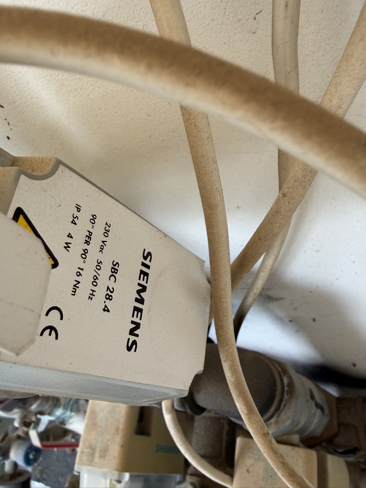

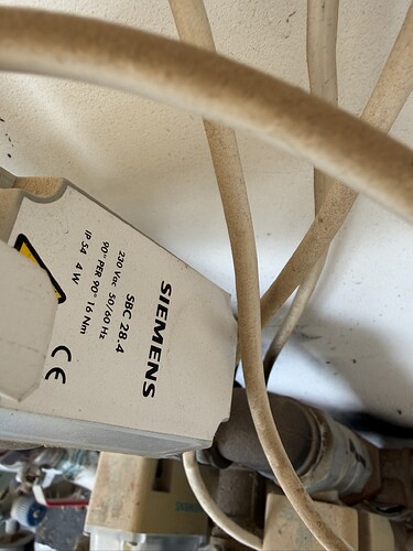

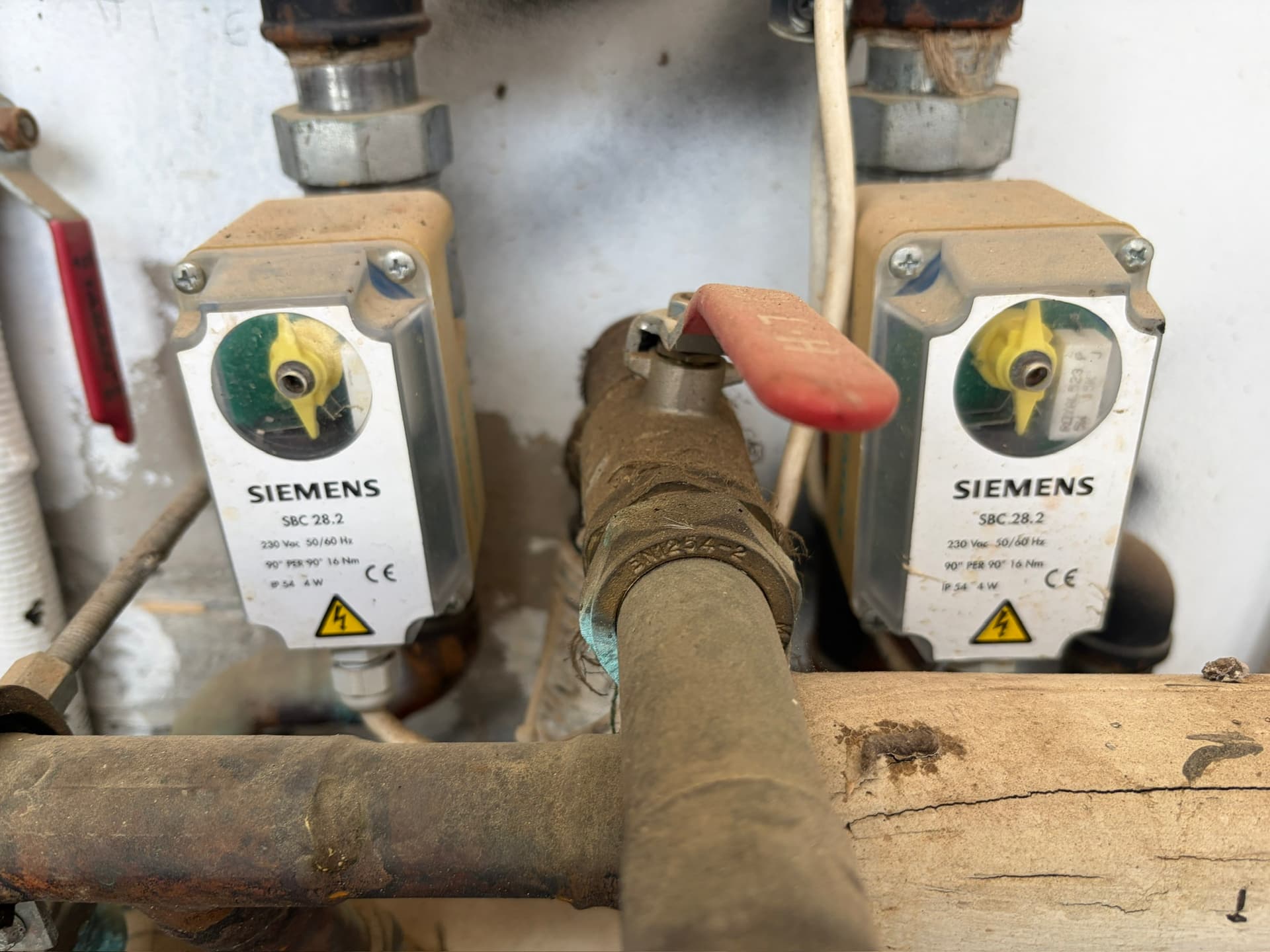

Going to the technical part I found out that when I enabled the 2091 setting always one of the Valves(Siemens) must be opened to circulate the water to keep it to the target temp, which is logic. How can I change the setting to keep both Valves always open and not only the one; because if the one of the circuit closed then the water loose temp until the next schedule point of the third party thermostat trigger the valve to open to heat based on target set point.

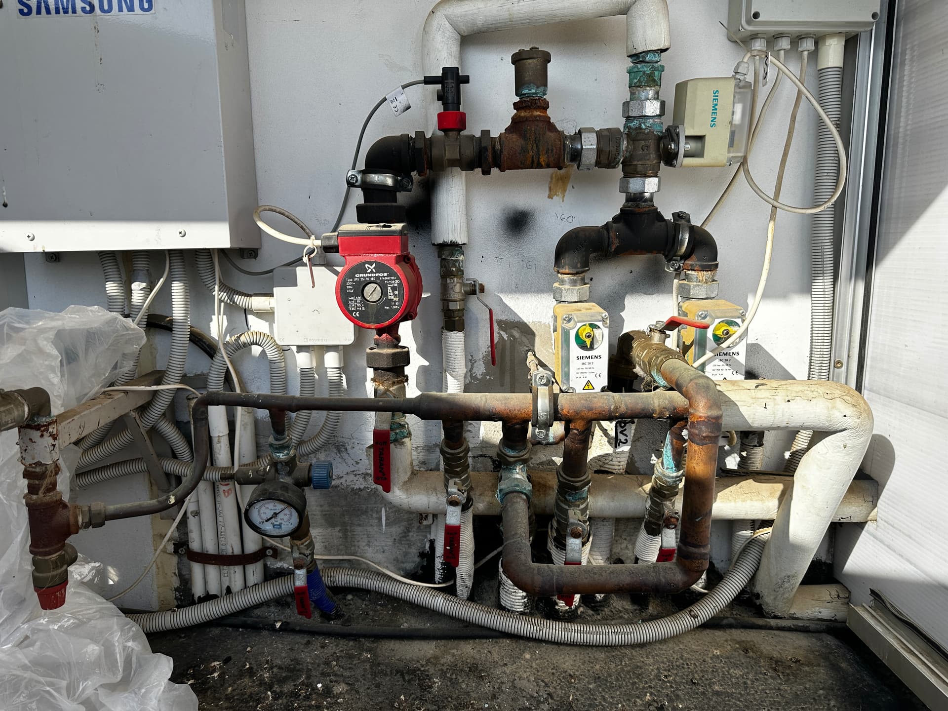

The rest photos that I was not able to upload as new user limit to 3 uploads
Diagramm
HeatPump Pipes
Hello @HeatpumpCy and a warm welcome to the forum.

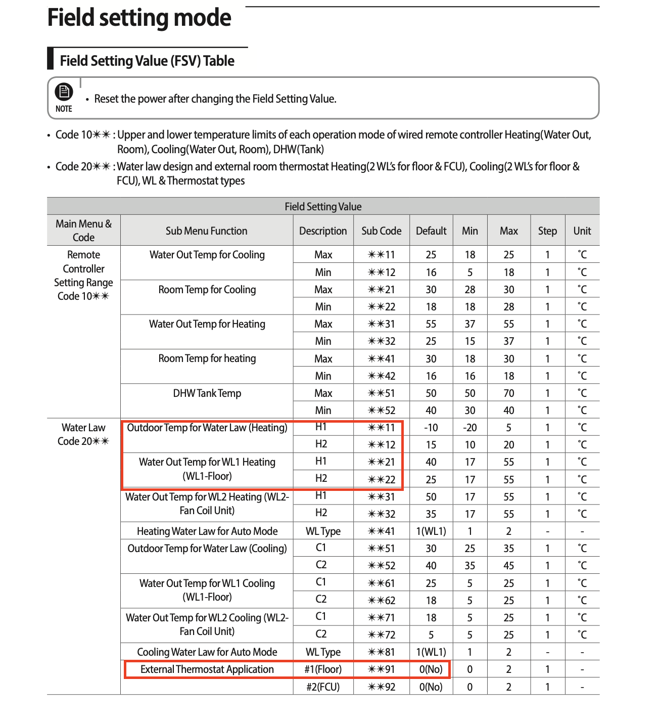

  1. If you set either #2091 or #2092 to something other than zero, any setting on #2093 (which sets the roomstat in the Samsung Wired Remote Controller - WRC) will be ignored, and only your selected remote roomstat (your Nest) will be used for Water Law (weather compensation). So in your point (A) it doesn’t matter what you set the WRC to.
  2. You have marked your #2011/2/21/2 settings correctly on your photo. This is your target LWT for any given ambient temperature, and the heat pump will try to achieve this using its own internal control algorithms. The lower this target, the lower will be your power consumption.
  3. Your WRC gives you the provision - using the +5/-5 function - to move this target up or down a little (i.e. the graph in your photo moves vertically up or down by up to 5degC). You might find this useful to temporarily change your LWT if, say, you find that you need a boost to emitter temperatures if you find that a strong wind blowing from a particular direction increases your house heat loss. This avoids the need to reprogramme your FSVs every time.
  4. 45kWh/day is a lot for a house in Cyprus, even a large one, and you are right to expect something lower.
  5. Can you clarify your description of your valving arrangement (e.g. a sketch)? When you say 2 Siemens valves are you referring to DHW and space heating or something else? Normally, the heat pump feeds either DHW or emitters, not both simultaneously.

  1. I don’t have the option #2093, this applies to a newer SAM WRC? My NEST don’t apply whether compensation just on/off. (UK Version )
  2. To make it more clear, the +5/-5 function interfere with the FSV 2021 & 2022 predefined settings which are currently 39 & 36 right ? – based on photo I provided before
  3. Yes too much consumption, unacceptable!!! I manage yesterday to keep the consumption to 23khw setting the Set temp to 30c but the house dropped in 24h 1C. To accomplish 22c indoor I changed the Set temp to 35C, and consumed 27khw in 8 hours. Right now I moved it to 40C to see how it will go and I will see tomorrow if is more efficient.
  4. I’m not clear what is space heating yet. My house has 2 zones. Upstairs and Downstairs + the 3 way valve that goes to DHW(boiler, not samsung). I can heat each floor independently with different temps using the on/off thermostats (left Siemens Downstairs, Right Upstairs )
3way for boiler/DHW
When my heat pump heat the DHW 3way open but Upstair valve/siemens close. Downstairs keeps running normal. When the WRC/Timer finish the heating of the hot water(boiler), Upstairs Siemens automatically open to continue to heat.I have separate manifolds for each floor.
I’ve notice that Discharge Water set temp is reached after some time but when the Heatpump stop heating because achieve the set target then the temperature from 39c drops to 36c and then start heating again, inverter works 1200watt - 1800 watt 2300 watt etc base how close is the set target.
What cause the water to drop so much ? is that normal ?
Set temp 39c revised from 40c as per my previous posts
From 39 drops to 36-38 very fast (View mode )
