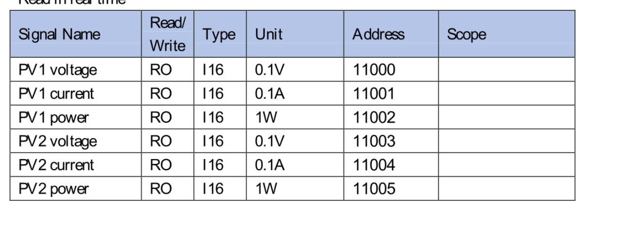

However I don’t understand the registers or names. I assume names map directly to registers.
A screenshot from the manual
Should my config look like this? (for example)
                    registers = 11000, 6, 11001
                    names = pv1Voltage, pv1current
The registers are likely to be either 0,1,2,3 etc or 1,2,3,4.
Number of registers and names in each array must match.
Register 1 is at address xxx0 (offset by one) which can be confusing.
You need to be sure about the address as well.

Looking at this HA code, it shows some correct addresses such as 31001
So we could be down to trying to understand the register number / register address. I didn’t appreciate there was a difference between the two.
This doc confirms the register references - Data Register Reference H1 AC1 · StealthChesnut/HA-FoxESS-Modbus Wiki · GitHub
I don’t understand if the module is looking for a register number / address and if the reference above is a number or address.

Why are you picking that number? Do you have a source document? sorry missed the link. - these look like addresses rather than register numbers.
Also, your successful test in message Some help with Fox Solar Inverter and Modbus - #7 by kb6673 you used TCP and starting 11000 address.

Looking at my line datacodes = f,which the docs refer to as “f: float, 4 bytes”
This screenshot suggests the data type is int16
Are data codes and data types the same thing? If so, any suggestions on what I should set for int16?
Almost - I’d say ‘h’ is the datacode for the data type of a 2-byte, 16-bit signed integer. There’s a full list in here:
Watch how the negative numbers are coded. I think this is hardcoded in the interfacer as @glyn.hudson was having issues with a particular device previously.
Tried using h The number is never negative, so I don’t think I need to worry about that

That will multiply whatever came in by zero, result: zero. Putting zeros there is nonsense, the sensible values are 1.0, then at least you’ll see the raw value interpreted as a signed 16-bit integer.
