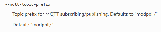

For MQTT
Add a trailing /

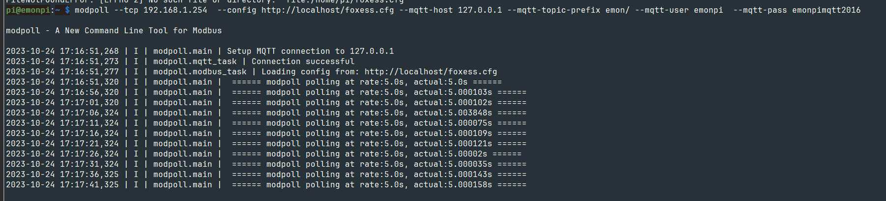

Nevermind, I put the file in the emomcms web root and got past that error.
modpoll --tcp 192.168.1.254 --config http://localhost/foxess.cfg --mqtt-host 127.0.0.1 --mqtt-topic-prefix emon/ --mqtt-user emonpi --mqtt-pass emonpimqtt2016
Nothing appears in MQTT (Watching it with MQTT Explorer)
I’ll keep trying.
