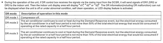

As a side note, they do something similar here with air-conditioners but the signalling is message based from the provider rather than inferred from the line frequency like you’re trying to do. Here’s an example:
They promise to only use mode 1 in an emergency, the other modes are said to be unnoticeable by the consumer.
You can see the frequency change as consumers put load on and take load off (relatively slow changes), and the grid controller responds by bringing additional capacity on-line or taking it off (relatively fast changes). As I understand it, the aim is to keep it within 0.2 Hz (the legal requirement is 1%) and with the same number of cycles per day, so that clocks that count cycles can lose or gain over the course of a day, but don’t exhibit a long-term drift.
