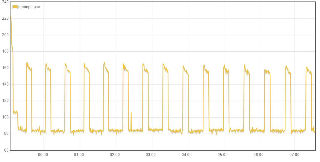

Interesting reading all this. My fridge-freezer consumption and when it operates has always been something I’d have liked to improve.
It does this. Runs for approximately 12 minutes every 40 minutes. Day in, and day out, doesn’t seem to change more than a minute or two on the time the compressor runs.
I did think about fitting a smart switch (shelly with power monitoring) to see if I could do a better job and reduce electricity consumption a bit.
However, I thought to myself. There’s been a group of hopefully qualified engineers who have gone through a design for this, so whatever I do will more than likely just cost me money, damage something and just be an interesting mental exercise.
