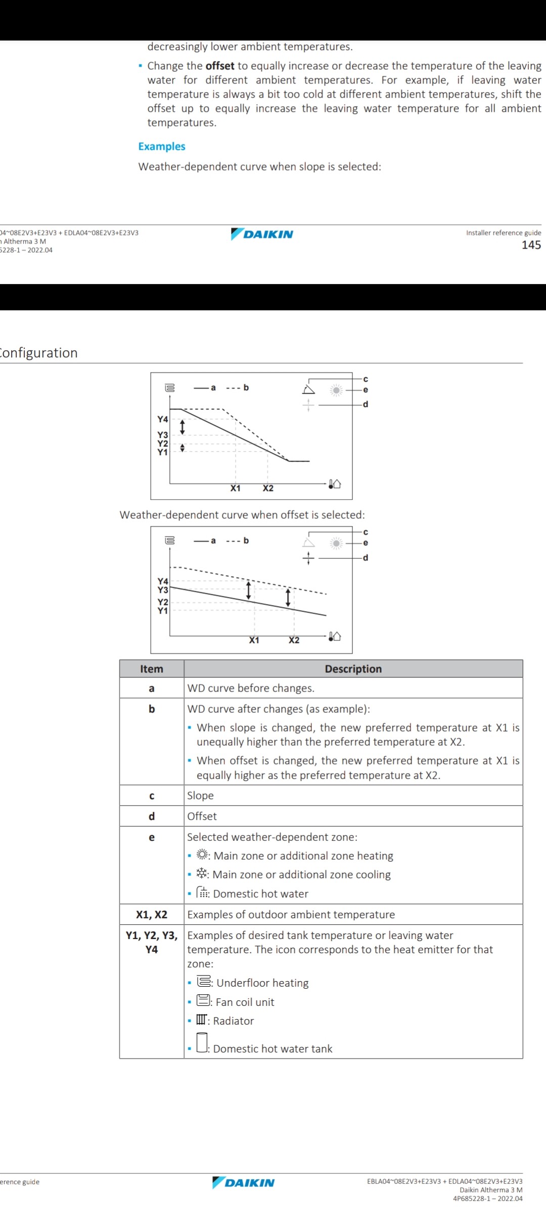

Hi I have a Daikin Altherma installed yesterday by Octopus. Attached is an image of the WD heating curve from the Daikin MMI. I remember receiving a copy of the survey with the design temperature at 50 degrees C when the external temp was 3.4 degrees.
Therefore I think I WD heating curve in the image will need adjusting to 3 degrees?

It depends on your hardware @Harj (HP and emitter rating etc). Your profile doesn’t say where you are located, but if in UK, Octopus have set you up with some fairly realistic initial WC settings.
I’d be inclined to leave these as they are for now, and see whether your HP keeps your house warm enough as winter sets in. If it does, then you can maybe drop your WC settings a little.
If you want to adjust this to suit your house here are the two images from the installer reference guide that will tell you what to change (little changes and wait for a day to see how it feels).
Make a note of the current settings first so you can swap back if it goes wrong.

Hi the issue is that the installer has the weather curve at 50 degrees at minus 8 ambient, whereas the design was at 50 degrees c at minus 3.4 degrees.
So the design temperature has not been set by the installer.
The unit is a 11 kwh Daikin Altherma with a heat loss of 9.1kwh and I’m based in the West Midlands.
Surely I need to change the settings in the image of I have provided of the MMI?
