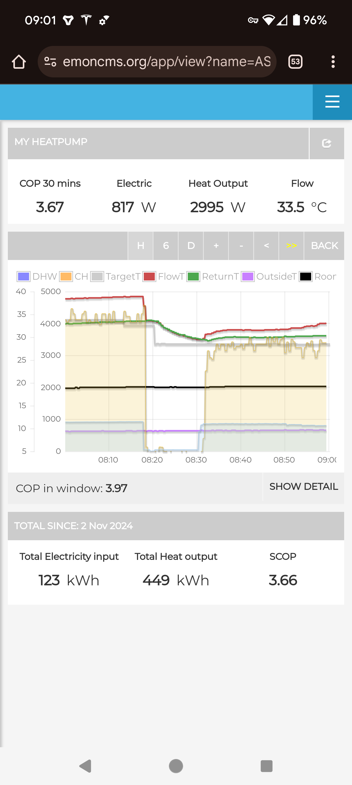

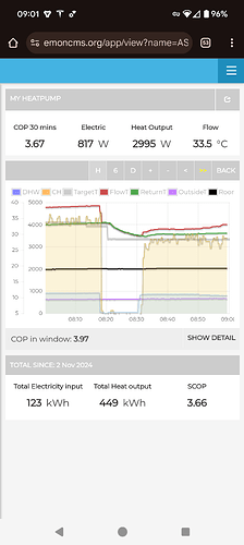

Am very new here and still figuring things out and have had to reconfigure my feeds recently.
Have just swapped from a lower flow of 30 back to a low of 25 and will try and capture some data.
At 30 it’s clearly producing more heat, with a higher difference between flow and return, which I guess gives me the better cop.
I’ll try and capture the behaviour but with the big temp drops on the way I’m not sure how it’s going to perform.
