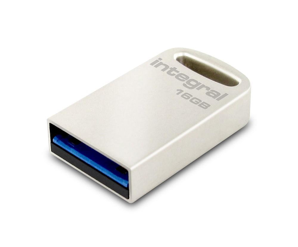

Any solution will add cost and, as an example, My Memory have a 16 GB USB 3.0 10 MB/s WRITE flash drive for £8 (but not currently in stock).
There are existing emon scripts for backup export and import. Would it be difficult to get emon to recognise when a flash drive is plugged in, to mount it and then to do a backup at regular intervals? This would give the user Plug-n-Play choice.
