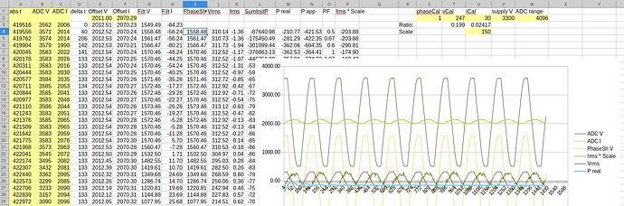

As for the screenshots etc, it will take me a while to work out what’s going on. Try redrawing the diagram I gave you above to scale, then you’ll get a better idea of what you need to do.
[Edit]
Having had little more than a quick glance at your spreadsheet picture, it didn’t make sense. I’ve looked a bit more closely now, and it still doesn’t make sense.
In post no.9, you say a 600 W toaster and “a small load”. I think there has to be something you’ve forgotten, because your current is shifted around 55° from the voltage, implying a power factor of 0.57 (and post no.11 is essentially the same, but “only” about 30°). There’s no possible way this could be the difference in the phase errors of the transformers. The current is leading the voltage, I think there’s a substantial capacitive load somewhere that you’re measuring - appliances on standby with just time clocks running, for example?
Where are you in the world (it’s not in your profile, and I don’t know of a country where the supply is ~180 V), and what are you using for the voltage transformer supplying the V to calcVI( )?
In post no.10, I can see exactly why you think you’re generating 20 W overnight -the current wave has shifted almost completely into phase opposition to the voltage.
I’m assuming you have the SCT-013-000 on the supply incomer to your house, and I think this is confusing things. I think until you have everything calibrated correctly, you need to move it to a test coil using your 600 W toaster as a load. If you’re on a 120 V system, that’s 5 A, so a coil of 10 turns (of 0.75 mm² copper minimum) would give you a test current of 50A. If you’re on a 240 V supply, the current is exactly half of that so you’d need 20 turns to show as 50 A. If you do this, only pass the current intermittently, and keep a careful watch on the temperature of the coil where the wires are bundled together. Stop and let it cool if it gets noticeably warm.
What you’re really interested in the difference between the phase errors of the two transformers, and knowing which direction it is. It’s a reasonably safe bet that both are leading, i.e. the output wave appears to be ahead of the input wave that creates it, and I’d hope and expect that the v.t. has a phase error not more than a few degrees, in other words, barely noticeable on a 'scope.

Furthermore I created a “simulator” - basically a spreadsheet I feed with the ADC samples (plus initial offsets and vCal etc) with the almost same math as in EmonLib:
Actually I was expecting that changing phaseCal moves the phaseShV and Vrms curves but it does not significantly …

It’s most important to know this. I had been assuming - as this is a UK website and there was no other indication - that you were in the UK and had the standard 240 V single phase domestic UK supply. Now that I know you have a 3-phase 230 V supply, this changes many things.
Will you update your profile, please?
You must monitor voltage and current for the same phase. If you don’t, there will be a 120° approximately phase shift between voltage and current, and you won’t read the correct power. With a pure resistive load (your toaster) and a 120° phase shift you should read exactly half the correct power and with the wrong sign (negative/generating rather than positive/consuming).
Note, if your voltage is monitored line-line and the current is in a d phase-neutral load, or vice-versa, you’ll have a 30° phase shift between voltage and current - which is close to what we’re seeing on your spreadsheet. Could this be a possibility?

I hope we are getting there … had the following thoughts:
  • we don’t need to care about what’s inside the washing machine etc - that’s the way it is and also what the meter in the basement will see
  • we have to compensate errors introduced by the “measurement framework” (CT+VT and the home-made adapters - of course assuming everything is connected correctly)
  • took me a while but now I was able to grasp what you suggested in post 8. In my spreadsheet I modified the formula which calculates “sumInstP” (in EmonLib lines 129-135) to not use “filteredI” of the same pair of samples but rather as of 26 samples in the past. The number 26 comes from the two I and V samples which are closest to zero:
(hope it’s readable … once we are done with all this I’ll be happy to share the sheet) - which is row 44 for V and row 18 for I. I can enter that “offset” into cell S3 and play with it, but actually don’t need to:
I doublechecked the toaster with some basic energy-meter, it even draws ~688W (on the label it says 750 :-)) with a PF=1. And voila, as visible in the curve, P is in around 700-720.
I did not alter the resulting curves for Irms and Vrms, so the graph still shows them misaligned.
I still suspect the VT, but ultimatively it does not matter … if all of that is right, that might be a valuable outcome: The calibration procedure might become much easier:
  1. plug everything together and let it run + record a set of samples
  2. load them into the spreadsheet and tune the calibration values
I will modify the EmonLib code correspondingly, let’s see …
