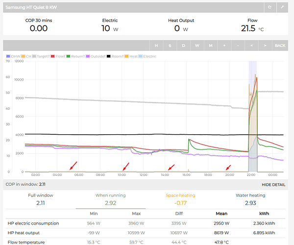

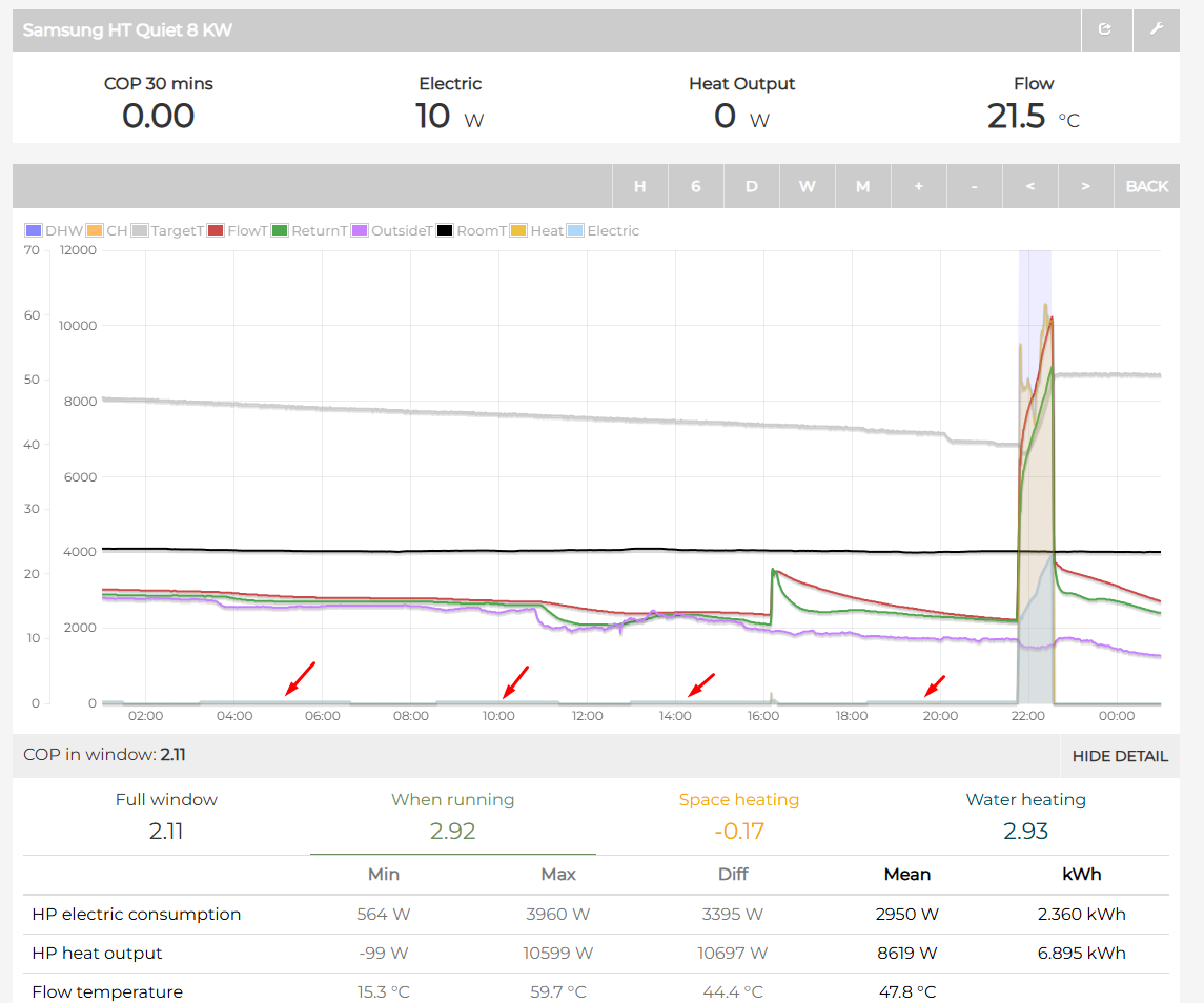

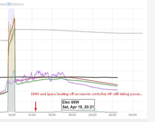

Hi,
I’ve found one unpleasant feature of this heat pump. This is information which might be interesting for people without DHW heating - TURN OFF physically your pump outside winter season when you don’t need to heat the house because this pump is consuming ~1kWh/day electricity in idle.
Here’s my chart. You can see that every couple of hours the pump is idle, the pump powers some internal heating elements to keep oil level on temp - or something like that but it’s around 50W. It’s interesting to see that it is doing even there is +20C outside. I thought it was needed only for lower temperatures but nope, it’s all the time.
So because of this behavior the pump effectively lowers the daily COP almost by 1. Water heating I had almost 3 and because of this I’ve finished the day near 2. Also you can see once the pump run the circulation pump for some reason at 16 o’clock. That’s sad to watch. So if you heat let’s say 6 months in a year then you are idle for another 6 months and if the pump is not turned off by hardware switch (this I need to confirm if it consumes this power also in case both DHW and space heating are off) then you will waste 180kWh of electricity yearly for nothing…
There is a chance if both DHW and space heating is turned off then maybe it won’t take this extra power for internal heating of outdoor unit components but this must be checked. I’m doing it right now so I will update later…
UPDATE:
So HP is consuming power even if both DHW and space heating is turned off so definitely those who does not use DHW heating turn off the pump by circuit breaker outside winter!

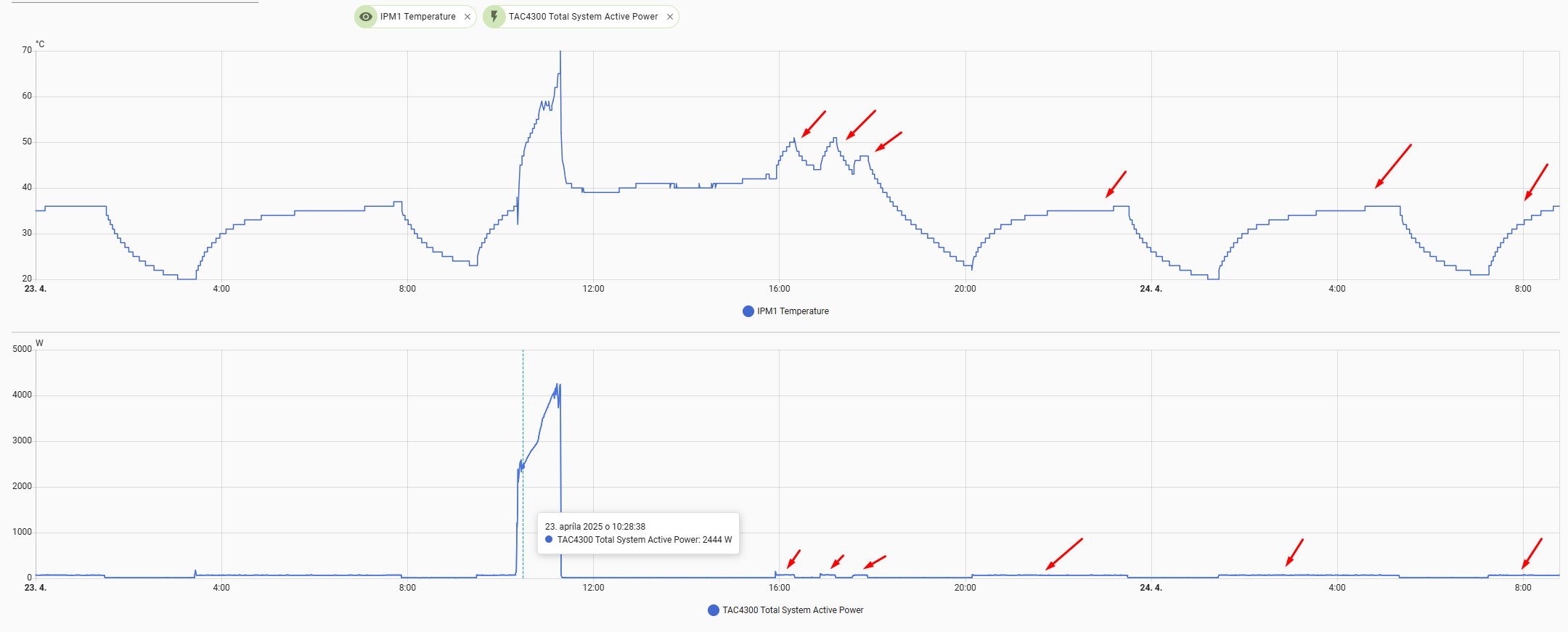

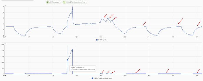

That’s very interesting but is it not the compressor crankcase heater that all modern heat pumps have? It may modulate its wattage at higher ambients over time.
Refrigerant naturally migrates to the coldest location on a system, which is the compressor when the temperature is cold and the system isn’t running. If you start a cold compressor full of refrigerant, the oil will turn to foam and lose lubricating properties.
If you turn it off at the isolator and not use the heat pump outside the heating season then maybe it will be OK but the humidity and temperatures changes like we get in the UK season will risk deterioration of circuit boards etc. In any case you would need to remember to have the unit powered for 24 hours before the first operation of the compressor to avoid foaming and premature wear.
I have been advised to always leave the heat pump and controller powered during the summer season but I am fortunate to have plenty of excess stored solar power to use. What do others do?
Hi Stuart.
I think this is exactly this what you have described. I’ve noticed that during time the consumption is higher the IPM1 Temperature is raising as well. I guess it’s internal heating of compressor oil to the temperature.

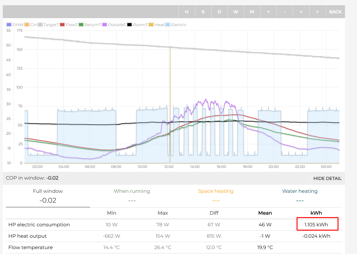

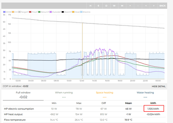

This is a day where pump was completely standby for the whole day. No DHW or space heating. It has consumed around 1kWh of electricity. 265W is normal standby consumption so it means it took 735W for oil heating.
Yeah, it’s not that bad at the end but anyway users who does not have DHW this is useless consumption outside of winter season. I swear I saw R290 pump not doing this so probably it is specific only to R32 version.
I agree to this, honestly last winter I’ve turned it on just after switching isolator so most people are not aware of this. Seems no harm done but one never knows. I would think the pump has algorithm to heat oil first before it starts compressor but not sure.
