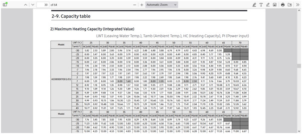

  • I’m pretty confident that Samsungs (at least HTQs) will achieve at least nameplate heat duty over the full operating window. A quick glance at the (8kW HTQ) published window…
…shows that Samsung expect at least 8kW at all LWTs and ambient temperatures (apart from below -25degC). Why am I confident? Well 1) the same compressor is used in all HTQ units (8/12/14kW) so at the smaller end there is plenty of spare capacity under the bonnet, and 2) my measurements strongly suggest that this table applies just at synchronous compressor inverter frequency (50Hz), whereas in reality the inverter is quite capable of over 55Hz if the controller requests it – I have often observed heat duties well over 10kW on my 8kW unit, including on cold days – see example below.

  • I can answer your question about heat output on cold days with a good recent example (10/01/25, when ambient was -5degC min overnight, 0degC max daytime, fairly high humidity – that’s about as bad as it gets, here in balmy Wiltshire). The maximum HTQ output I recorded was 10.6kW when ambient was -2degC, LWT was 47degC, inverter frequency 51Hz, Outdoor Unit power consumption approx 2.7kW). At these temperatures, the Capacity Table above shows 8.0kW duty, 2.8kW energy required, so I seem to have beaten that by some margin. My total household electrical consumption that day (and that’s including electric cooking, appliances, lighting etc., and a defrost cycle – something I rarely see on the HTQ thanks to its economiser circuit) was 34.2kWh – about £7 at my standard tariff. If that’s the worst day of the year, then that’s something I can live with. (It also suggests that it would be difficult to justify much in the way of @glyn.hudson 's OEM kit…)
