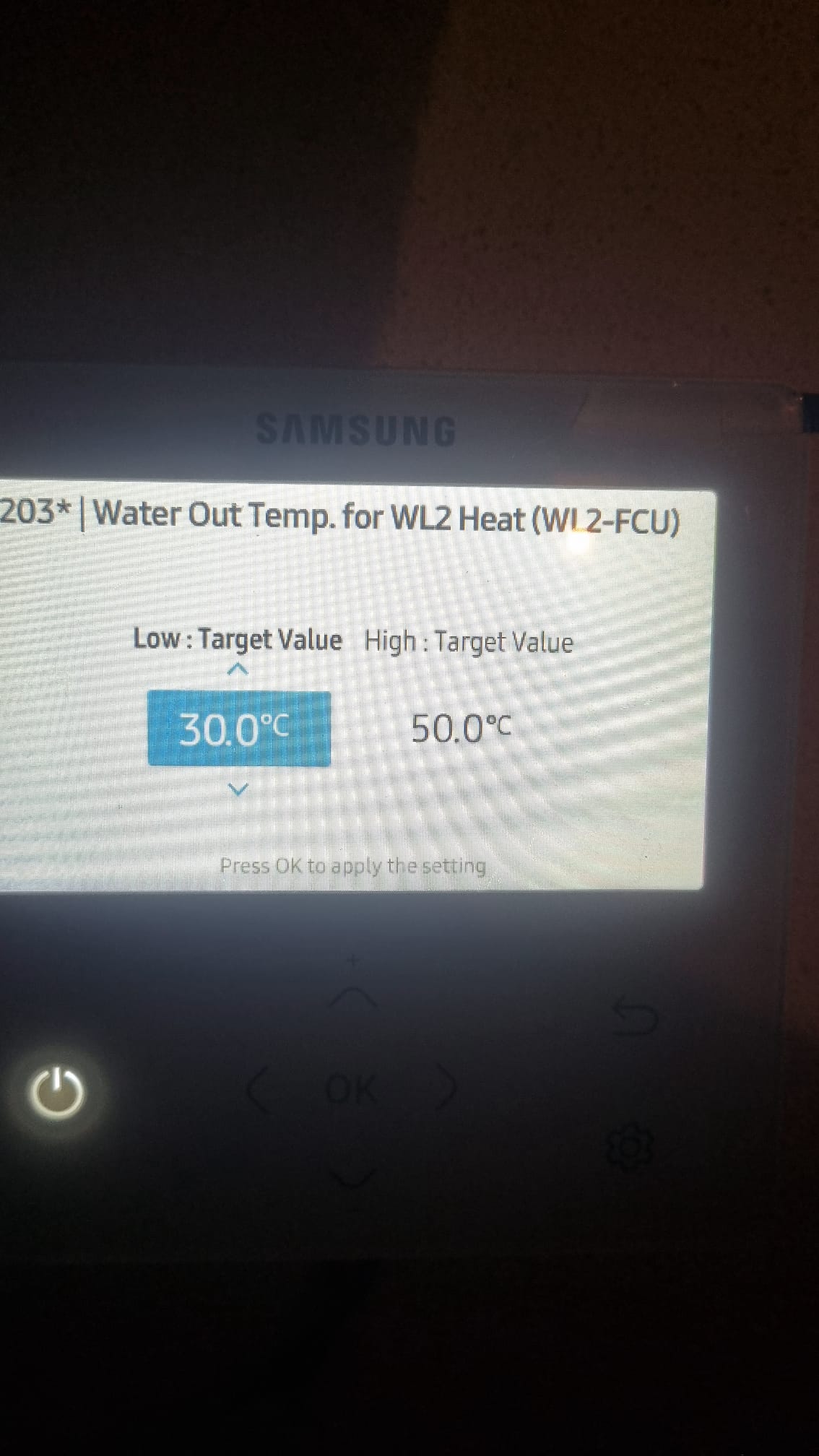

I cant’ seem to get the water law to work correctly,
I have 50degres for -5 outside and but even if the temperature are going down the water temperature does not increase … Are there any other settings ? Cheers.

Possibly. Can you post a list of your FSV settings #2011/2, #2021/2, #2031/2, #2041, #2091/2/3?

Hmm those look OK.
What is your current LWT at your current ambient temperature?
The WL you have set up is LWT(degC) = 45 - Ambient(degC). Does your LWT roughly correspond?
I am afraid not, at -1C outside o have 41 LWT, maybe is not linear ?

The WL figure is a target figure, not the actual, so at the time of reading your LWT may have been still heating up towards the target. (Wait half an hour to see if it’s still rather low…) It is linear BTW (at least on my HTQ controller).
The external temperature is visible on the remote display (the one split into “Zone” and “DHW”) - small numbers, top left corner, above “Zone”.
WL is dispayed on my Samsung Smart Thinks, and on display, it did not increase significantly, i’ll check the outside temp sensor.

I’ve heard reports that it (the outdoor sensor) isn’t necessarily accurate (e.g. somewahat susceptible to cold-air recirculation, effect of rain etc.), but that shouldn’t affect its control of LWT - if it thinks ambient is -1degC (even if it’s not) it should try to get your LWT to 46degC (with your WL settings). Something else must be going on here…
(To exclude the obvious) is it possible that your roomstat setpoint has been reached so it quits heating before your WL target temperature is satisfied?
Thermstat is disabled, still the room temperature is bellow thermstat set point. No external temperature here

Go back a screen (the reversing arrow) and you should see it.
Yap, you are right. It seems that the waterlaw is working but it takes a while to react. Thank you .
