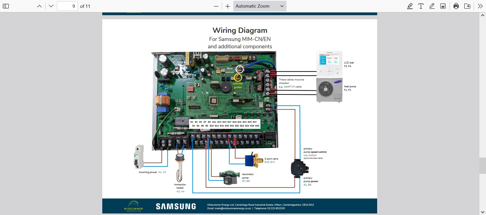

Sorry @VIERICIU_COSMIN I can’t help you there (I don’t use PWM myself).
All I have is this diagram, which I assume is what you are using.
Are your pump signal cables not colour coded per the diagram?
If you are stuck, you can try emailing the Samsung UK Helpline at [email protected] .

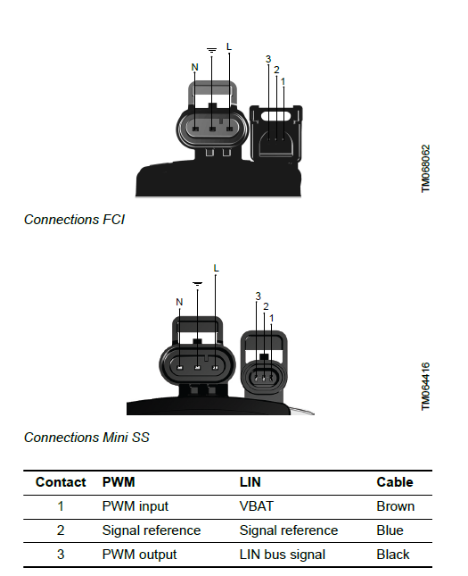

No, is a WITA pump which has other color, Red, Black, Yellow.

Yeah, i saw that but hopefully it’s not the PCB in my case. I’ll try tomorrow with another pump, finger crossed. So just to be 100% sure , it’s ground on top, and signal bottom
