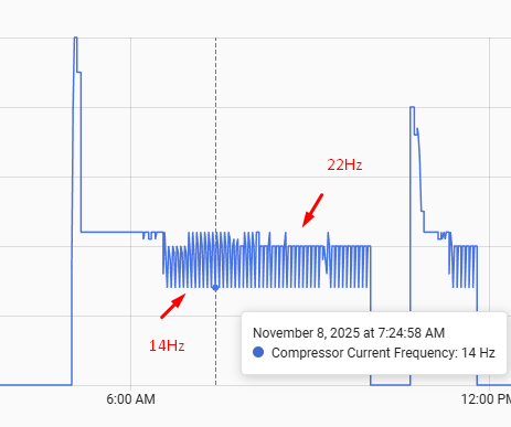

Hi all, do you know if it is somehow possible to set minimum compressor frequency via modbus or somehow ? With frequency ratio control I can limit maximum compressor frequency but I would need limit minimum. Can’t believe it’s not possible somehow.
Thing is when my target flow temp is reached and compressor is running at minimum rationale frequency of 20Hz (stable input around 1kW, still acceptable efficiency) then if it can’t hold the target anymore it slows down dramatically to 14Hz for a minute then back to 20Hz all round again. It’s very inefficient and annoying.
I would rather want that compressor stays at 20Hz and don’t drop lower and simply overshoot the target temperature in case target can’t be maintained, I don’t care. Thermostat will turn it off when the target room temp is achieved. This is much more efficient that hold the compressor on for prolonged period of time at such low speed.

For reference a chart…

I don’t know how exactly it works because I’ve noticed it starts higher. Like 50Hz then decreasing to 22Hz and holds it there. But DHW is heating with 30Hz so not sure how it should behave. Definitely it ramps up slower but I guess it can run above 22Hz if there is a need or not ?
Yes but it goes down as soon as the target flow temp can’t be maintained anymore at given frequency so it drops to 14Hz usually which is huge step. Doing this the efficiency sucks. At least for me. PID is controlling this erratically but maybe it’s because of my low water volume in the system so thermal inertia is small. I would rather keep it running at 20Hz and simply let it overshoot the target temperature. But seems anything I will do in my system is not ideal. Ideal would be to switch to T22 radiators and add a small buffer but I guess it’s not worth the price. But at least I could add 50L buffer tank to help with thermal inertia so PID shouldn’t react so dramatically. But’s it’s just theory, don’t’ know if it would help.

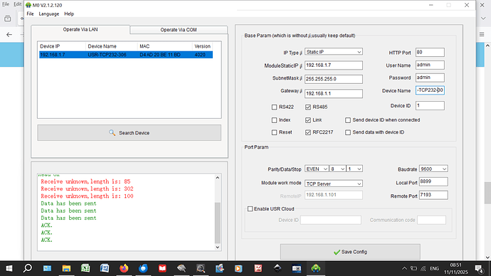

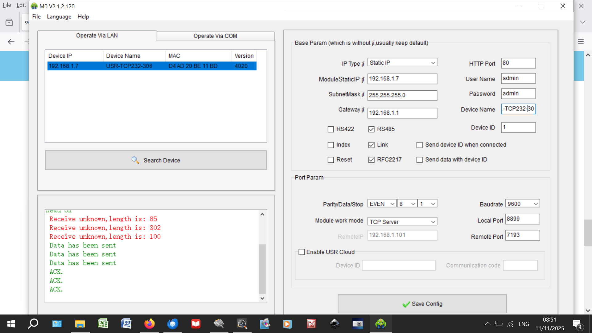

If you’re interested in the RS485-to-Ethernet route, I’d recommend the USR-TCP232-306 over the Waveshare alternative. It costs a bit more, but my Waveshare packed up after a few weeks.
The only tricky bit of setup is configuring the adapter, or more specifically setting up the IP address. This particular adapter (the USR) comes with a default IP of 192.168.0.7. If your broadband router has an IP of (say) 192.168.1.nnn you’ll need to change the third octet of the adapter to a “1” to match that of the router (or else change the subnet mask as described near the end of the Monitoring Your Samsung ASHP Controller thread, though this should be unnecessary unless you have tons of devices connected to your router).
In my case I had no device with the address 192.168.1.7, so all I needed to do was change the 3rd octet. Here are my adapter configuration settings:
If you replicate these settings exactly you’re half way there, but make a note of the Local Port address (you can set this to almost any number, but those below 1024 are reserved by some devices and you may get a conflict).
When you come to set up your VCOM, you’ll need to assign its Remote Port to be the same as the adapter Local Port, so that you get a screen like this:

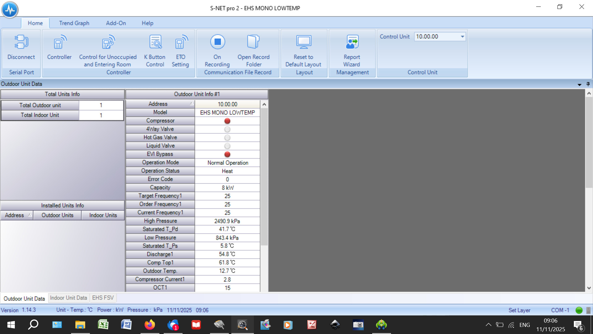

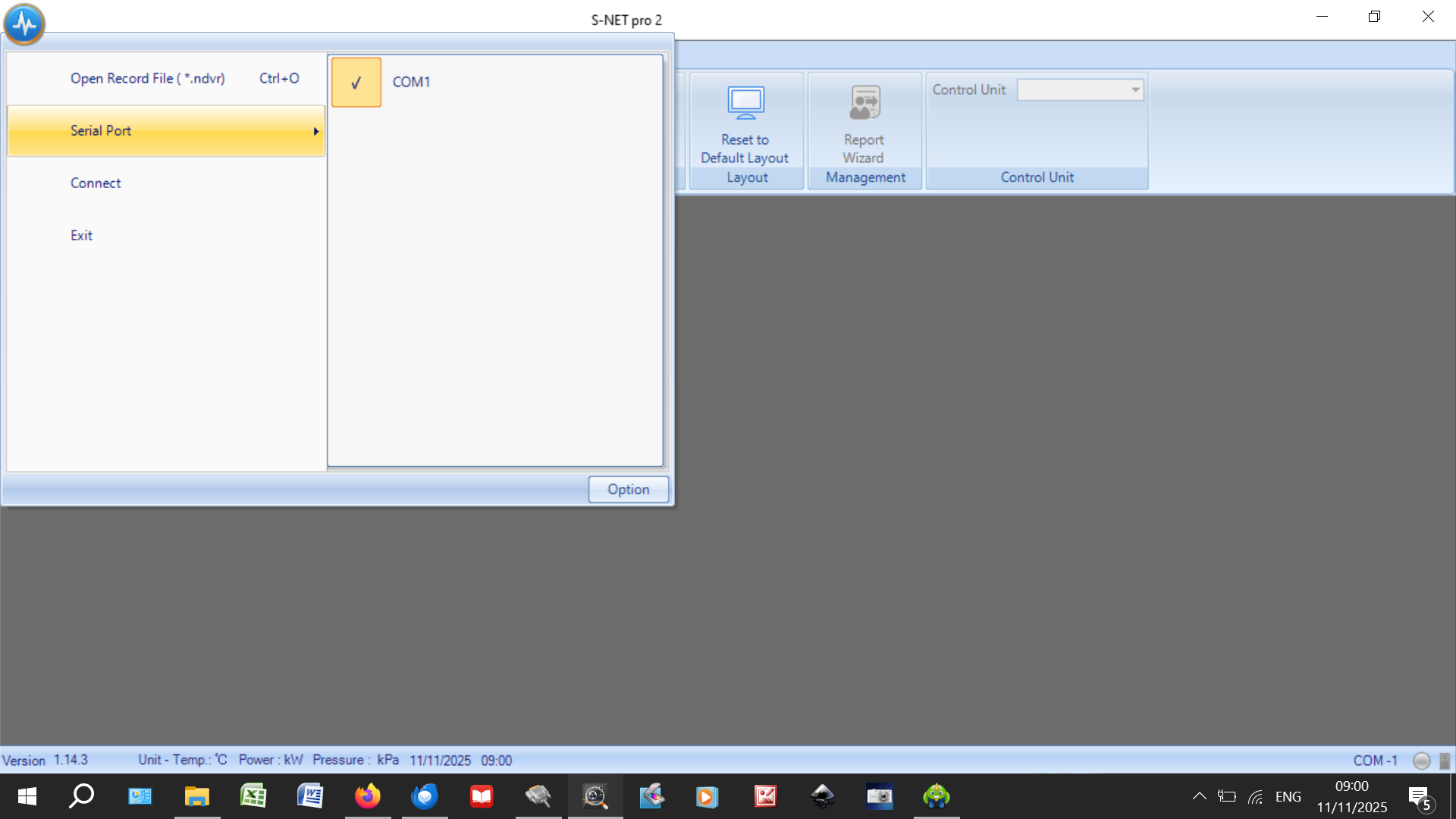

Now all you need to do is download SNET-Pro2 and fire it up. Hit the blue Settings button (top left of screen) make sure you have COM1 selected (or whatever COM number you chose in the VCOM settings), like this…
…and then hit Connect, followed by the Set Layer (F1/F2) button. After a couple of seconds you should see something like this (the heading at the top will vary according to which heat pump model you have):
And now you’re in business. You can see (amongst other data) the compressor frequency half way down the above screenshot (25Hz at the moment I snapped it).

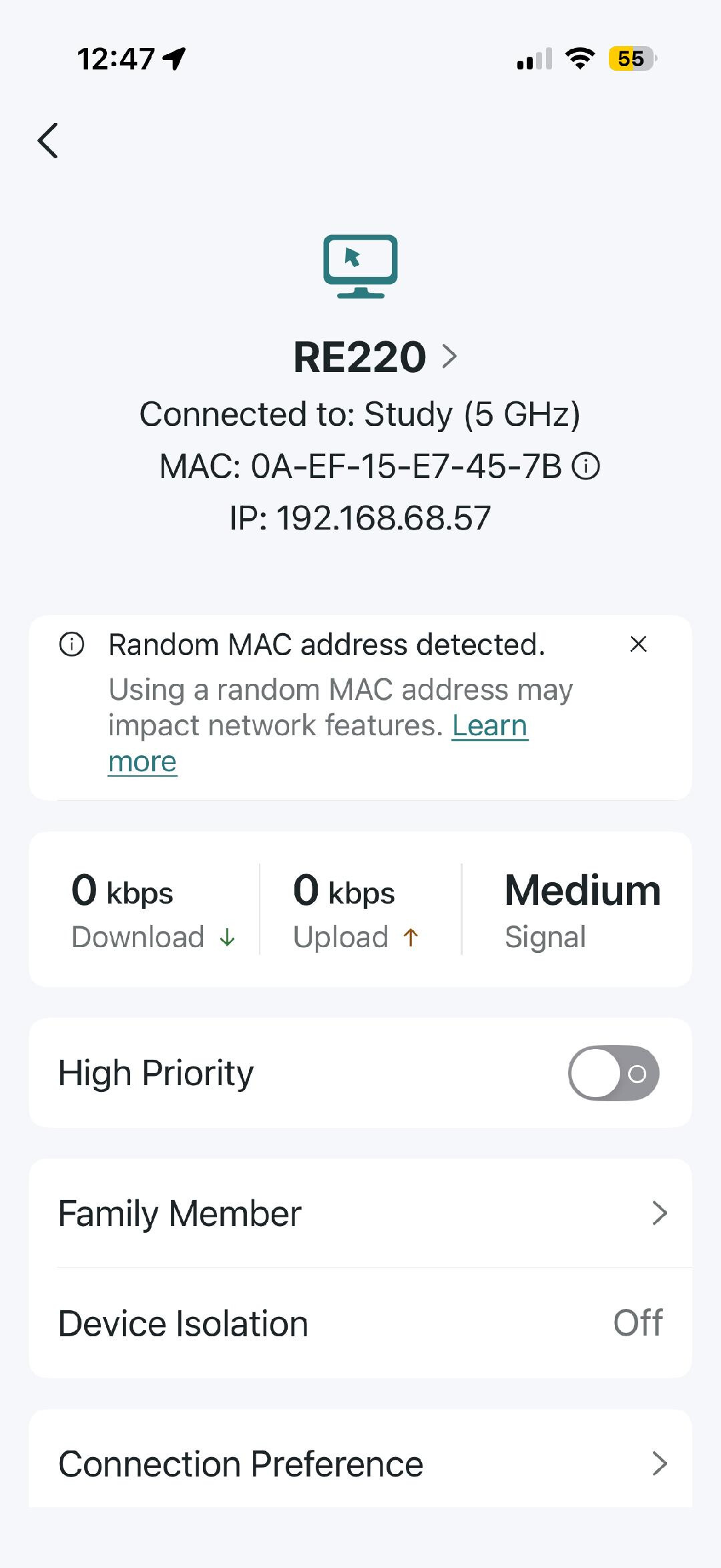

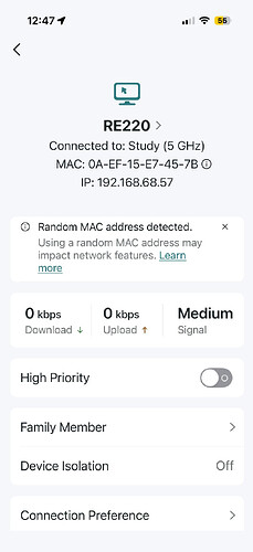

HI Sarah, Now got the adapter wired inside the HP and powered. Got it connected to a TP-Link RE220 WiFi extender I had working on our wifi and showing an ip of 192.168.68.57.
Tried at following the instructions but failed. Not really sure what to do about connecting to the adapter…tried creating a virtual port with HW serial download so stuck at this at the moment……

Its slightly different as I’m using a pc connected by ethernet cable to the TP link router Router IP: is 192.168.68. extender (RE220) IP:connected to my Deco network USR adapter IP: 192.168.68.57.
S-Net pro is successfully installed…….all feels pretty close….I’m hoping that someone can advise what needs doing to connect?
Is there a fourth octet missing from this? (…68.nn)?
As you are completely TP Link can they give any advice (e.g. technical helpline)?

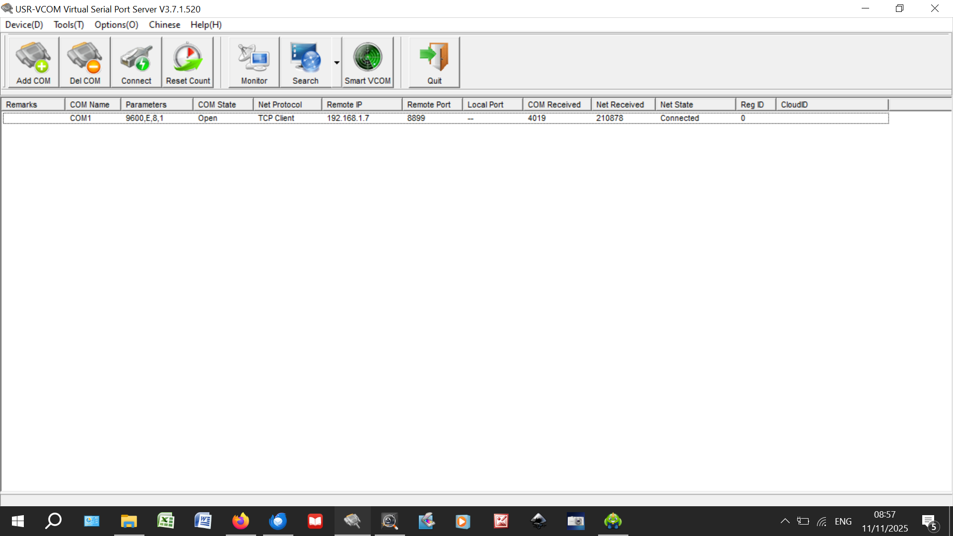

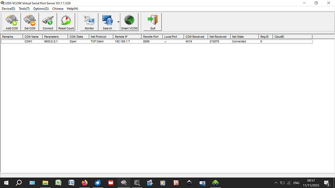

Did you manage to install a virtual com port ok? If not, I found the PUSR one to be very good [[ Virtual COM Software]] Virtual Serial Software V3.7.2.525-PUSR IOT
More likely 192.168.1.68
Thanks for the PUSR, info, looks slick now installed…asks for remote port…where do I find that that or does the pic help identify?…also shows the IP address?
