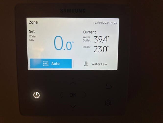

please photo your controller so we can see what mode you are running in.
and do you have any 3rd party controller or thermostat.

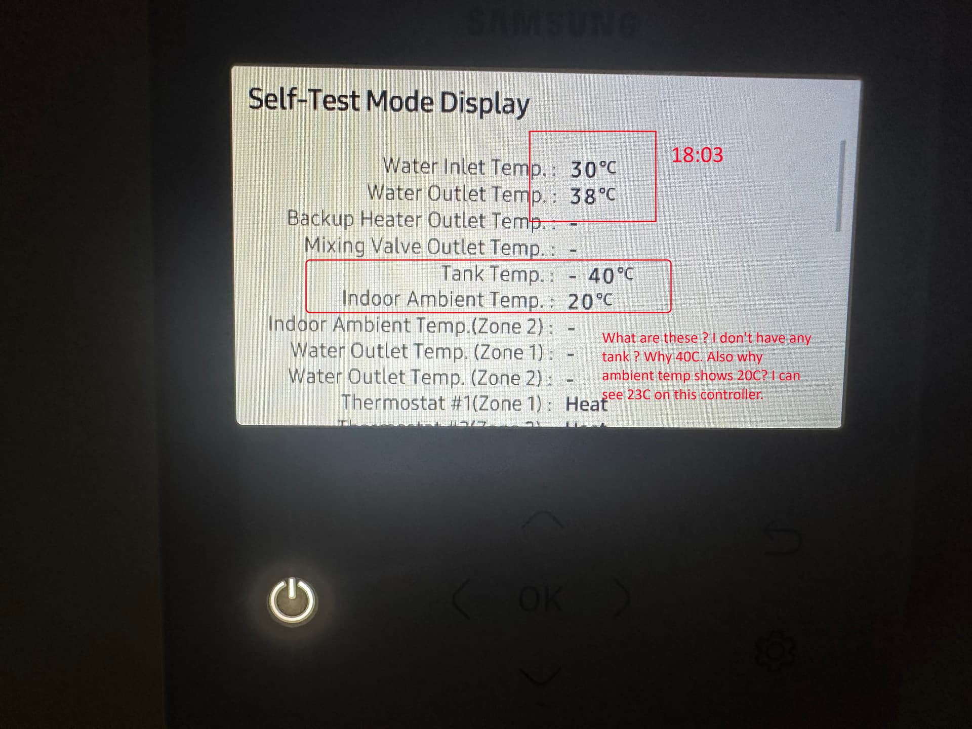

Here I have one question for those who knows, maybe @SarahH. Do you have an idea why I have here displayed tank temperature 40C and ambient temp 20C ??? I don’t know why because I don’t have a tank and my room temperature showed in controler is 23C.

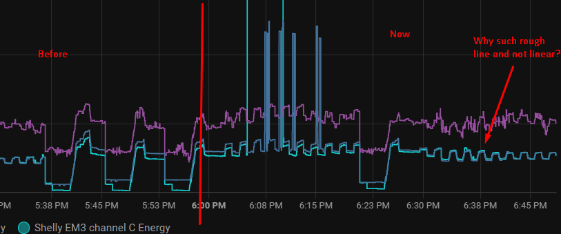

And another question, if you look at this graph, do you know why that power lines are so hars for the inverter ? There is a difference of 150W so if we multimple x 3 it means it jumps from 1.0KW to 1.35KW every minute! Why ? When it starts it’s linear. Also my AC units have linear curve and not these pumpkins :slight_smile:

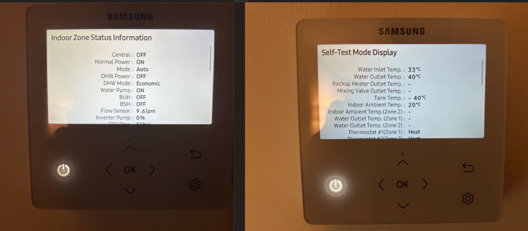

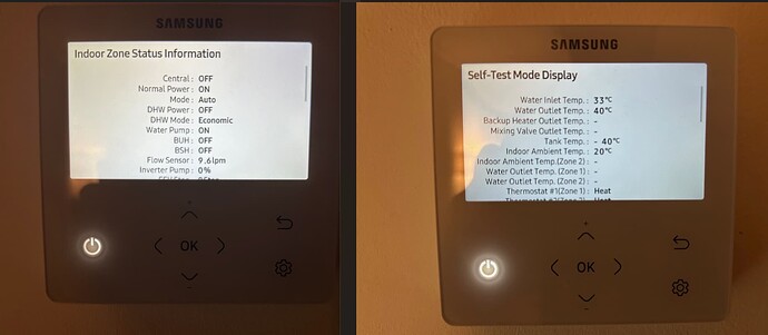

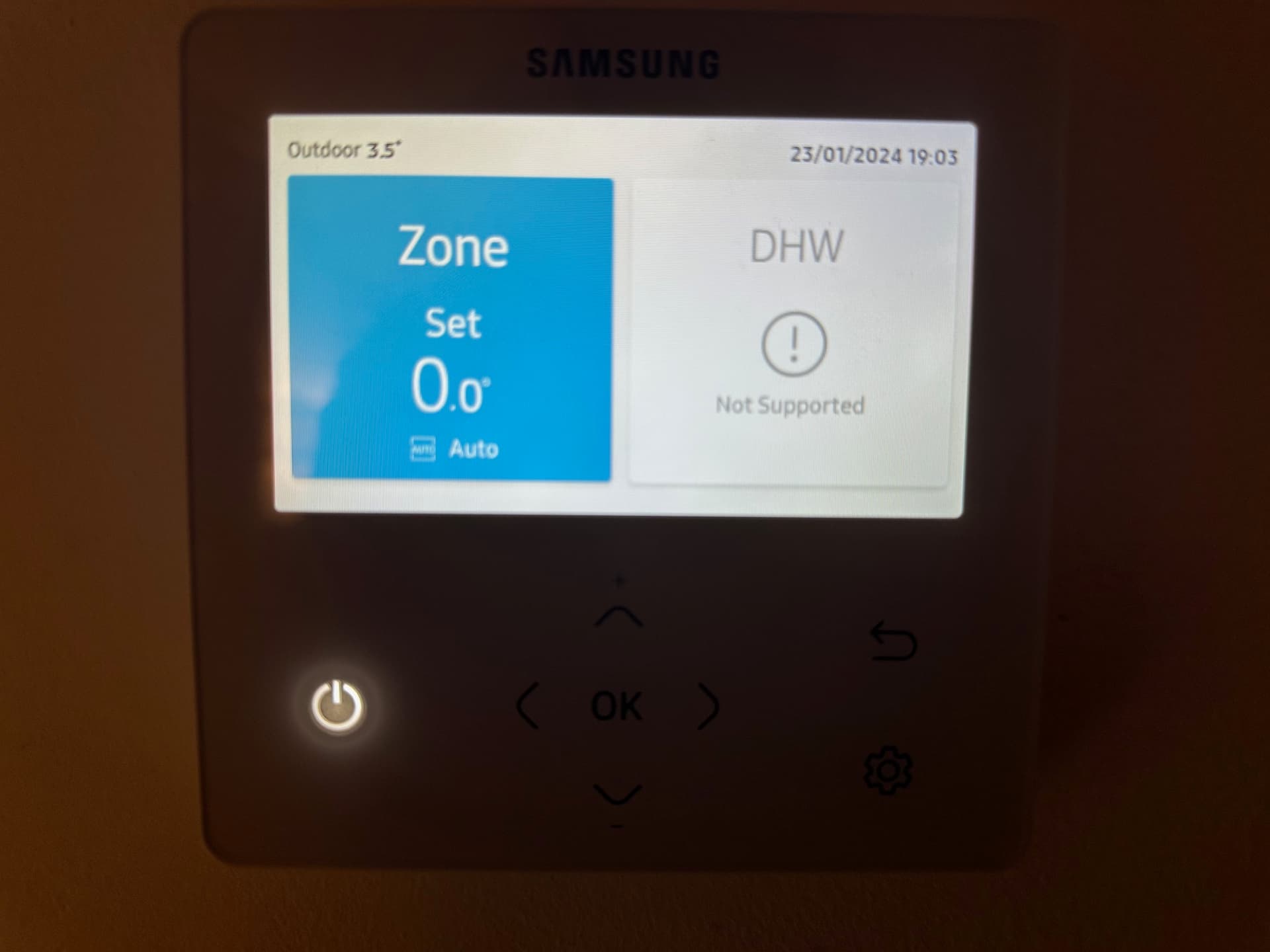

Not sure what is inconsistent but here you go and thanks for your patience.
I don’t have any external thermostat yet. Check my previous comment with my idea to install one and use when there is warmer outside. Only MMC with wired controller from Samsung. No tank, nothing.

thats odd, I didn’t see the screen looking like that before, unless with an external thermostat. so I think nothing is being your thermostat. that won’t help!
service mode-> Indoor zone option-> standard temperature → indoor

I just did it check my post. It helped a bit, but outside temp dropped to 4C now.
My problem is that it seems the HP shut down sooner before dt=5C is achieved. Don’t know why but I have to observe.

I’ve just checked and this was set to “Water outlet”. I switched to indoor and immediately got and error code E121. Short or open circuit error of the room temperature sensor of the zone 1 indoor unit (detected only when the room thermostat is used). HELP!
I think it should clear if you off/on the controller.
there might be an FSV you need to change as well but I don’t have time to check it now sorry…stuff to do… possibly you need 2091=off.
