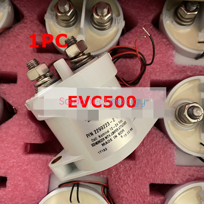

On Ebay search for Tyco EV200AAANA. The coil is 12 or 24v, draws only 5.5w energized, and is rated for 500 amps. They are very solid units, I’ve used them for years.

How Tyco contactors like this
