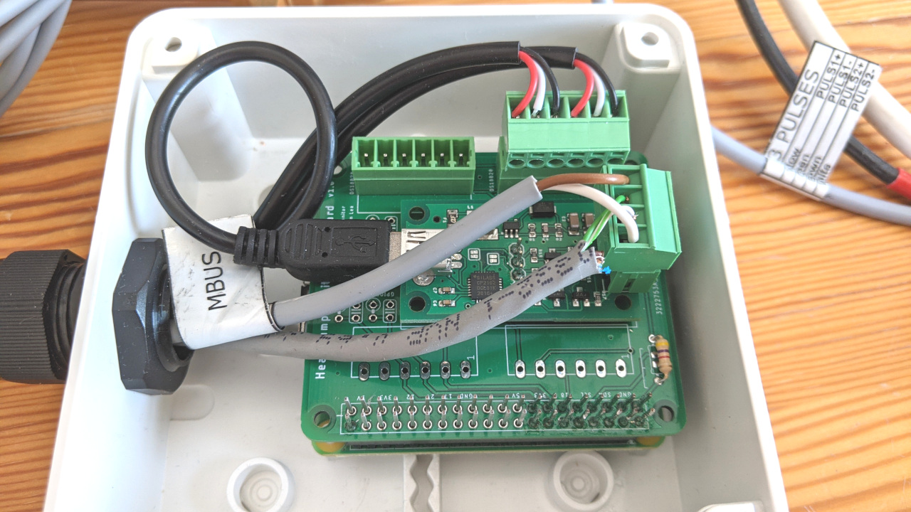

A closer look at the heat pump monitor board with the MBUS reader sitting on top of a base board that then sits on top of the RaspberryPi 3a+. 2x DS18B20 sensors connect in at the top-right and the MBUS meters connect in just below that (grey wires):
Sensors and USB power disconnected:
I am doing a small run of these MBUS reader and heat pump monitor base boards and can supply these together with an enclosure, gland, RaspberryPi 3a+ and emonSD SD card. If this of interest please contact me via the OpenEnergyMonitor shop email: [email protected] referencing this forum post. As this is a custom item and made to order, the lead times are a bit longer than our usual kit, depending on stock and my availability at the time :slight_smile:
