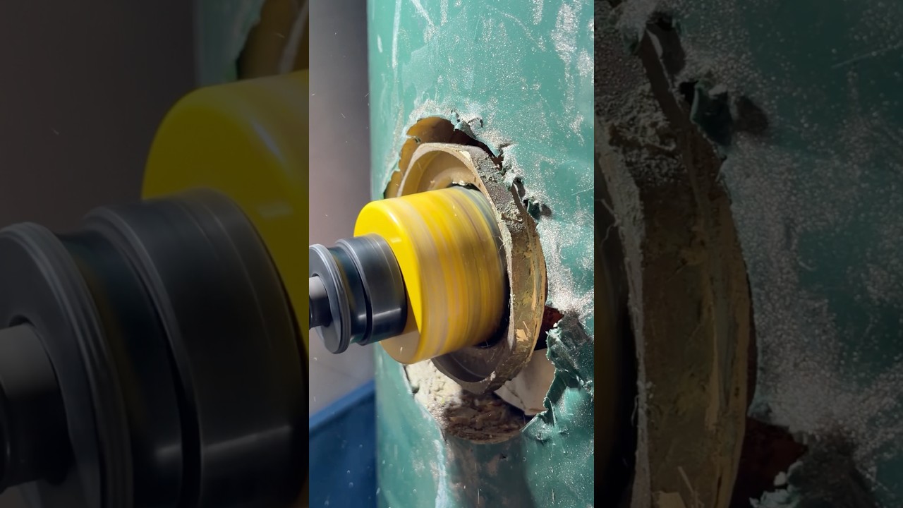

Or fit an “external immersion heater”. Plumber is not trying very hard to advoid selling you a new DHW tank…

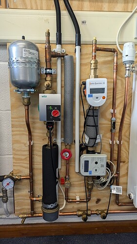

You could fit an external Willis heater, to heat the cylinder, we use one for our heat meter test rig:

Great video: I also watched it on Facebook, where many plumbers said stuff like, “in all my years as a plumber I’ve never …” But, I reckon my heater is stuck solid with over 30 years of very hard water.
Thanks for this idea, I thought it could be a goer. But after much Googling and AI-ing I found that the manufacturers warn against using this in hard water areas, let alone very hard - 389 mg/L CaCO3.
