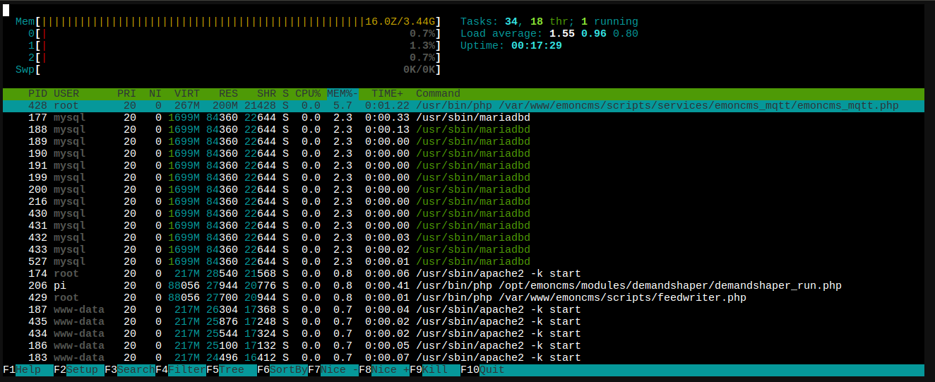

Got htop installed and filtered to see what memory usage is. Right now the top user is MQTT.

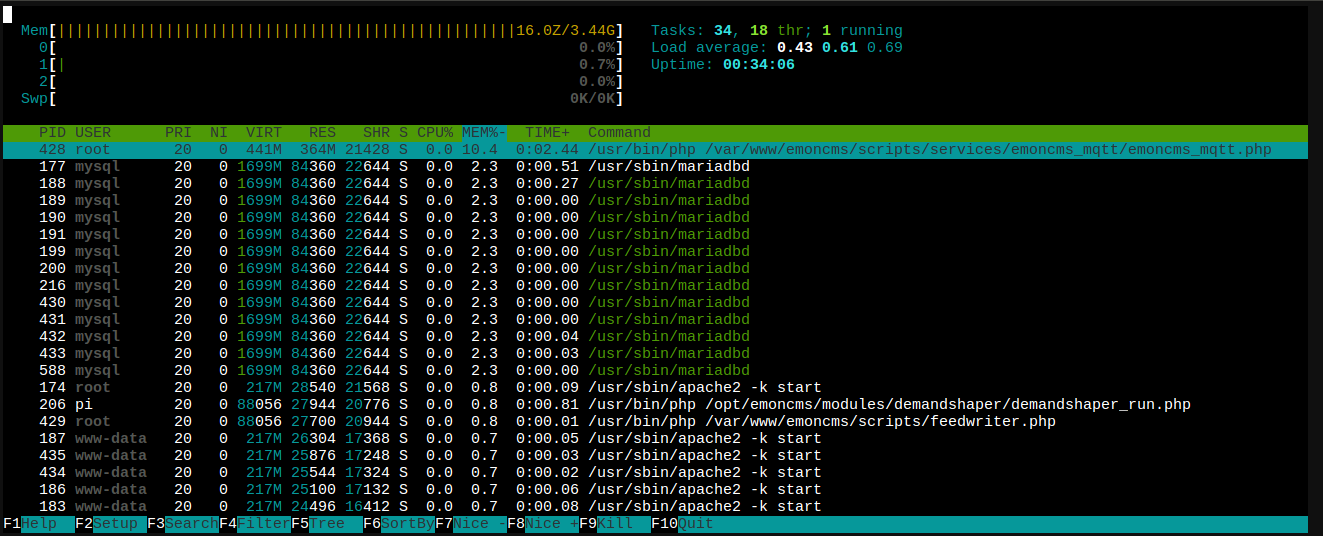

And a little time later.
It would appear that EmonCMS_MQTT might be having a memory leak. Wondering if it’s the version I am on by chance or something with EmonCMS.
So from what I can see EmonCMS_MQTT is using a bunch of RAM. Now, I’m not sure if this module is EmonCMS or Mosquitto, but that is what appears to be happening. Only started to happen once I got Mosquitto working, so I think I found another oddball bug. My question is, what changed? Is the EmonCMS installed via script the same as EmonSD or others?

So I took a look with MQTT Explorer to see if maybe it would offer some insight. I can’t say that it did. But I did pull up htop to see how emoncms_mqtt was up to 15% of memory usage. Decided to just stop the service on the emoncms web page. When I did that I saw the memory usage unload and when I restart it I could watch the memory usage grow again. This does appear to be an issue within emoncms_mqtt. I’m unsure if maybe there’s a configuration file that is maybe incorrect, but would check all of those if someone could point out which ones emoncms uses.
