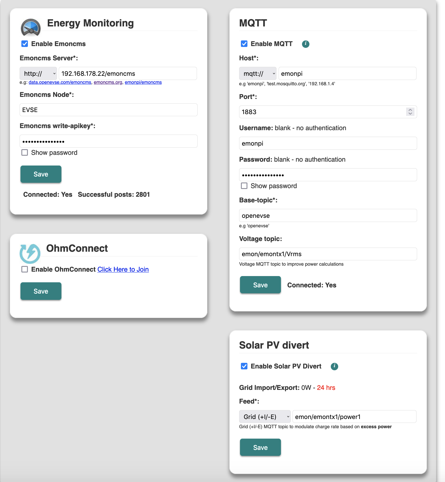

I’ve had my OpenEVSE running for a while now and working successfully, including solar divert.
Recently, I noticed that it is no longer reporting the grid import/export value and instead always displays 0W. The charger should be receiving data via MQTT running on a Pi with Emoncms (with an emonTx). Checking mosquitto.log on the Pi I see some disconnections - though I’m not sure what’s normal:
1642535953: New client connected from 192.168.178.142 as openevse-9c4c (c0, k60, u'emonpi').

In the OpenEVSE web interface, it looks like it has a valid connection:
I’ve also tried using a topic from a emonTx shield but no luck.

I am slightly confused as in you description you say you are getting the data from a Pi is this an EmonPi?
if so in the feeds you seem to have you are using emontx1 as the topic

Hi John,
The import/export feed comes from an emonTx, which is connected to a stardard Pi running Emoncms. So unless I’m mistaken, the data goes:
emonTx > Emoncms
Emoncms > openEVSE (by MQTT)

doubt this is the problem but the only difference (apart from you are using a emonTx) is that my base topic field is emon/openevse not just openevse
John
I think that’s used for devices connecting TO the EVSE using MQTT, however I did try and change it anyway without success.

What version of OpenEVSE WiFi are you running? There have been a number of connection and MQTT improvements recently: Releases · OpenEVSE/ESP32_WiFi_V4.x · GitHub
Thanks Glyn. I didn’t realise there had been quite so many updates - I’m currently on 4.0.1 (and 7.1.3.T2).
I’m guessing I’ve got a Huzzah ESP32 (unit purchased June 2021), is there a way to tell for certain?
Newer FW versions display the hardware info in the interface. Unfortunately, on your older version, the only way to check for sure is to open up the enclosure and take a look
Updated to 4.1.2 but unfortunately no improvement. When I reset the Wifi on the unit, it seems the timer (that shows time since last data received) goes back to 0. I don’t know if that’s relevant or not.
It should be updating every 10s, does MQTT still report as “connected?”
Yes MQTT is stilll showing as connected:
