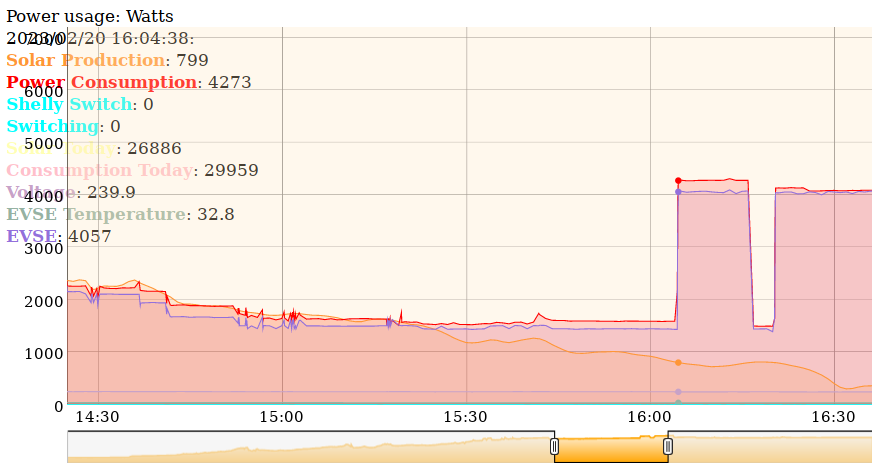

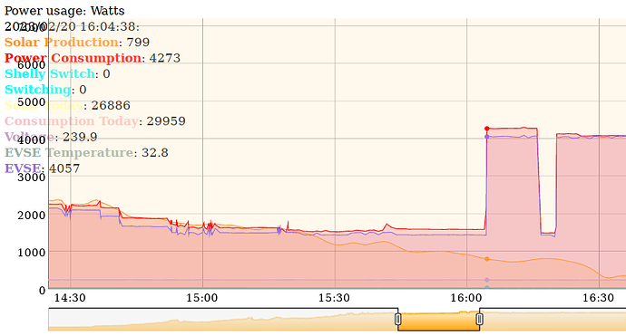

I had another weird period where it ran at maximum charge when it was in ECO divert and should have gone off. When I checked the web GUI it had switched to “enable charge” on that 3 way switch. I’ve attached a graph again, which hopefully makes sense.
Normally I feed it the difference between “Solar production” and “Consumption minus current EVSE consumption” via MQTT. When this is negative and solar is >800 (in this instance) I send 1600W on the MQTT messages to get a minimum 6 Amps.
You can see here when the solar was <800 and the ~ECO fudge I have was dropped: the MQTT feed would have said said (799 - (4273−4057)) = 583W, then OpenEVSE responded by jumping up to maximum current! You can see a gap here where the EVSE charge current dropped to 1600 again since solar was >800 and so it was getting the MQTT 1600 messages, then it jumped back to 4000 when MQTT said <800.
Earlier today I did run it for a period on maximum to recharge after a trip to the coast yesterday and ready for a big driving day tomorrow. But then I did select ECO & AUTO again a few hours before this happened.
Any ideas what happened? Is Smoothing Attack = 0.3 and Smoothing Decay = 1.0 causing problems?

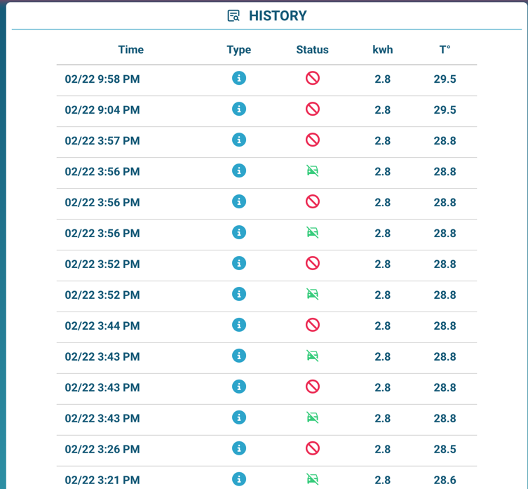

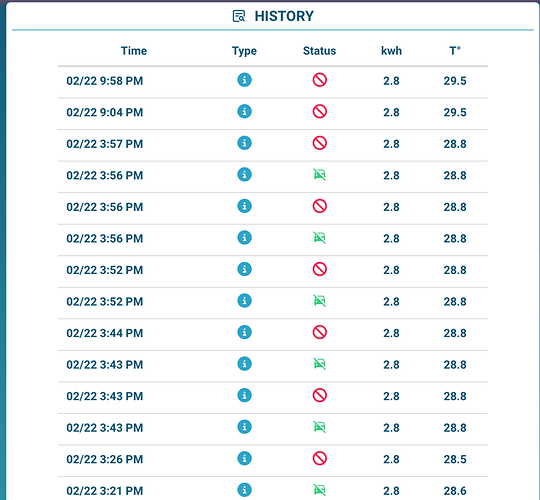

Does the History page look too spammy, chatty? Ideally I can quickly find out the total energy per session without scrolling a huge list like this.
It would be good to even set Miles/kwH in vehicle setup so you can display estimated miles gained in addition to energy.
There has no change on the fw log part, so it still displays the same thing as on previous UI.
But I’m agre the evse log manager should log only state change if vehicle is connected and charge sessions, + faults
