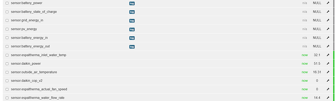

Only 3 of 20 feeds from Home Assistant into EMON are updating
My heating has fired up for the first time today, so I thought i’d check it out on EmonCMS

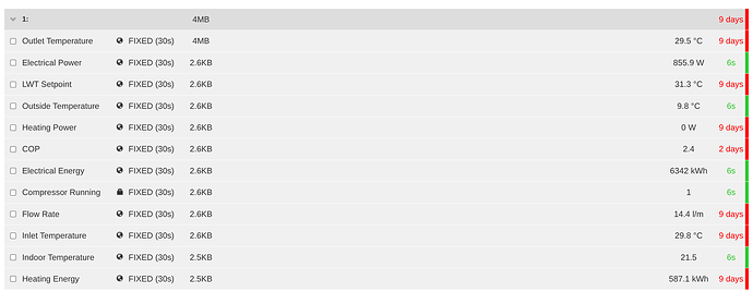

I can see that 17 of the 20 feeds from HA to EMON stopped several days ago
The feeds are coming into EMON but the logging process has stopped.
I’ve not logged into the EMON instance or web interface for a while and nothing has changed that im aware of so Im not sure why it stopped.
Ive also just tried updating from the old version low-write 11.6.10 to the latest but thats not helped.
Any ideas?
Its running in Proxmox in a container
I am seeing “feedwriter: Active Running - sleep 300s 15 feed points pending write” in the Admin page

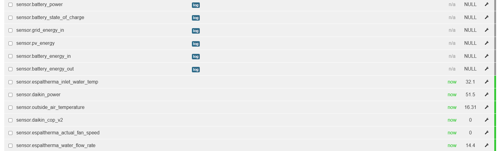

I had a similar issue a few days ago after I had updated Home Assistant. About 20 inputs had got renamed so they weren’t being logged, I had to redo 20 or so feeds.
EmonCMS history: inputs in EmonCMS "received" from emoncms history integration are duplicated · Issue #151959 · home-assistant/core · GitHub may be relevant.

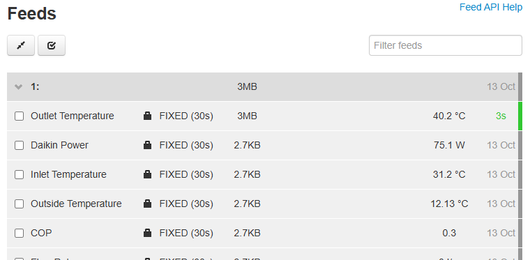

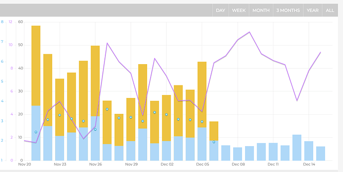

I’ve lost all (bar one) of my my feeds once more!
I’m running v11.7.4 in proxmox and the second time this year I’ve lost my feeds.
The last time i had to dump all my stats and this is getting annoying.

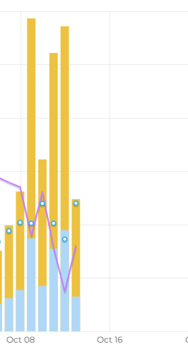

I’ve had no stats being collated since October 13th
NO errors seen in logs:

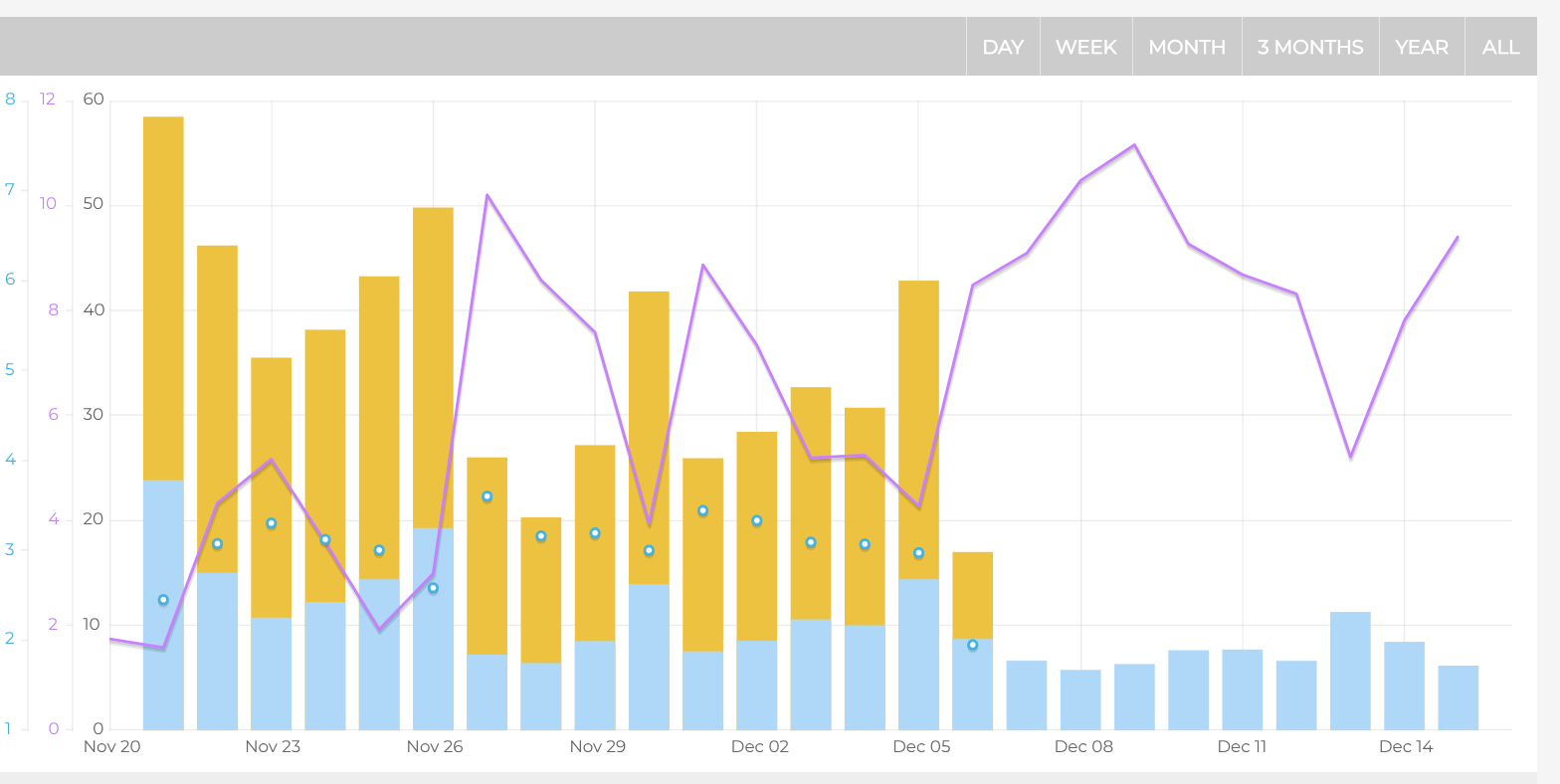

23 days after rebuilding my feeds for the third time, they are incrementally failing again!!!
Im on version low-write 11.9.10 and piping in feeds from Homa assistant version:
Core
2025.12.1
