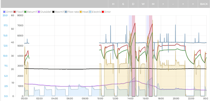

Every so often, I find the results from the heat meter fed by the M-Bus reader connected to the emonHP stop. I have seen the readings restart like the one below without intervention. To manually restart it, I found I just need to unplug and plug back in the M-Bus reader from the emonHP. I thought it might be a power issue with the emonHP but it’s only drawing around half an amp. Has anyone else seen this?

You could try using a different USB cable for the MBUS adapter? Just in case it’s a cable issue. I’ve had a look at your data, it doesn’t look like the issue happen infrequently.
