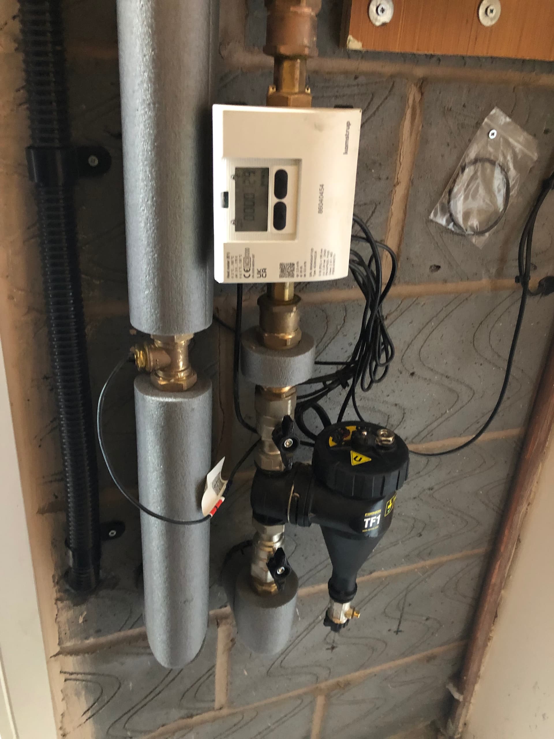

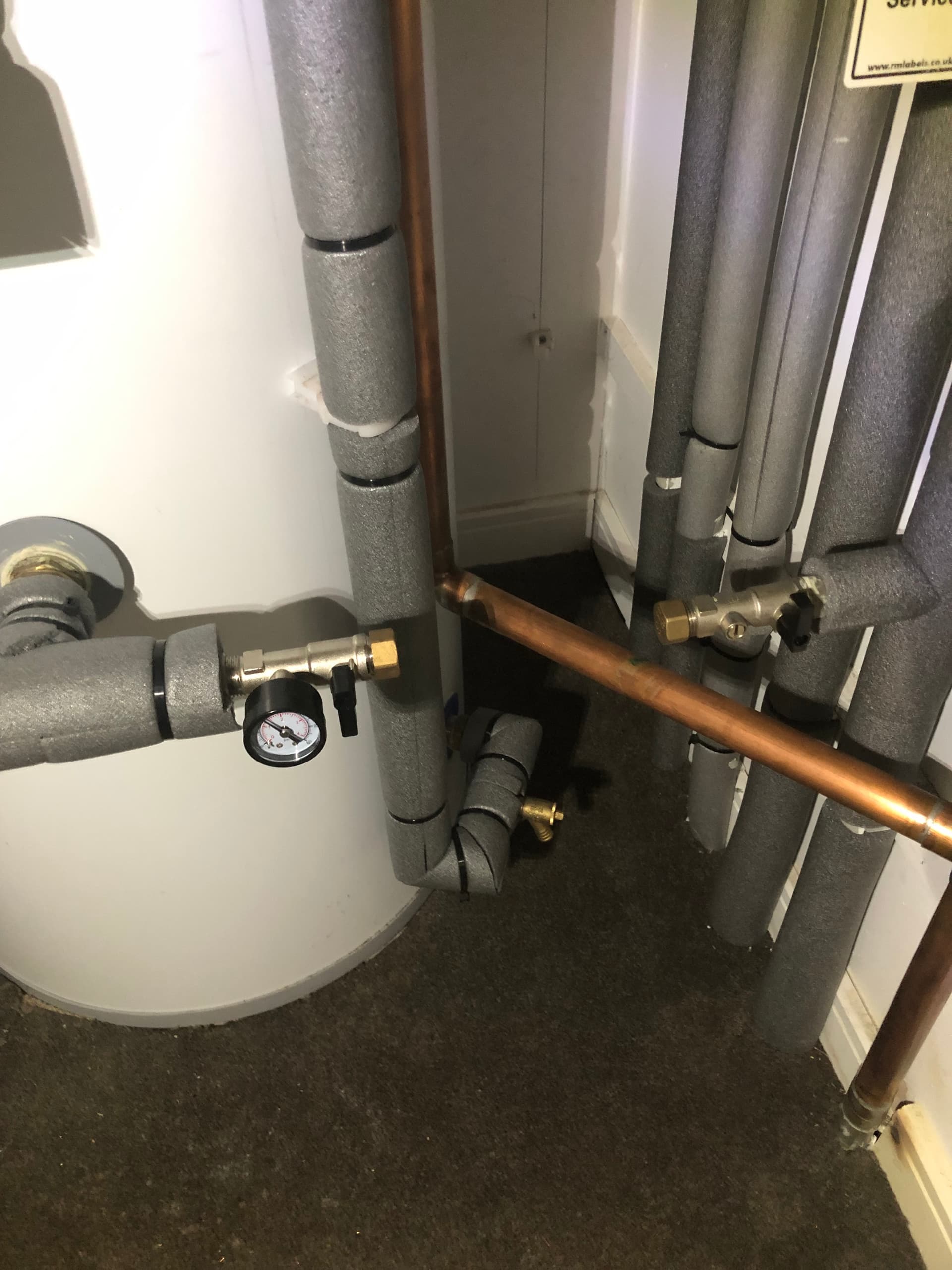

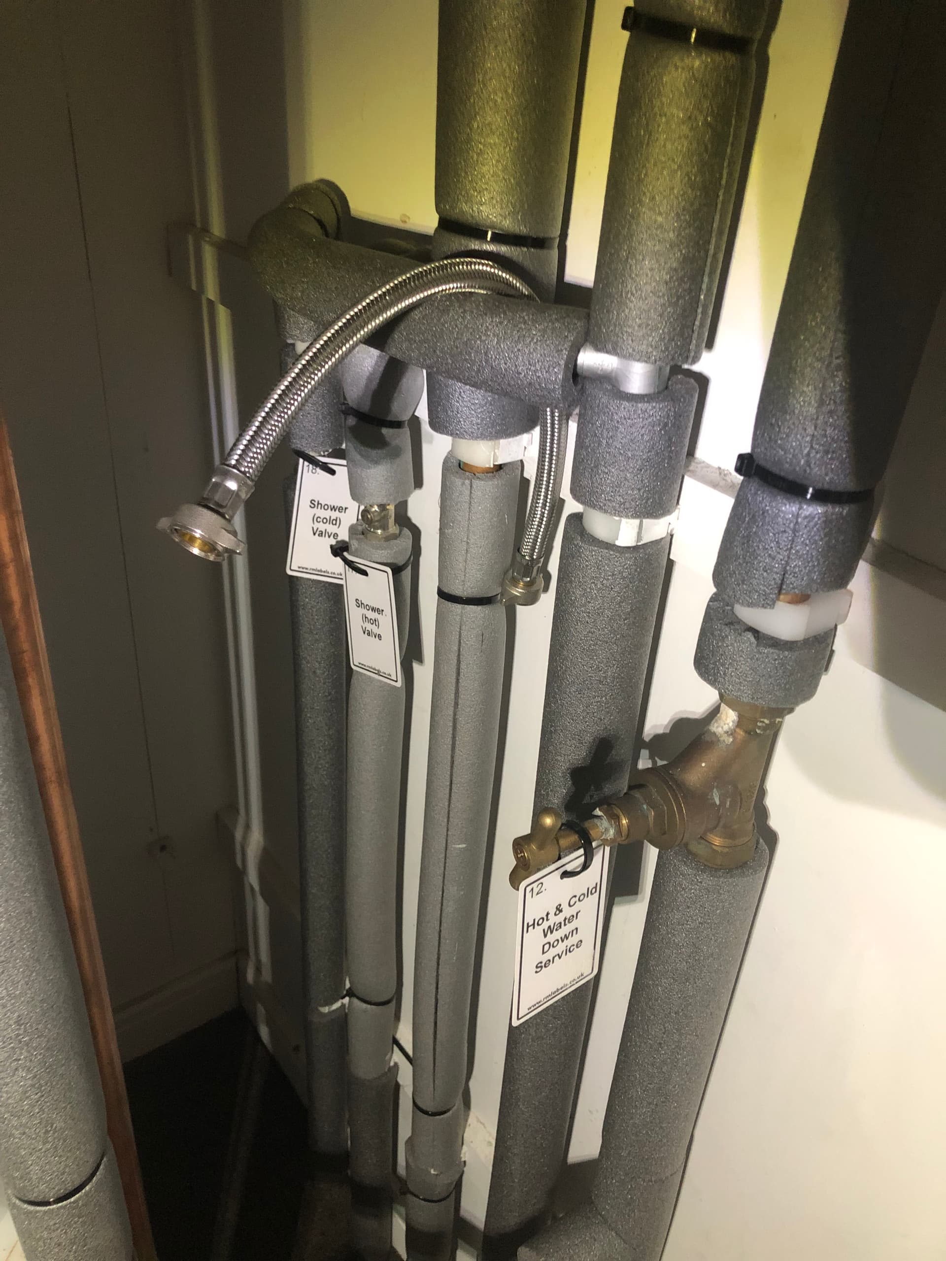

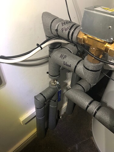

It looks to be on the return pipe, just after the two circuits rejoin, and before the mag filter.
Is there a way to bleed air out of the hot water circuit directly?

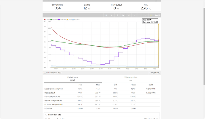

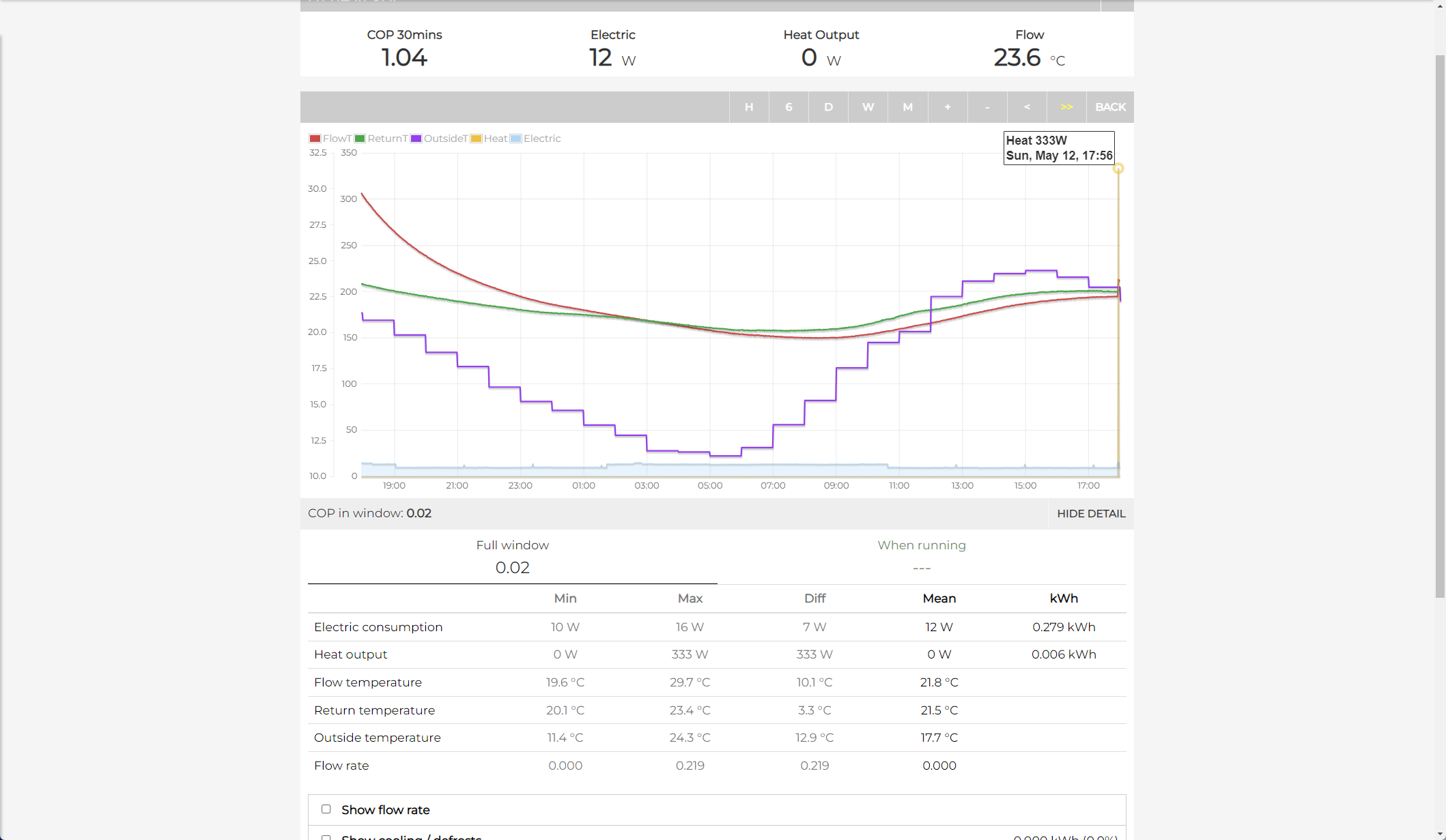

What puzzles me though @Timbones is why the flow readings are zero for considerable periods when we know there is flow - wouldn’t you expect a lower and erratic reading with trapped air? but not zero??
The charts for this system match those from many others we’ve seen here with trapped air; it seems to be a common problem. The kamstrup in particular will report zero flow and an error code instead of a partial reading.
See this topic in particular:
Hoping one of these show it

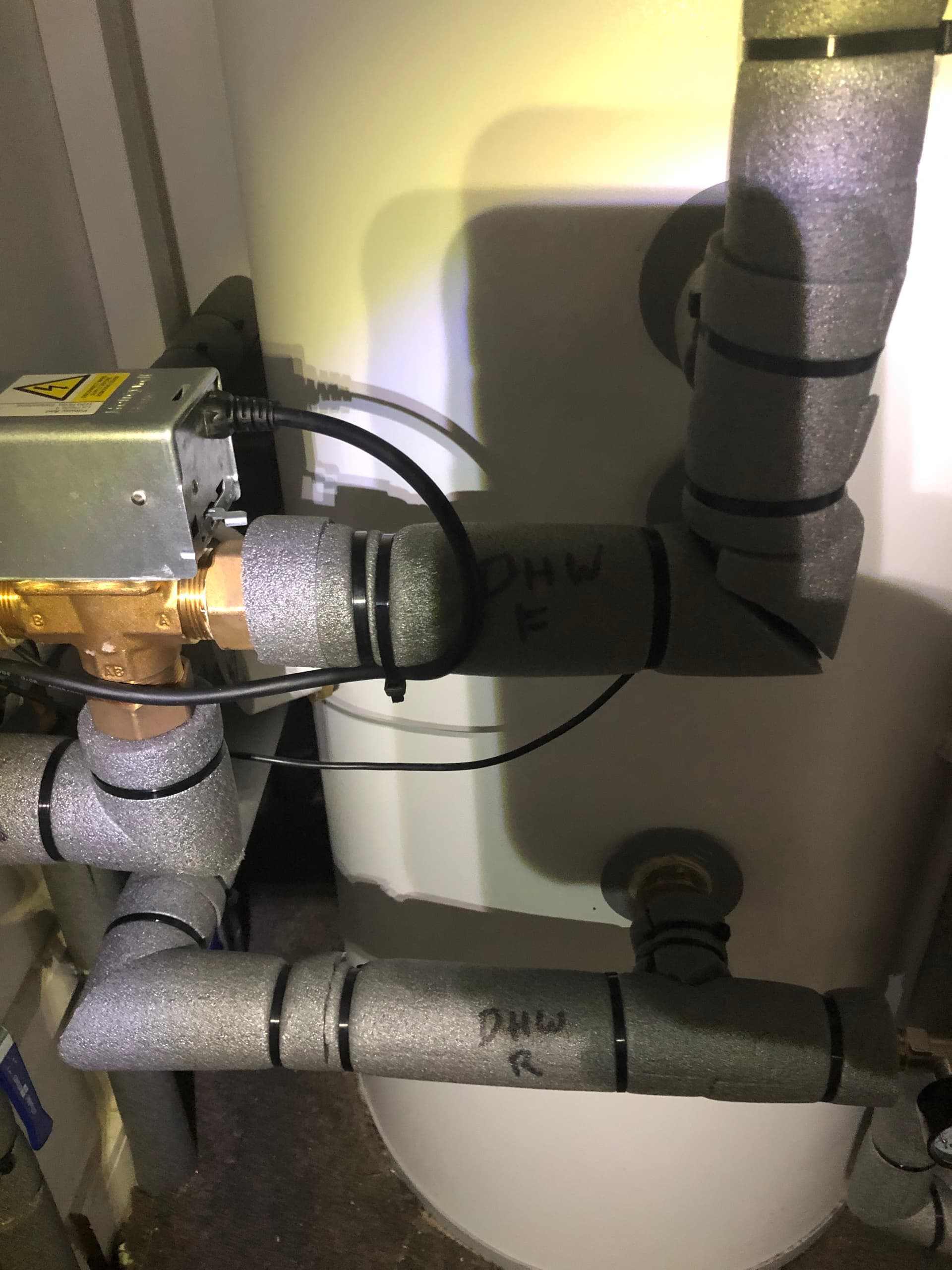

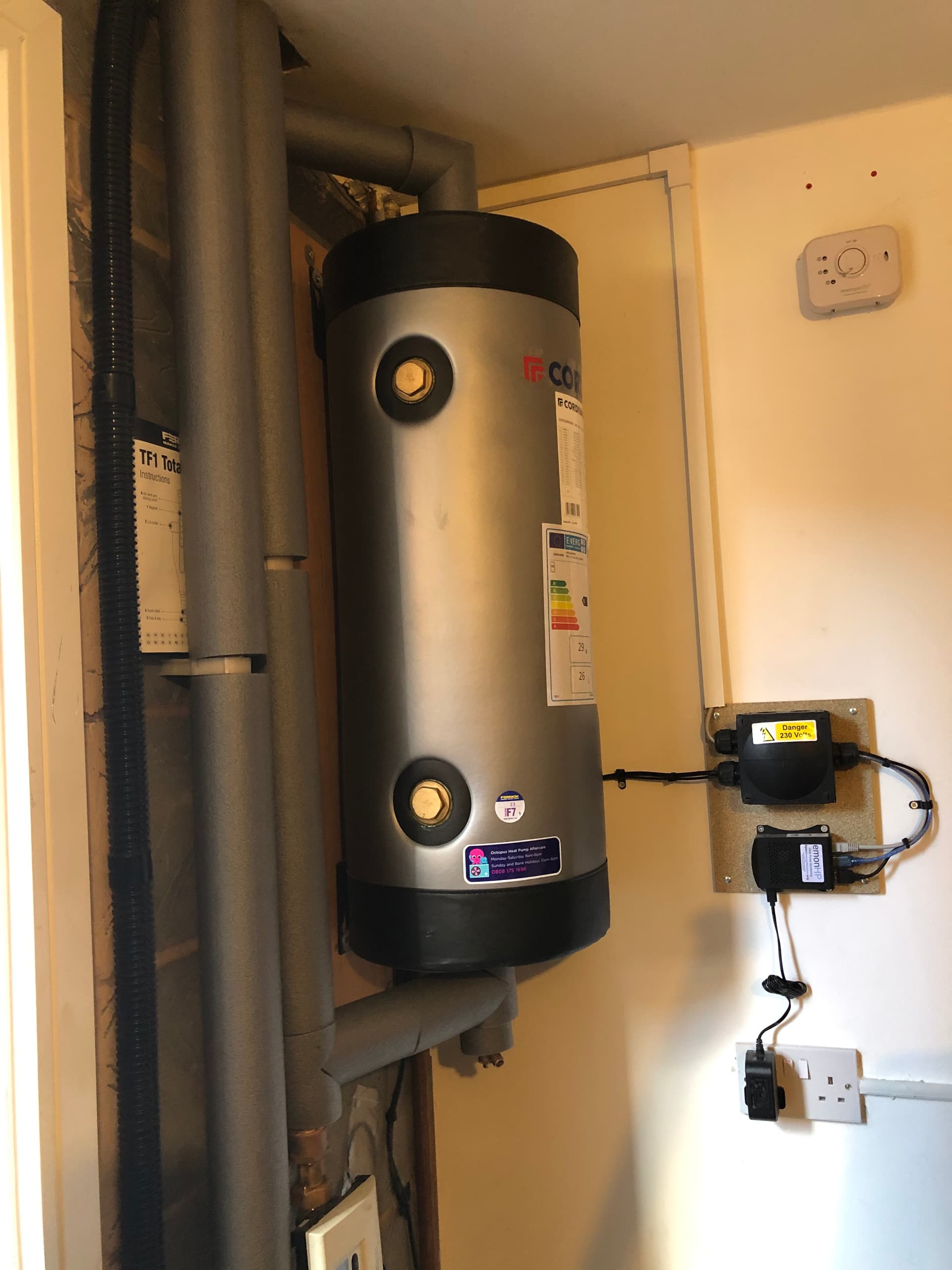

Those pictures do not show the heat meter. It is actually positioned beneath the volumiser tank. See post #62.
OK thank you, that’s in the garage then with the hot water cylinder directly above in a cupboard.
Colin do you need anything else or will the picture on post 62 do?

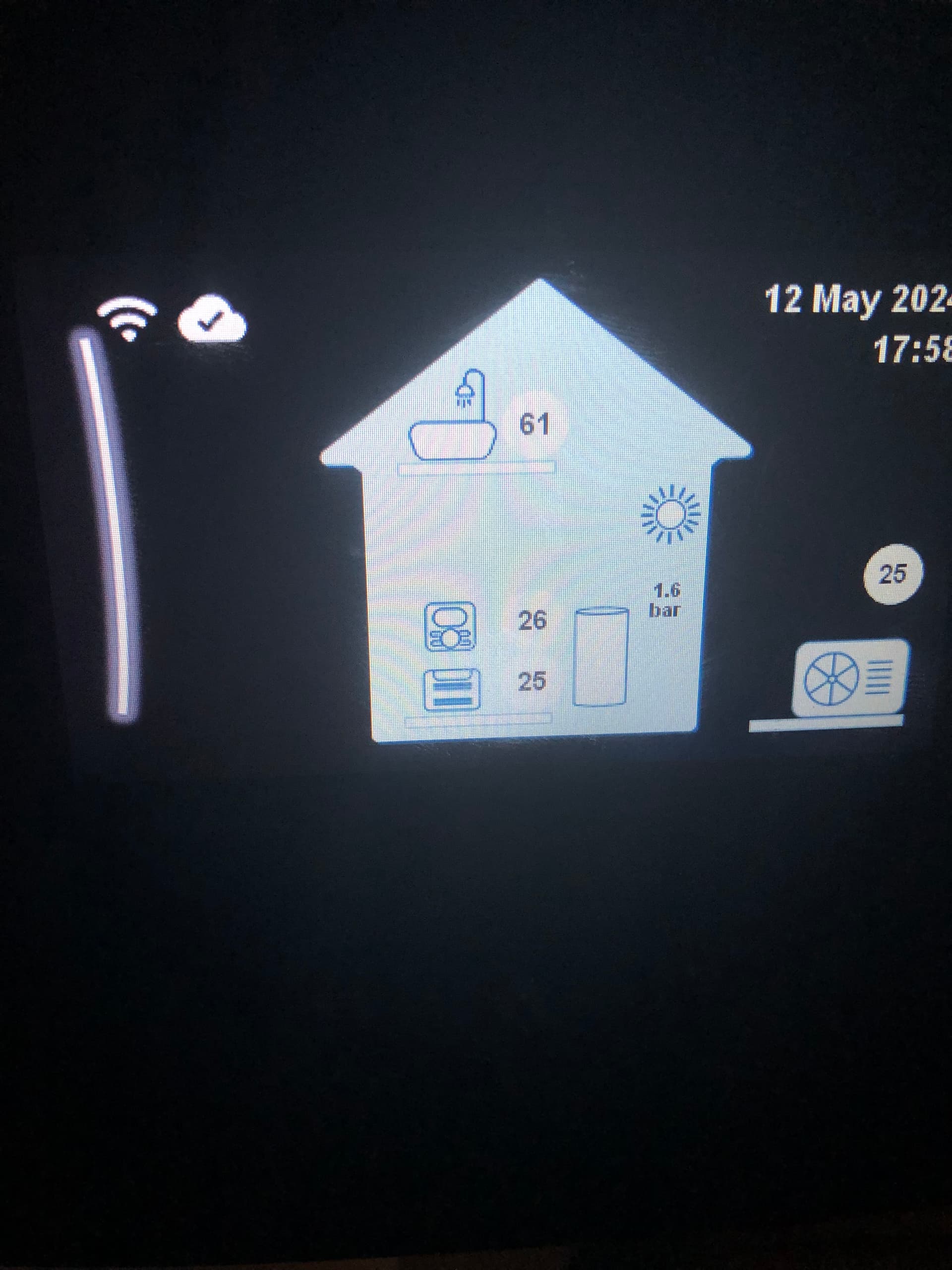

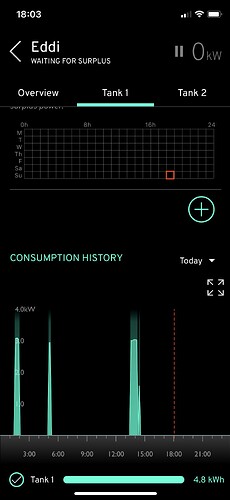

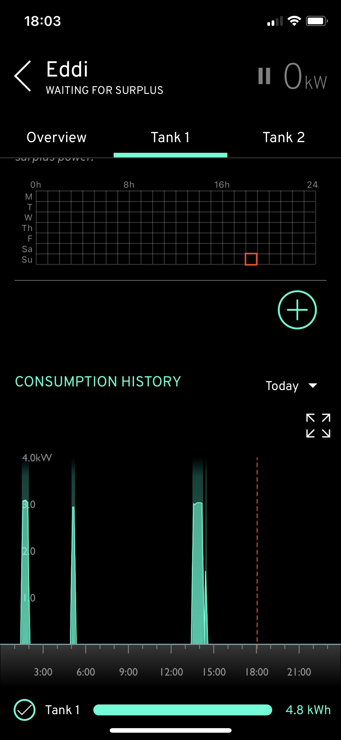

eddi came on earlier today to heat the tank during agile price drop as programmed.
So current temperature showing as 61 degrees on the tank and 26 degrees in the house, yes it’s toasty today :slight_smile:
So surprised there is spike in heat just now.
That’s not a heat spike from the HP but just your house and the piping getting warmer together as it warms up outside.
The last time your HP heated the HW was at 14:20 yesterday. With the Eddi/solar doing all the work today then it has not needed to come on again. Taking it off schedule and just relying on reheat was the right thing to do and I would leave it at that for the moment. No point forcing a schedule heat up if the tank has been warmed by the solar. It seems to be working as planned.
Now the HP should only come on again once the tank temp has dropped by 10c below the rheat SP of 43, ie it drops to 33c… if you use no HW then that might take a couple of days without the sun shining or for much longer with sun shine. If you use a lot of HW then the HP might kick in earlier.

The Eddi should only come on with grid price drops below 3p kWh on agile. I turned off the solar diversion as it works best to export to grid at 15p per kWh
Eddi would have topped up the tank today but this is not showing on heat pump monitor

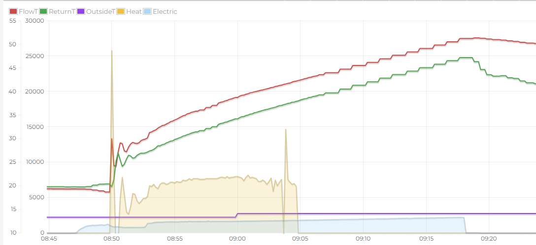

Well the heat meter worked for half of the hw heat up this morning. If we can believe the data it was running at about 7.9kw for that 15 mins at a COP of 4.59 - which seems OK to me.
Over the whole time the HP was running it must have put in about 3kWh of heat. I’m guessing it responded to a temp drop after a few morning showers before 08:50.
Looking at this and a few previous cycles it seems that the heat meter stops measuring the flow once the flow temp gets much above 40c.
So it seems Ok - if you can get the air out of the system…
