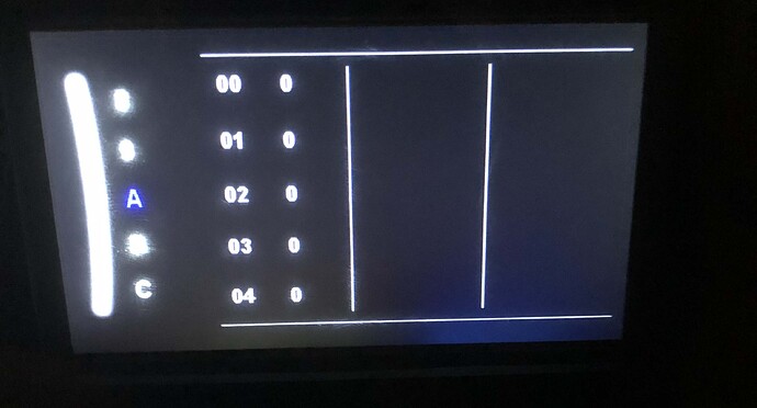

I have gone though the field codes and set them as you have suggested, hoping this fixes it all. I am attaching below ALL the field codes, from what I gather these codes allow you to set everything without going through the UI on the Daikin controller, just another way to program it right?
And A to F
