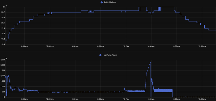

off typic but - Set the Madoka to 19.5 degrees 24/7 ie no schedule, no setback and a tuned WDC with modulation, our 8kW unit (4 bed 200 year old house ) uses 12kWh (~500W baseload) when on 24 hrs a day at 3 degrees outside (COP 4.25 ish), turns off as a result of solar gains, cooking, PC gaming etc takes about 6 hrs to cool down and then turns back on again
