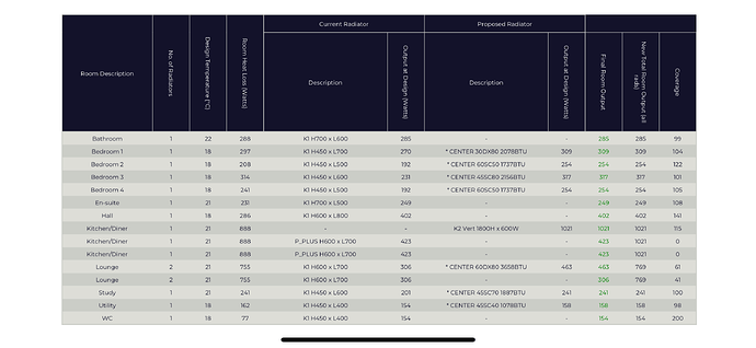

Survey completed this morning. Heatloss came out at 4.1kW, as against the 4.3kW I’d calculated using Heatpunk. Few rad changes needed, but most were only a few watts too small, but they’d have to be changed to satisfy MCS. Should class as a standard install, so the £500 fixed price quote should stand, minus the £100 referral from my parents. Daikin 6kW plus a 250L cylinder. Seems like a bargain. Will wait and see what they come back with from the design team. Asked them about OEM L3 monitoring and apparently they won’t install that for me, even as a cost option. I had got the impression that they would supply and fit the kit - is it a question of speaking to the correct person?

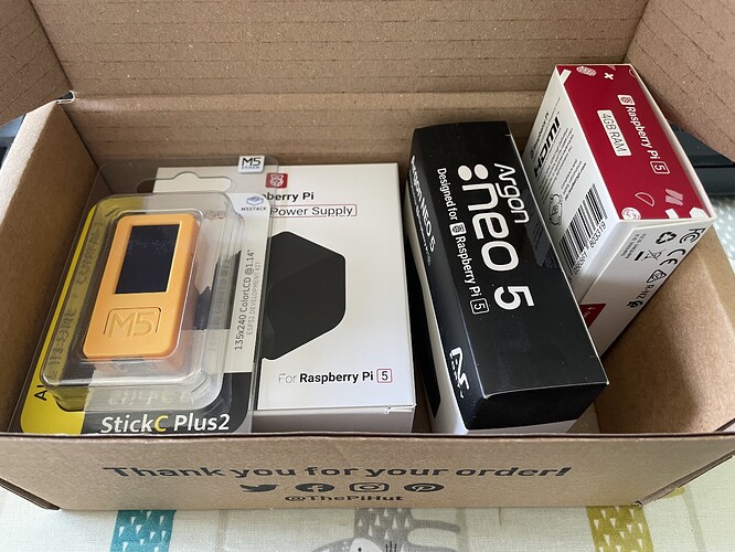

You’ll get all the information you need to populate EmonCMS so that you can monitor your system and the changes that you make, so that you can optimise it for your home.

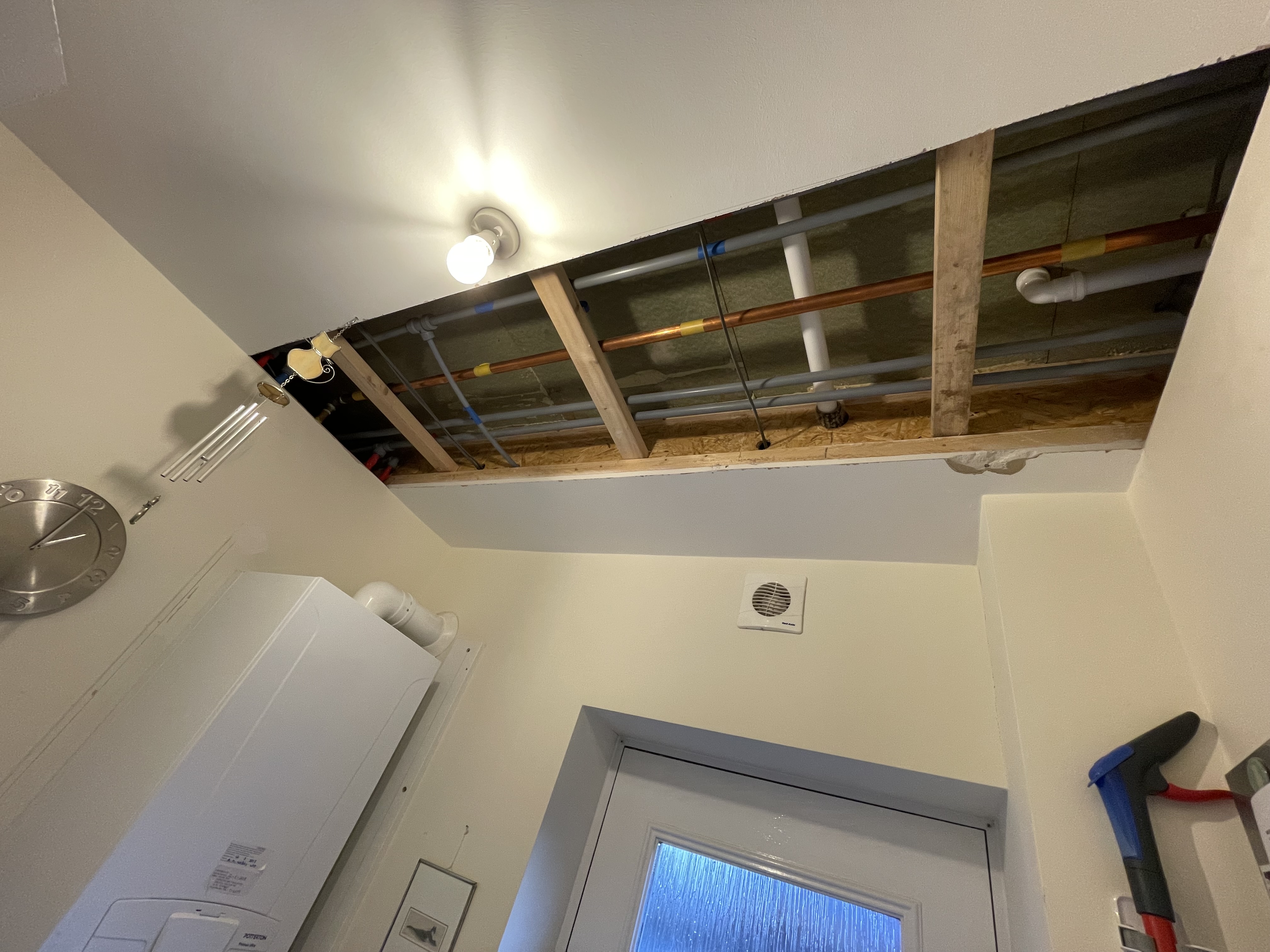

We’ve had our survey results, which gave a heat loss of 4.1kW. Octopus are proposing a 4kW Daikin and a 250L cylinder. They say we need 7 rad swaps, plus we’re going to replace 2 rads in the kitchen/diner with a single K2 vertical as we’re adding some additional kitchen units which requires removing a radiator. Only pre-obligation is for me to remove some ceiling in diner and utility to allow primary pipe work to be run more internally for efficiency and aesthetics. Total cost will be £400. Rad swap in the utility looks pointless though for the sake of 4W!
I asked about 6kW Daikin, but was told that 4kW is fine up to 4.7kW heat loss. I am happy that with a heat loss of 4.1kW at an outdoor temp of -2.2, and room temps of 21 (we only heat to 18-19), that we will be fine. I currently run our gas boiler at 45° flow which gives a return of 40° and heats the house just fine. All TRVs and lock shields fully open. I am therefore confident that with some larger rads I can get down towards 40° flow and SCOP of at least 3.5.

Got some new toys today ready for the install in under two weeks.
I take it you’re going ahead? As £500 is an absolute steal…!
You bet I am! £400 after parents’ referral code. Ceiling down ready for the primary pipework. 8-way outdoor board being swapped for 22-way beast which Octopus have agreed to use.
