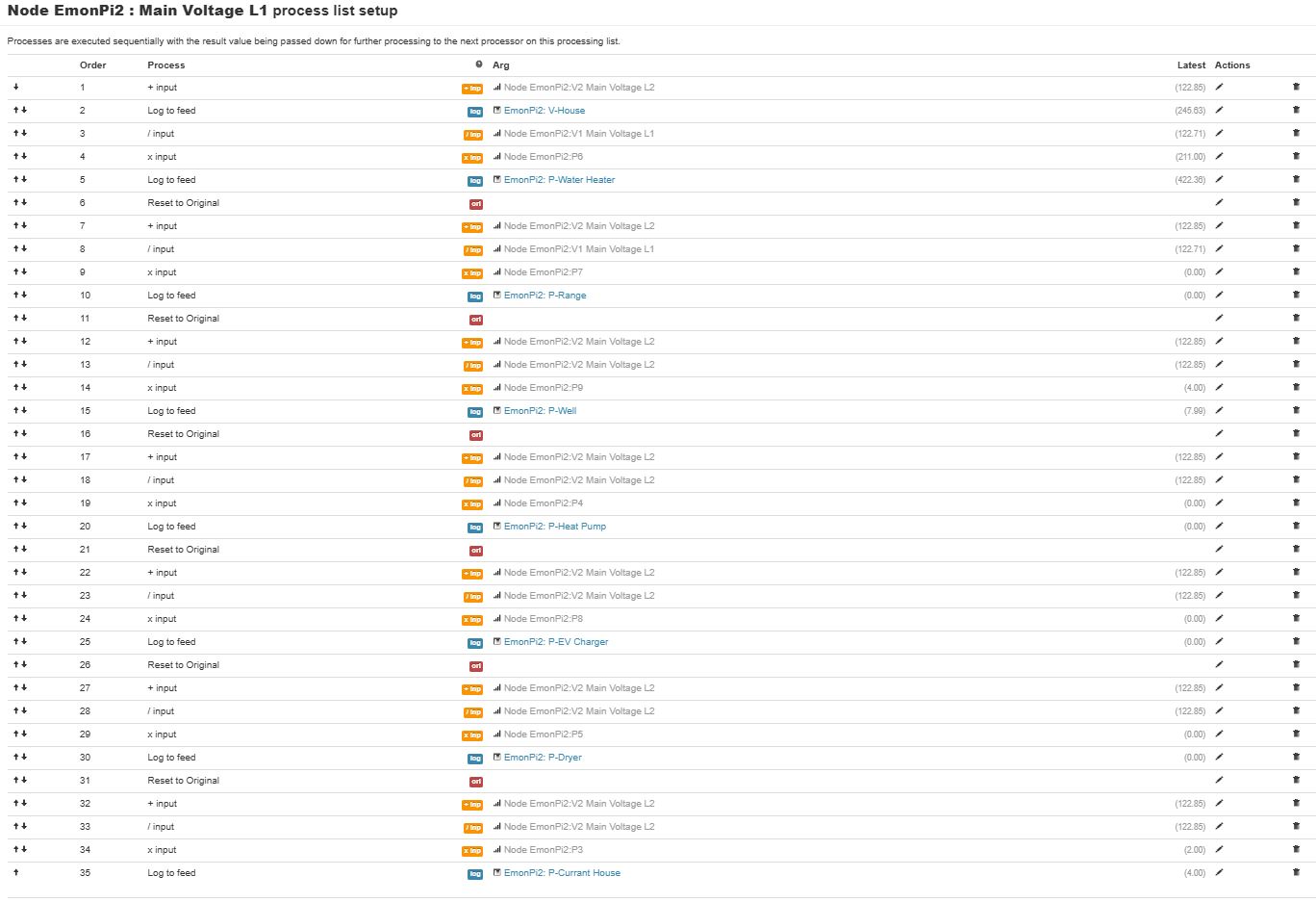

I’m going to carefully read through what you have written here. In the mean time I am experimenting with “process list setup”
  • Starting with V1, I add V2 and then log this value
  • Using the V1+V2, I multiply by the current of the water heater (P6 / V1) then log this value
  • I do essentially the same for all other 240V circuits: restore V1, add V2 to it, divide that sum by V1 and multiply the resultant by the power, Note that ( (V1+V2)/V1 )*P is the same as (V1+V2) * (P/V1)
Two of the 120V circuits are on the V1 leg so they are just logged
The other 120V circuit requires the P to be divide by V1 then multiplied by V2

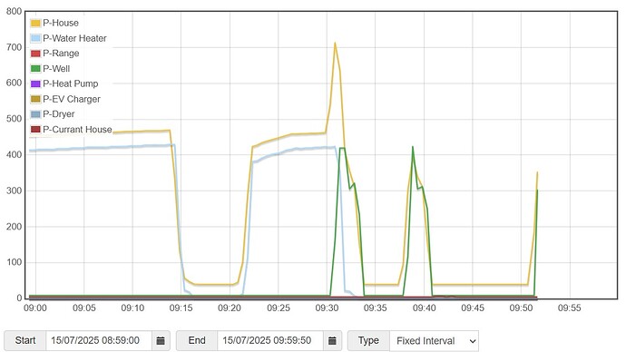

Here’s the screen capture:
This looks like it’2 working:
I suggest you look at the ‘Learn’ part of Docs and read up on how we calculate power. It would appear, from what you’ve written, you don’t understand the most fundamental facts of digitally measuring power.
You write
No, generally it isn’t. It is that only in one very particular circumstance - both voltage and current are pure sine waves. In real life, voltage might be close, current is far less likely to be.
Next, you need to explain why you’re doing this:
Why do you need to do this? By correctly linking the c.t. with the voltage - and as I explained above this has already been done for you, you get the power already calculated on the Inputs page of emonCMS. There is absolutely no reason to do what you appear to have in that screenshot - it looks to be completely unnecessary.
What I would expect to do is, start with the hardware. First, prove that CT1 is linked in the front-end sketch to V1 - the L1 voltage. Disconnect your live feed to L2 - if the odd numbered powers and energies (P1, E1; P3, E3 and so on) continue to show credible values and the even numbered ones collapse to zero (or in the case E2, E4 etc - remain static), then my assumption about the linking between CTs and voltages is correct. If this doesn’t happen, then you can either move the hardware around or re-program the front end to suit how you’ve installed the c.t’s.
Having done that, in the process list (emonCMS → Inputs →behind the spanner icon) for each Power Pn is where you log the power to a Feed (the database) and do whatever else you need. Maybe you want the total power for a group of circuits? Do that in the lowest one down the Inputs page (because by the time that is processed, emonCMS has all the ones above that have been recorded at the same instant. If you use an input below, the value could be 10 s old).
The calculation of power from voltage and current has already been done for you, you do NOT need to multiply a current (where did you get it from - it’s not normally sent to emonHub and to emonCMS?) and even if you did, you’d get apparent power, not real (active) power which is what you pay for.

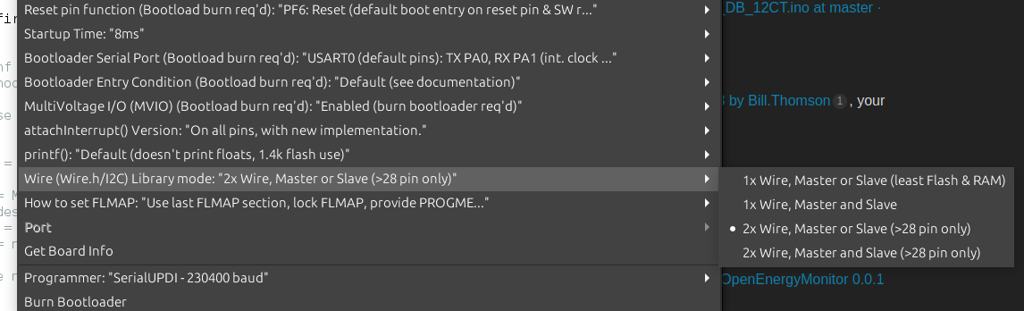

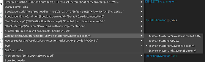

Now I did a double take, maybe it’s not the library and it’s this Arduino IDE setting that enables Wire1:
I just added this above.
I just made the change and now it seems to compile.
