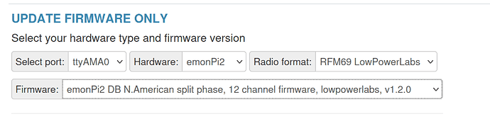

Continuing on in 1. is see that I will "use the split phase firmware
". Following the link, I find “A custom phase allocation will likely be required for this configuration which can be achieved by minor firmware modification.”
Considering my order, NA, emonPi2, emonVS, expansion board and 12 current transformers, is the ID 3 emonPi2_DB_12CT_1phase with the firmware modification pre-installed? Is there a way to query the emonPi2 to determine this?
To answer these questions, I need to have the emonPi2 running. I do that by connecting a “death cord” (lamp cord with [keyed] plug and bare wires :open_mouth: ) to L1 and N (smooth side to L1 and ribbed side to N) of the emonVs, connecting the 8 conductor cable between the emonVs and emonPi2, then plugging into an outlet. Cool, it came up!
Next is to connect to the emonPi2 web page. This is 6. on the getting started page. Unfortunately, my computer (Windows 10) won’t allow me to enter more than 8 characters in the passphrase of the WiFi. My phone did. With a bit of bumbling, I connected the emonPi2 to my WiFi network. Pressing the button on the emonPi2 several times allowed me to see the IP address of the emonPi2. I logged in with user and password of emonsd.
After the detour of connecting the WiFi, these questions are answered on the Firmware page by Updating firmware. Under UPDATE FIRMWARE ONLY, in the Firmware dropdown box I discover emonPi2 DB N.American split phase, 12 channel firmware, lowpowerlabs, v1.20. With trepidation, I click on [UpdateFirmware]. No untoward messages and ending with SUCCESS and restarting. I was unable to find a description of the emonPi2 firmware on the emonPi2 web page.

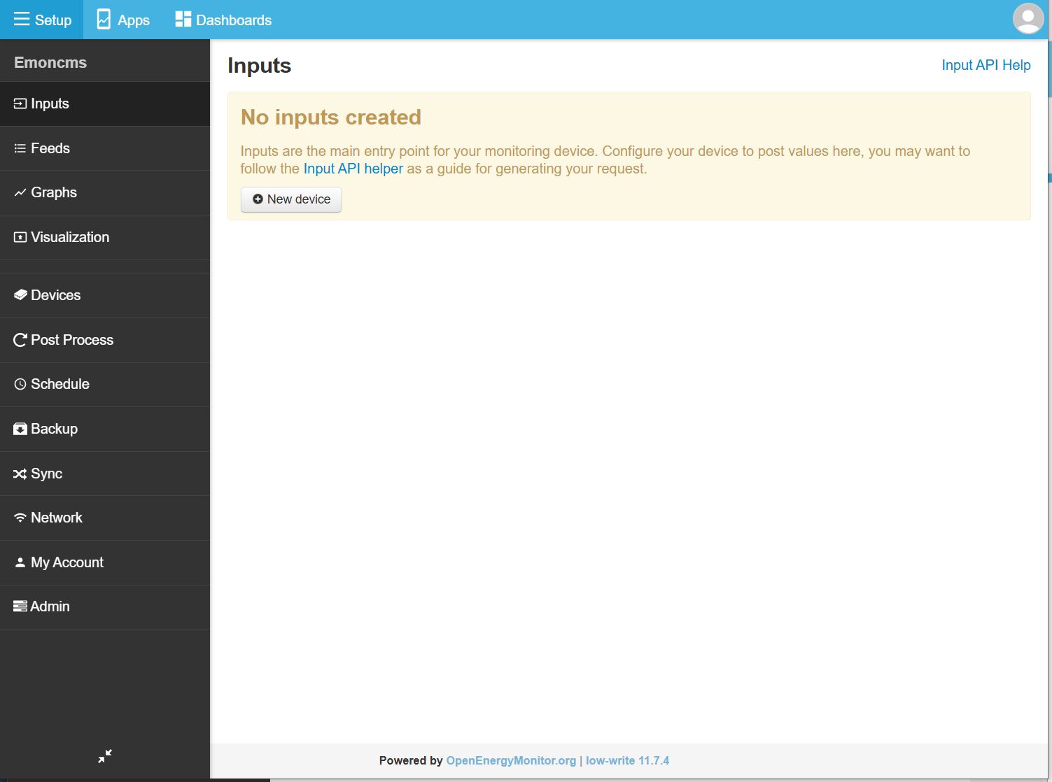

7. EmonCMS setup which has me go to the emonCMS: Getting started emonPi/Base
page. I get to step 3. Inputs page. My page doesn’t look like that. :frowning:
I remember that I upgraded my firmware to emonPi2 DB N.American split phase, 12 channel firmware, lowpowerlabs, v1.20 I start to thrash. here is Admin–>System Info:

Now I have to figure out how to put an image on a microSD card. :frowning:
Updating the easiest way didn’t work because I have no ttyAMA0
Upload pre-compiled didn’t work because I have no command line. Likewise for Upload pre-compiled manually using avrdude
I tried How to compile and upload firmware because I have familiarity with the Arduino IDE. A lot of install apps, copy and paste, etc. I got to the point where I’m suppose to be able to compile and download (upload?).

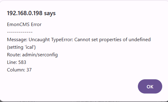

I continue my journey at 8. CT calibration selection. This did not go well at all.
I went to setup–>admin–>serial config. The first thing I notice was that there were only 6 CTs shown. In the black window below the settings for the 6 CTs, but not the other 6. Near the top was note showing the firmware, which indicated the 12 CT firmware.
Next I stopped the emonHub and started the serial config. I decided to change one of the CTs, to get experience doing that. I clicked on [Save], then [Stop Serial] and [Start Hub]. After that, the webpage was unresponsive.
At the emonPi2 I did a manual shutdown, waited the 30 seconds and power cycled the unit.
Going back to the Serial Config page, in the black window I see many
MSG:83,V1:122.46,V2:122.67,V3:0.00,F:59.94,P1:-3559,P2:3572,P3:3,P4:1,P5:0,P6:10,P7:-3,P8:-3325,P9:-3,P10:1,P11:0,P12:5
and the CTs are set to 20A.
I try to change this [Stop hub], set serial, [start]. This time sending an ‘l’ from the console gets no response. I click on [Stop serial] but get no feedback that anything happened. In a few moments, the page says “Site cannot be reached”. Unresponsive to ping.

There’s something amiss around stopping emonHub and starting the Serial Monitor. I don’t have an emonPi2, but I’ve been playing around with an emonPi1 and things aren’t happening as I think they should. Whether this is a constraint of the serial data flow into the front end sketch, similar to turning on the serial monitor in the Arduino IDE invariably causes a reset, a deliberate action or an oversight deep in the code somewhere - I don’t know.
What appears to be happening is “Stop enonHub” doesn’t stop data arriving (which is what you might be expecting) and data continues to be sent from the front end. Setting the datalog period temporarily to 30 s or more [send the command d30] gives you time to send commands between data arriving from the front end (Node 5). Remember to set it back to 9.8 s before you finish.
Stopping emonHub then starting Serial Monitor appears to restart the front end, sending “Pi is booting - Please wait” to the display, which gives the impression the Pi has rebooted. I don’t think is has, because seconds later, it thinks it’s been up for many days.

I’ve never got Serial Config Tool to work any differently to Serial Monitor, all it produces is “Firmware update required:…” despite having updated the OS, emonCMS and separately the front end sketch (is this what “Firmware” means?) minutes previously.

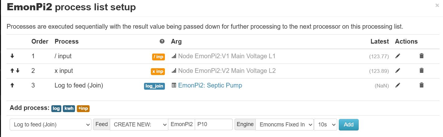

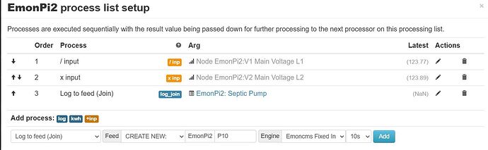

My goal is to have a graph of whole house kW.
I gather the description of the inputs from here but that leaves out Vn, F (which are obvious) and, “1”, which is not intuitive. (breaking out in song … is the loneliest number …)
I’m not understanding Pn (where n is 1-12). P = V * I * φ. I is the current going through the CT, φ, the phase angle between V and I, but what is the source of V? I have V1, V2 and V1+V2. I have 120V circuits, which could be sourced from either leg, and 240V circuits.
P1 and P2 are on the main feed cables, and seem to be associated with V1 and V2 respectively (because the powers are positive and almost the same). Seven other circuits are 240V; on six of these the CTs are on the V1 feed, the other on the V2 feed. Theses need to use V1+V2. The remaining are on 120V circuits, two on V1 and one V2. This latter P is negative.
Is this how it’s done?
How do I specify with which V to associate the P?**
