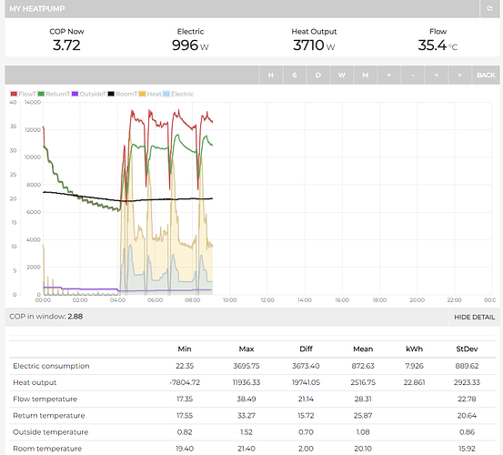

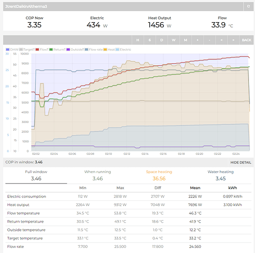

Though this includes the morning when the boost heater was running - it’s been averaging 3.0 since then. Not great but less bad.
Yes it does Tim, sorry, my mistake, I was looking at the instant COP and then wrote down the COP for the day thinking I had only selected the current heating cycle.
Yes, it is less bad, but not really what you would hope for in a house that can heat to 22c with 32.5c water flowing through the radiators at 4c outside.
It should be outstanding?
Well it is of course, but outstanding for the wrong reason!
So, not as bad as usual, as I predicted, but still worse than leaving it running.
Im a bit confused now, so much information over the last two weeks, maybe it is a characteristic of my house, the heat pump or a combination of both but the start up is poor and so my inclination to just let it run is correct.
Well, in terms of COP anyway. Whether that is the best or most efficient way to heat our house I don’t know, I would have to do some work on that but it seems a bit pointless when major changes are imminent.
All I know is the poor COP depresses me and reminds me that I have the wrong heat pump, not that I really need reminding!
I don’t think it makes a lot of difference what I do, the heat required is fixed and nothing has much of an effect on the COP, it’s 3.5 plus or minus a little.
And that makes sense really as it is generally providing about 50% more heat than we need when running efficiently or using 50% more electricity than it should when providing the heat the house actually needs. Which one of those it is determined by the flow temperature, higher flow temperature = too much heat, lower flow temperature = correct heat but poor COP due to minimum electricity input.

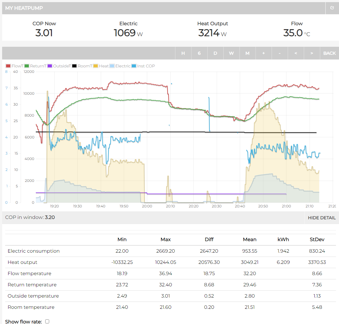

I think it is running pretty well this morning, much better without the BUH!
We are close to the system design conditions now, it is 0c outside now
Heat requirement to maintain this is a bit less than 4kW and I am still sitting in the conservatory that should be cold but isn’t, it’s warm as it usually is, about 20c now.

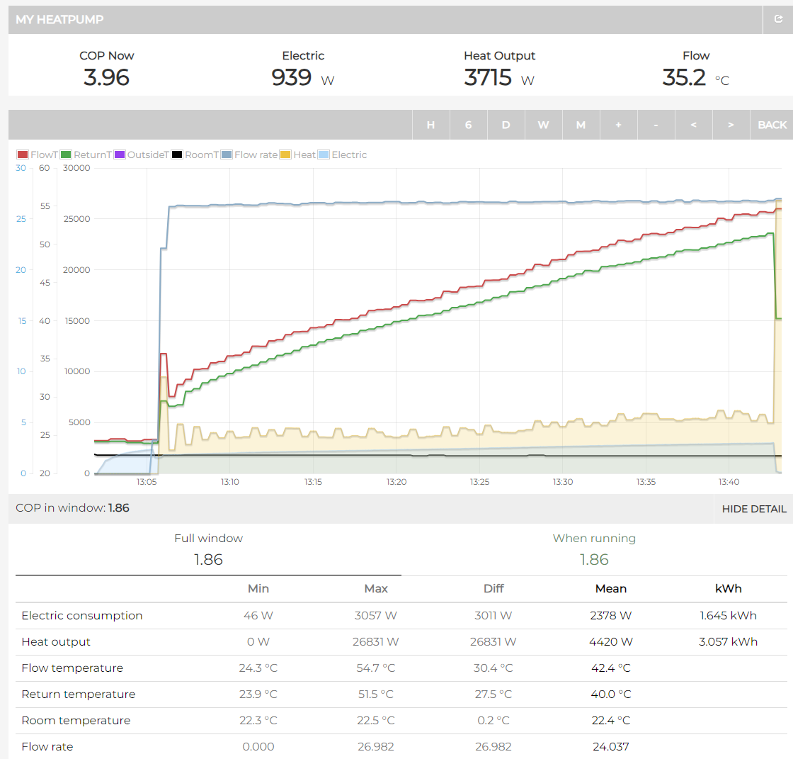

You are not mad, I think this is a tricky heat pump to deal with. I say this because of its limited range of operation and what feels like an eternity to settle down into a steady state of operation. It may just be me and my house but I am still convinced there is something wrong with it, great at times and difficult to understand at others.
My main issue at the moment is DHW production is inconsistent and I suffer a decaying flow temperature regularly, particularly when resuming heating after a DHW cycle. Maybe @marko has an idea? I don’t know why but my gut feeling is a lack of refrigerant or some problem in that area. At times I cannot get the flow temperature to increase at all, it just reduces even though I am using a fixed flow temperature and requesting an increase.
Concentrating on COP alone, at the lower heat outputs we are limited by the minimum electrical heat input of around 900w, that means at a COP of 5, which I get sometimes, the heat output is 4,500w, a lot for a house my size and with my heat loss.
If you can get the heat pump to operate like this then you just have to accept the heat.
Running for shorter periods is OK and stops the house heating up too much but you are always operating in the most inefficient phase of the heating cycle, COP will always be lower than it could ideally be.
Thinking of radiator sizes, to run at 35c flow with a delta t of 10c between mean flow temperature of around 32c and room of 22c you need about 38kW (at dT 50c) of radiators to accommodate the heat output. I had about 18kW of radiators after the install. My house was warm enough at 35c flow or below but the COP was bad.
I needed to run at around 42c flow to get a COP of around 3.5, but then the heat output is higher and my house got hotter which then diminishes the heat output of the radiators.
Once the heat pump can no longer get rid of the heat produced it has to cycle.
I guess that is what you are experiencing.

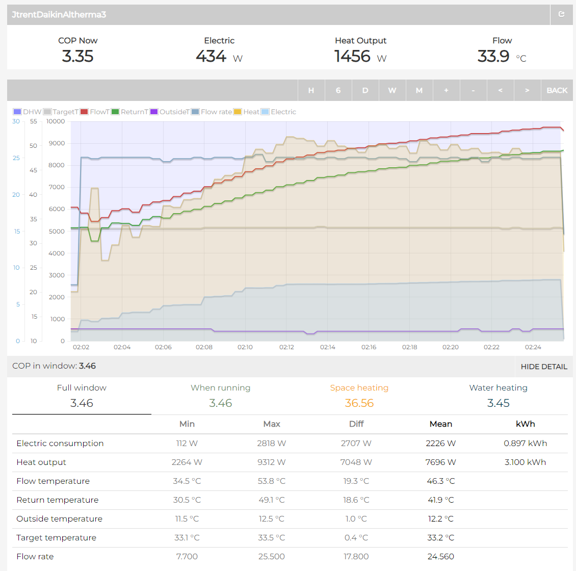

I have the EDLA 4/6/8 and can confirm it trucks along with the compressor on 24/7 pulling 4-450w at the minimum flow rate. It’s neat.
https://emoncms.org/app/view?name=JtrentDaikinAltherma3&readkey=9ce13d5a95943eb1e95f03e12efe2a89
I have some inefficiencies in my system but that’s mainly because we’re living in a property we are in the process of renovating - I only have about 2/3 of my heating system in. It makes it hard to get the delta T above 4 (wants to be at 5 for my system) so affects the COP. House is lovely and warm though. In mild weather (11c or so) It’s getting 4.5-4.8. Tonight it’s definitely acting up, its running constantly as I’d like it to but struggling to shed enough heat.
Interesting you say the three units are the same mechanically - I had heard that as a rumour but wasn’t sure it was true.

Jordan’s DHW is very different to mine.
The COP is miles better but so is the heat output, it’s not what you would expect to see from a 9kW heat pump My run took 45 minutes and my maximum heat output at the end is 6.3kW, it’s even less early in the run. And my flow rate is higher.
Mine
And this is Jordan’s, quite a difference,
