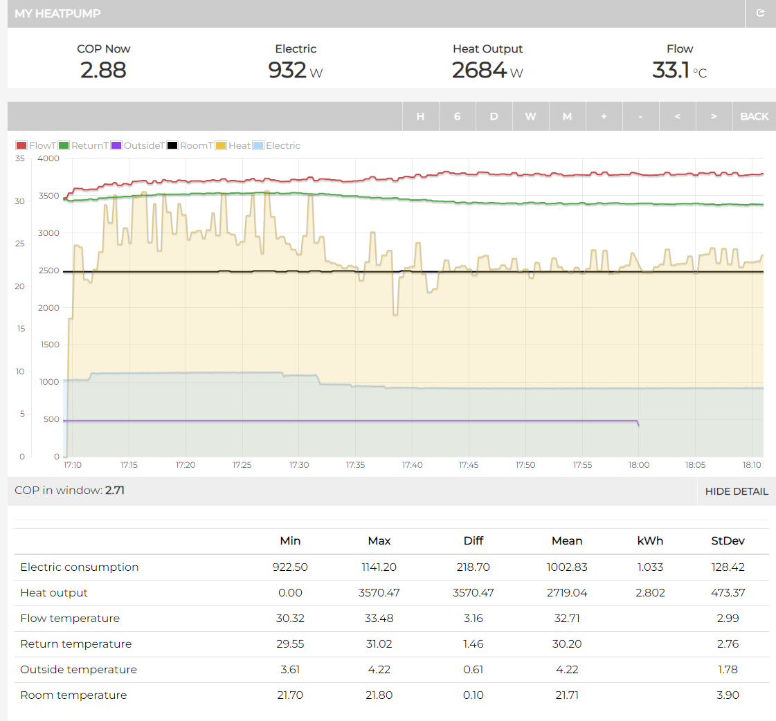

This is the last hour, my internal temperature is steady and my heat loss is therefore 2.8kW with 21.7c indoors and 4.2c outside.
You are a smart person, can you see how my heat loss could ever be 7.4kW? at 21c indoors and -2.3c outside?
And because I have this heat pump I am running at the lowest possible electrical input and can only achieve a COP of 2.71
Can anybody honestly say I have the correct heat pump? And yes, I am sitting in my conservatory typing this in a t-shirt!
Can you turn the heat pump off manually and put it back on when the room temp drops below 20-21?
Or is the daikin so poor at restarting a new cycle that the performance is worse!? Cant be worse than 2.7 though right?

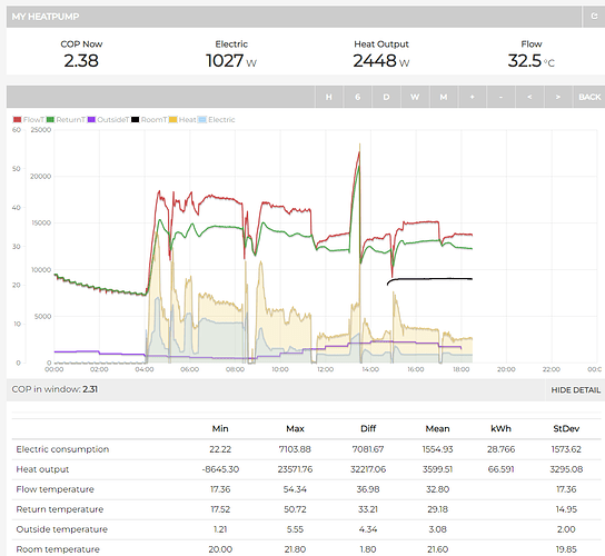

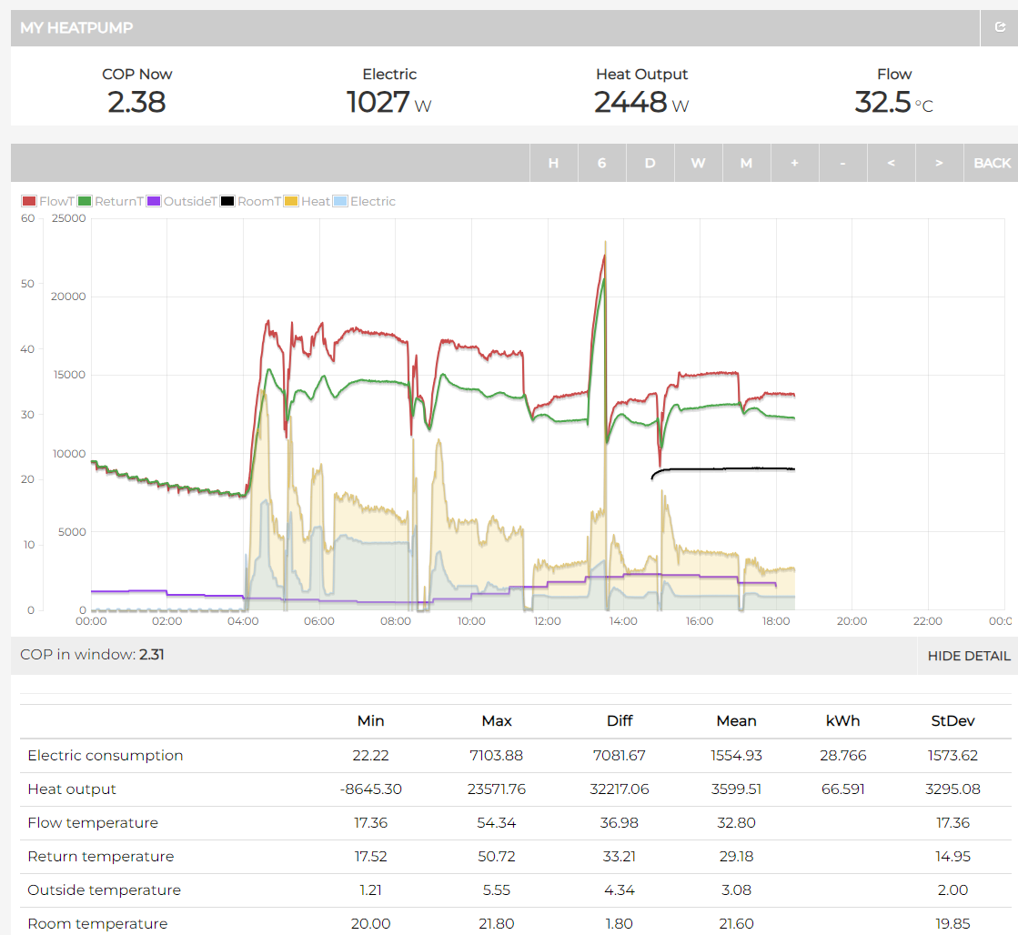

I wonder if anybody could say that it was reasonable for a heat pump to be running at a flow temperature of 32.5c and only return a COP of 2.31.
Does any other heat pump do that?
I am producing exactly the amount of heat the house needs, the radiators are not holding it back, it is the Madoka room temperature setting, it is close to the requested value and so I think it is holding back the heat output.
However, it continues to consume just as much electricity.
It is not bothering me, it just seems like an odd design and is just further evidence that the heat pump is too big for the house.
Yes it’s strange. I have noticed sometimes that if I drop the flow temp on my system that you get a period of low performance while the system volume cools down to the lower flow temperatures, the cop will then start to edge back up again. Not much evidence of it recovering on your run 17:10 to 19:10 so will have to put that down to a daikin ebla range peculiarity …
