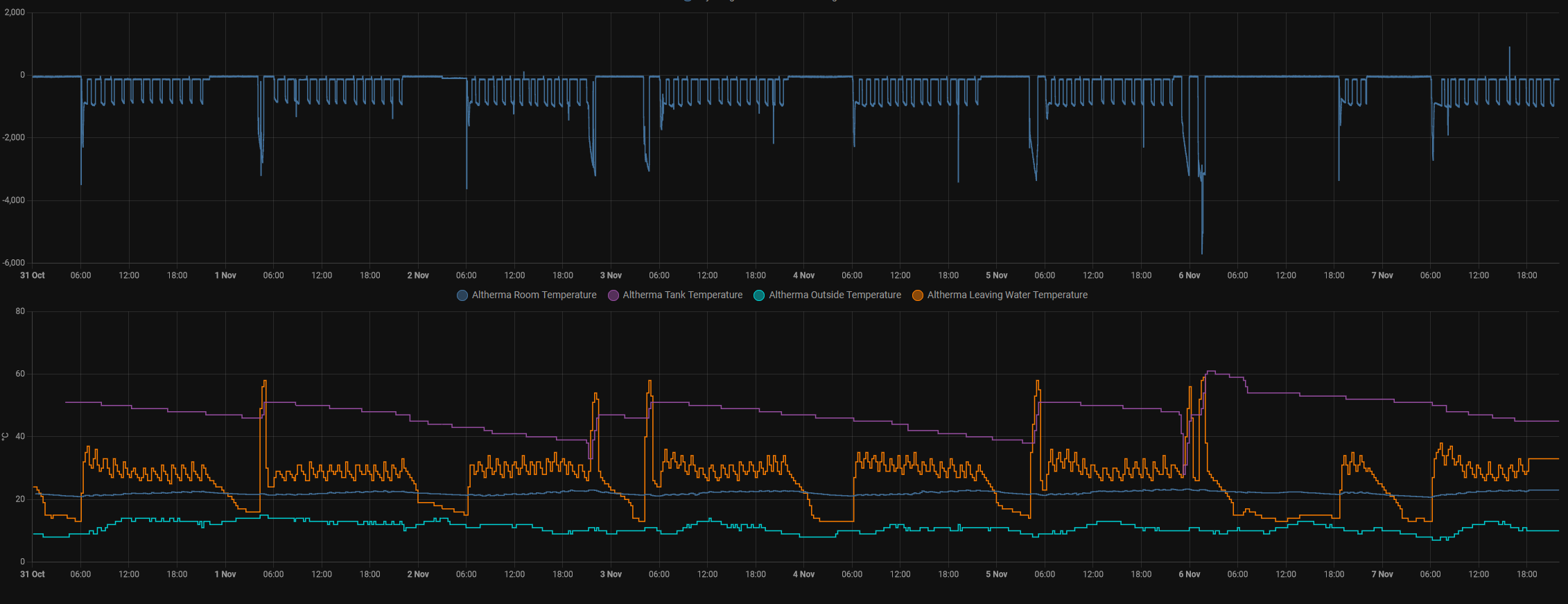

My heat pump is too big, what should I do?
Ref the last point I just don’t have all my emitters/load in so it just can’t give off enough heat yet - we are mod a deep renovation and living here. The house had no serviceable heating system when we moved in so had the heat pump from day one back in July.
I think that’s some good thinking there and as you say it’s better the beast you know.
For supplemental info, I have a 250L cylinder, primary pipework is 28mm and unit is about 10m from cylinder. Setpoint is 45c
Hi Jordan,
Looking at your data I would guess that the heat output has fallen as the flow temperature has.
You are running a WD curve?
The flow temperature has fallen as it gets colder outside, presumably you have played with it or have it set back?
One big difference between the 8 and the 9 is how low the circulation pump will run.
The 8 seems to go to at least 7lpm whereas mine will only go as low as 10lpm.
If mine went to 7lpm I would get the dT of 8c I am looking for in the fixed radiator setting.
I have seen pictures of the circulation pump in the 9kW and it says it can go to a very low level, presumably Daikin have software limited it to 10lpm as that is probably the minimum you would ever need in a house the correct size for this heat pump.
I can’t think of any other reason why my circulation pump won’t run slower to achieve the dT of 8c.
It’s on a very shallow curve and yes I’m always messing with it as you can imagine - I lowered the curve this evening to try and negate some of the issues of having less emitters on my system for the time being.
Would be good to get ESPaltherma on your system - it helped me understand the circulation pump better. It spits out a value which gives you an idea of pump speed rather than just flow rate.
Does the manual say it requires 10l/pm for heating? Mine says it requires minimum 6l/pm for heating so I think that’s why it sits around there.

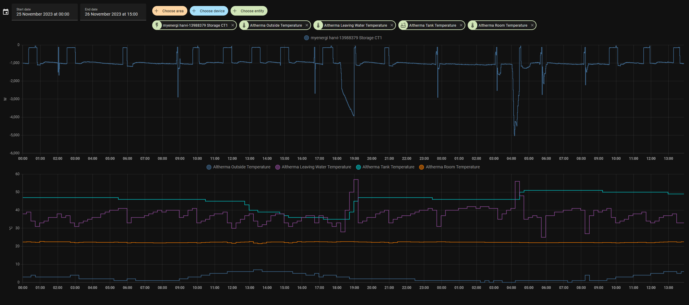

Hi @matt-drummer & @Rob-G,
For DWH the temperature of the water inside makes a massive difference. I can monitor the tank side of mine very precisely as I have a Mixergy tank (with the main difference than yours is the Plate Heat Exchanger (PHE) + pump stirs the tank up when running a cycle)
I generally only heat mine when the tank is stone cold almost top to bottom, having done testing in my first year even without ESPAltherma I have now.
Poor DWH heating efficiency was more directly linked to the state of the tank pre-heating. Others on here have seen similar.
I stopped doing a mid afternoon DWH cycle and now use the Mixergy top immersion for volumetric (e.g. 5%) top up (which uses their volumetric top up pump) during the evening if we run out as I use less input electricity as only heat what is actually needed, and also the space heating can carry on at hopefully a decent CoP rather than stop/starting.
Sufficiency beats efficiency in this case for me personally.
Back to yours:
A few things people should probably (start?) worth noting for correlation of DWH CoP:
  1. What is the tank temperature?
  2. Estimate of % hot water left which I get is harder on a traditional tank setup, but might be possible to get a good idea (this then will give an idea of how much “cold water” is in the tank to heat
  3. Are you running reheat (great for always having hot water, but I believe quite poor for efficiency), or schedule - and how does the schedule co-inside with usage?

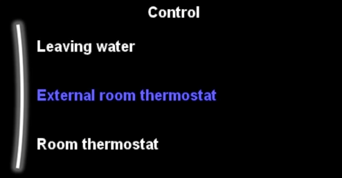

Has anyone tried the pure weather compensation mode in the control menu(Leaving Water rather than Room thermostat) that is supposed to be the most efficient?
In theory this should stop the problem I was having with the room stat shutting the heating off before the north facing rooms get up to temp.
Yes I do.
The other parameter you need to configure is Overshoot
4C overshoot mitigates cycling, and will inform your weather curve is tight/shallow enough if you keep going into the overshoot temp.
