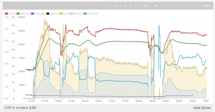

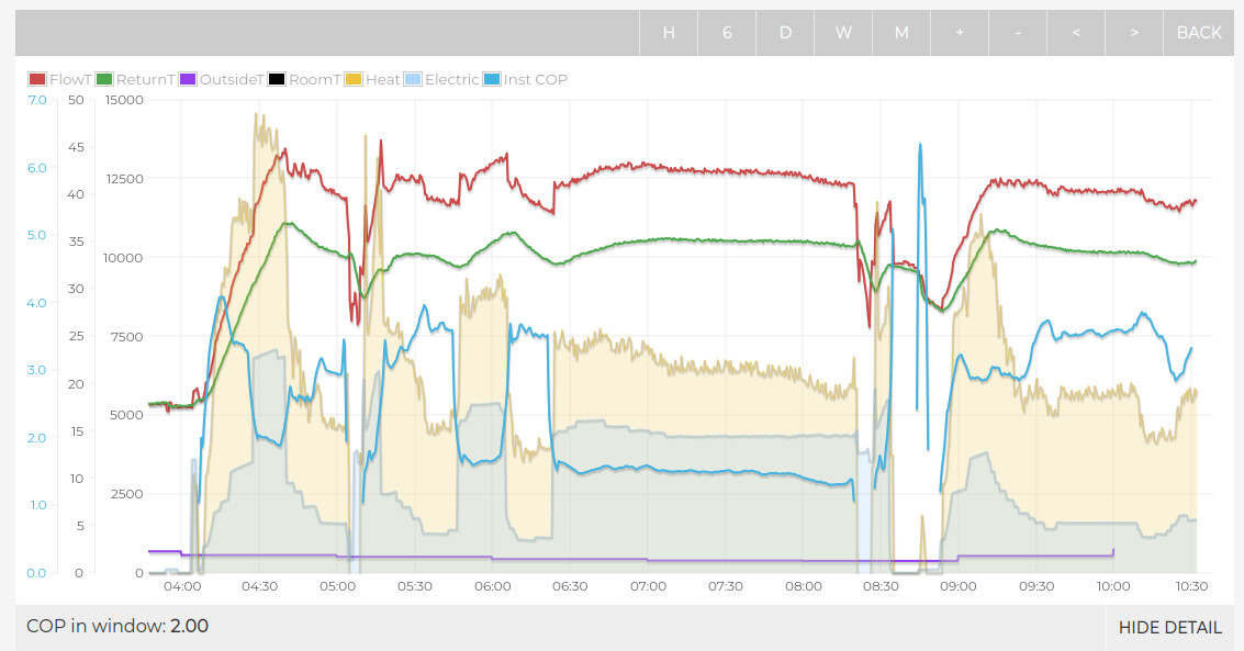

It looks like your input processing in emoncms.org is linked to the data coming from the meter on your backup heater and so when you turned it off those inputs stopped updating. Do you want me to fix it for you?
I can also fix what would otherwise be a small gap in your data if you want? e.g between the time you switched off the meter and the point we reconfigure the inputs…
Hi Trystan,
I’m not sure I understand.
The booster and back up heaters show up separately in my feeds and they are reporting correctly.
The booster is on electricity 2 and the back up is on electricity 3
The heat pump itself is on the first electricity feed and the circulation pump is being reported and that has always been reported on the first electricity feed along with the normal consumption.
I thought they were three completely separate feeds, how can the booster and back up affect the others, I never see any back up heater use normally.
If you can fix though that would be great thank you
Wow that’s incredible isn’t it! To think how many other systems out there have this backup heater coming on :sob: Look at the COP jump up now (All fixed for you)
The inputs for these had stopped, I assume because turning off the circuits turned off the SDM120 meters themselves.
Thank you @TrystanLea

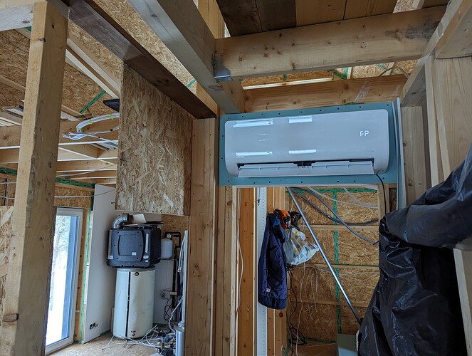

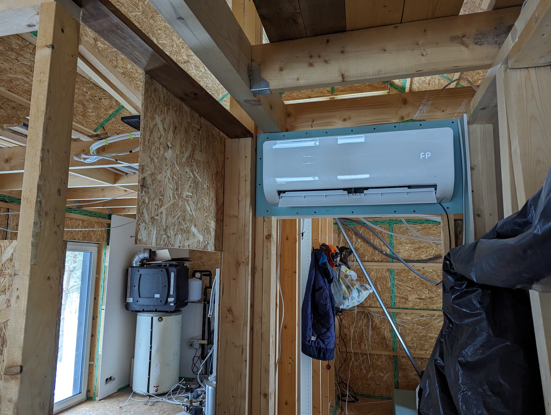

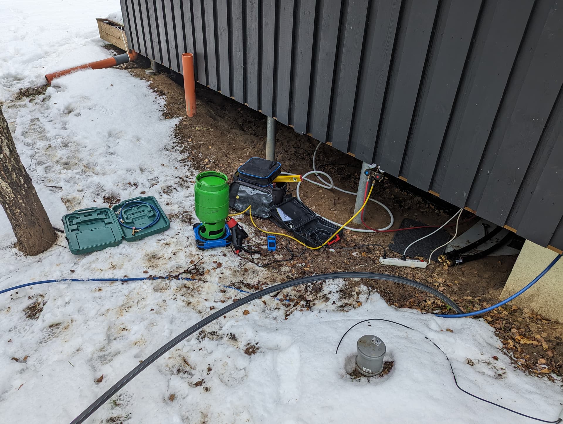

*Today’s job here is getting the ground loop filled and trying to get the heat pump proper running whilst the car can still get vaguely near.
In the interim a little (9k BTU; €600) AC is in. Set to “30” overnight as an experiment (ambient is averaging around 0C over 24 hrs) the poor little thing spends 20 mins of every hour defrosting. It gets the place to 25C though and would probably keep doing 20C internal down to say -10C.
Why the heck am I fitting this ground source unit I ask myself sometimes. Partly was £600 on eBay and that’s not far off what an invented cylinder costs. Partly comfort of rads vs air movement (though it has to be said that in a well insulated place you need so little heat that a 9000 BTU class unit isn’t like sitting between a hairdryer and the fridge like it is in typical British houses). Mostly lack of experience and trust with the a2a units until now.
