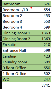

Sorry, that’s my mistake I just pasted the other table again.
Here is the correct table I must be getting tired.
I will see if I can correct the other post.

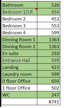

Here is the full radiator schedule.
That is 5,381w of radiators open at dt 30c.
That is 10.5kW at dT 50c
So at dT 15C they will put out about 2.2kW of heat.
Nowhere near enough.
That is why you have problems.
It may be even worse.
I included your dining room twice at 1,363w but I think that is the total?
Obviously I don’t know the layout of your house but there is no lounge or kitchen?
Is the dining room everything, your lounge, kitchen and dining room?
I think the output of your permanently open radiators is only 3.544w at dT 30c
That is 6,800w at dT 50c so at dT 15c it will only be 1,428w

No there are two radiators in the dining room.
The Dining room and kitchen are sort of open plan.
It’s not a perfect representation but here.
But the heat loss of that room is 1,1121w according to Octopus and the total radiator out put is 1,363w (512w and 851w)
That means that the radiator output from those highlighted in green on your chart is only 3,544w at dt 30c
It nothing like enough.
Going back to your heat loss, Octopus only have it at 1,121w but you have 2,334w
They do a funny thing when a room has more than one radiator, they include the heat loss multiple times but the radiator outputs individually.
You cannot get the heat loss Octopus used or calculated from the radiator schedule as it only includes heated areas, it is not necessarily the full heat loss they calculated and used to determine the size of the heat pump.

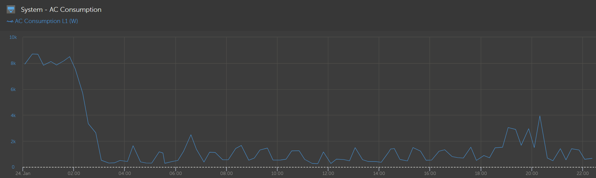

-3 to -4 leaving water temp was about 42-44 degrees varies a bit due to the overshoot.
I have a CT clamp on the power supply to the HP it’s not perfect and includes power for all the electronics and pump etc.
I also have a grid meter for my battery storage that monitors all power use on my property that monitors all power use and it seems to agree with the readings from the CT.
At -3c I needed about 1,400w minimum to run at 33c Average was about 1,600w during a cycle between defrosts and my defrosts are not so frequent at the low flow temperature.
I cannot see any way that you were running at 42c to 44c flow temperature and using 1kW of electricity.
It is the same heat pump and just not possible.
Mine is monitored with billing grade heat and electricity meters that are certified and beyond doubt.
I was just at a COP of 3 with 33c flow, you cannot be anywhere near a COP of 3 at those flow and outdoor temperatures, it’s impossible.

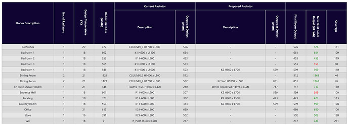

Heat pump - design report.pdf (323.7 KB)

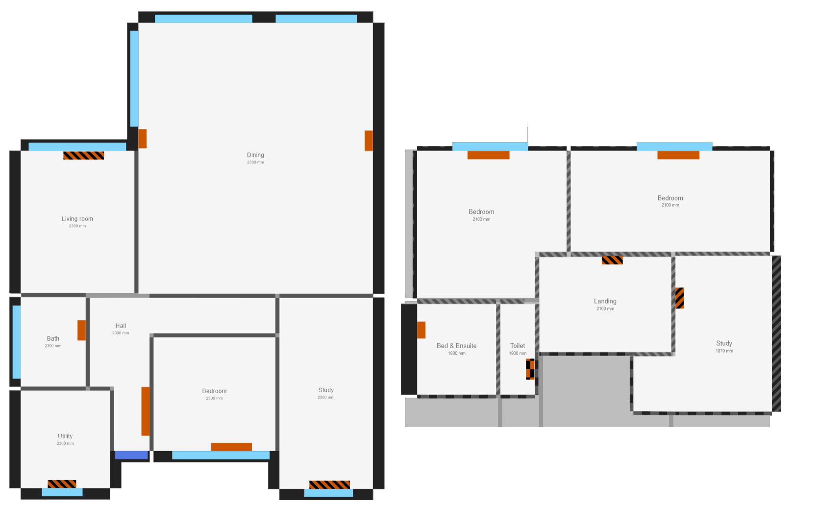

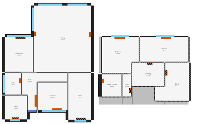

I entered the house as is with the radiators currently installed and let Heatpunk calculate the output based on flow temp.
All of the radiators below have the heat output values from the radiator schedule the ones highlighted in green I have removed the TRV’s. I have set the control mode on the heat pump to LWT not the room stat so it is running pure weather compensation.
Those are the heat output of the rads at 50c.
No matter what I do I just can’t see how I will get this heat pump to stop cycling other than making the house hotter than is bearable or opening windows to increase the heat loss it just wont modulate down low enough to provide the amount of heat needed to keep the right amount of energy in the water.
Hi Robert,
You have included the Dining Room radiators twice.
You only have 1,363w of radiators in total in that room.
Your total radiator output at dT50c is 7,885w from your Octopus radiator schedule.
It should be printed at the top right corner of that document?
I had just under 9kW of radiators at dt50c and I needed to run at a flow temperature of 42c to make the heat pump work. I just used a fixed lwt as you are doing.
So you will need to run at 43c to 44c I would imagine with all radiators working, if you close any then the flow temperature will need to be higher.
This means you just have to run the heat pump in short bursts when it is warmer outside.

Bottom line I believe the heat loss survey is wrong. I will have to try and get an independent in.
I think as you pointed out they counted the Dining room radiators twice.
Also I think they used the default ACH (Air change per hour) value.
The whole property was assessed on the basis of it being a 1970’s bungalow and takes no account of renovation or the build dates of the extensions.
However the whole top floor was a 2010 loft conversion which should have a much lower ACH.
If I adjust the top floor to reflect it is post 2006 it halves the heat loss for that floor.
In the software you can select the date the property was built and that adjusts the ACH which impacts the heat loss.
These are the figures for exactly the same property just with ACH set according to year built.
Pre 2000 =6615W @ -3
Post 2000 =5826W @ -3
Post 2006 =4464W @ -3
If I adjust the post 2006 for heat loss at +5c (just before the heat pump starts to cycle) I get a heat loss of 3130W so more or less the amount of heat the MMI/COP is telling me is being delivered.

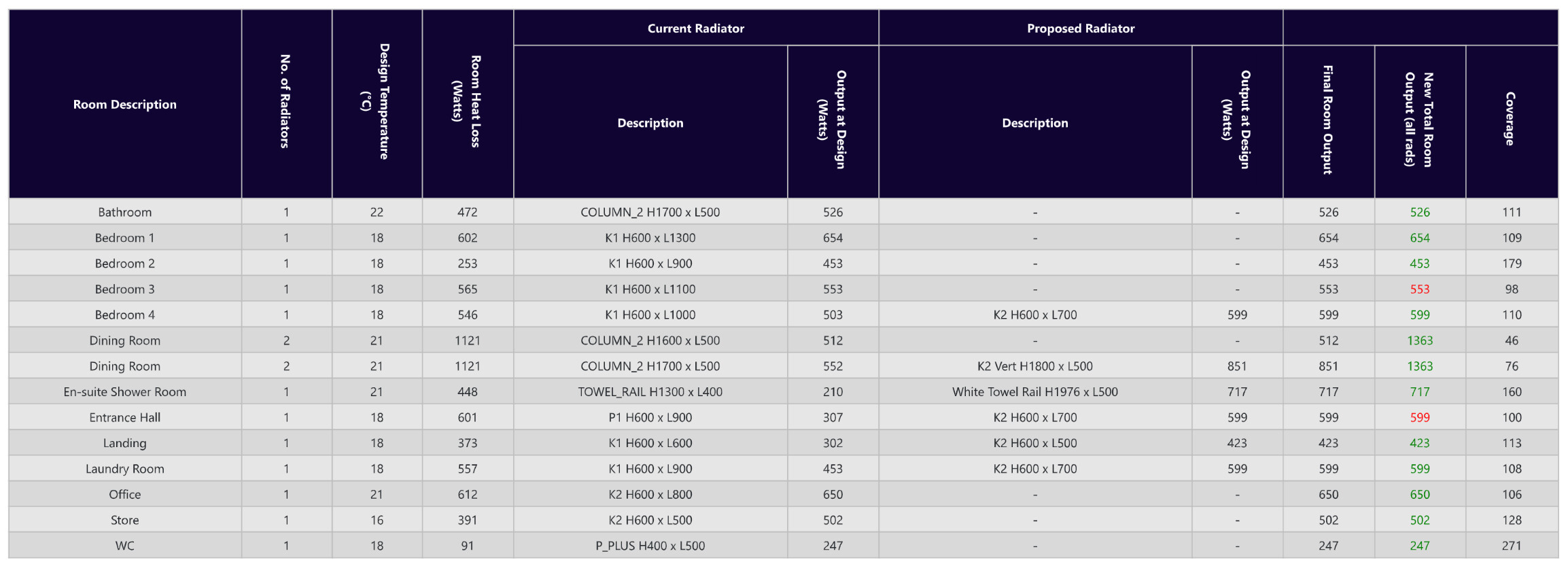

@Rob-G
Please have a look at the spreadsheet attached, it seems like most your system is ok but some rooms are quite a way off.
Rob-G_SystemOverview.xlsx (14.1 KB)
The spreadsheet (provided I have not fat fingered anything) shows you should have a design flow temperature of 54°c and a realistic minimum without cycling in the range of 40°c. (on the Madoka that would be 54@-2/3 and 40@15). You cannot really go much below 40°c as this is very close to the pumps minimum heat output of 4kw with your radiators.
Even at the design temperature of 50°c and with a slightly cooler bathroom some of your radiators would need to be balanced to a DT of 15-20. On a low temperature heating system this is not realistic and I have not been able to get above a dt10.
If you replace the heat pump (looks like you should have the EDLA08E2V3 personally) you would also need to look swap some of the radiators due to the unbalanced system (could discuss with Octopus if you want to argue it).
Providing you wish to have a 50°c flow temperature based on the octopus heat loss I would personally do the following.
  1. bathroom design temperature lowered to 20°c
  2. bedroom 2, store and WC radiators to be decreased in size to allow for correct system sizing and balancing.
  3. Office radiator to be increased or lower room design temperature to 20°c
Decreasing the radiators will impact the low end but unless you want to have the upheaval of re designing the system to 40°c or lower and replacing all of your radiators your options are somewhat limited.
you are welcome to copy this and re try with your heatpunk calculations but I ran out of time and wanted to get you something to have a look at.
Please remember I am just a system owner with access to excel and a load of automated mathematical formula, This spreadsheet is designed to be a helpful guide and I am not a hydronic engineer / system designer.
