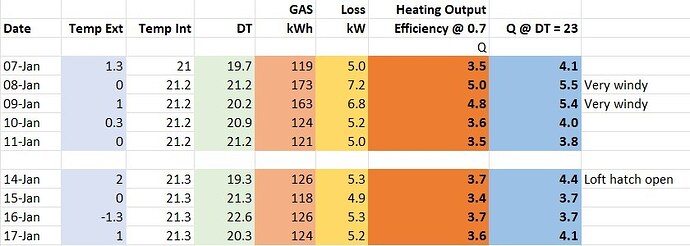

I’ve attempted to calculate my heat loss over the last couple of winters by recording my daily gas use.
My house is 170 m2.
I set the thermostat to a fixed value and left it at that over a number of days. I also removed all the TRV’s to get an idea of what temperature each room maintains.
The 2001 era non condensing boiler is controlled by a Tado device which cycles the boiler on and off meaning the flow temp ran between 40 and 50 deg when at -1 but cycling up and down. The outside temp actual varied between -4 and +1.
The Octopus survey came in at 9.3 kW
My Heatpunk survey, 7.9 kW (4.8 kW if changing the air change figure from 1.5 to 0.5)
My derived actual usage 4 kW (5.5 kW if you take stormy weather into account)
All the rooms maintained their design temperature during my data collection.
It will be interesting to see how receptive they will be to taking into account my energy usage data.

374 W pretty much matches my towel rail output at delta 30 and corresponds with that room maintaining temperature when it was -1 deg.
Based on the above I’d guess they will offer something like the 11 kW, which given the feedback I should not accept.

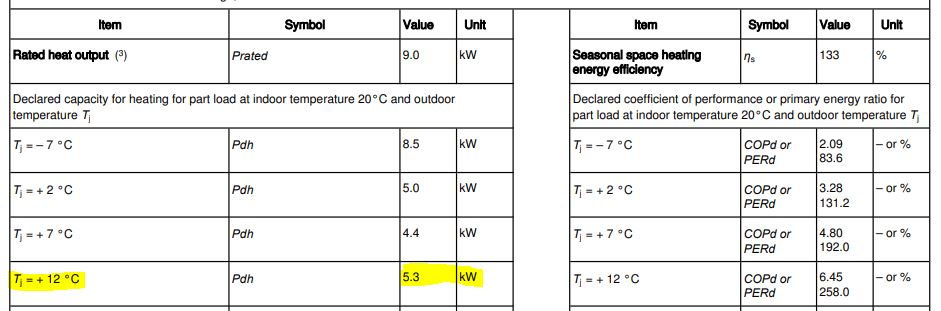

To return to the unclear information from Daikin regarding the minimum consumption of 950 Watt.
I now see in their documentation that they present the COP positively at part load, but at 12°C they do increase the output spectacularly to 5.3 kW to have a decent COP.
Not realistic at all.
At Toutdoor 12°C you should have ± 3kW heat output which gives a COP between 3.1 and 2.9 depending on the pump.

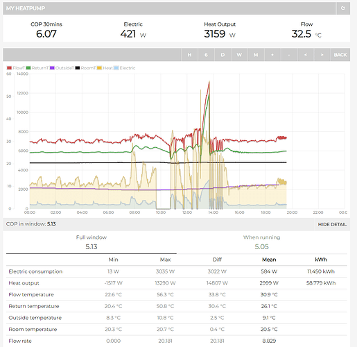

Congrats @matt-drummer you must be really happy with the performance of the new unit! this is looking great! your running at a much lower flow temp and more consistently and a substantial improvement in COP by the looks of it!
Thanks Trystan,
It is going quite well, really good when it is cold with minimal defrosting.
I am struggling a bit when it is warmer to find settings that work. Daikin’s initial phase of the heating cycle is quite aggressive in terms of flow rate, I can restrict it like I did with the 9kW but that causes other problems.
I just get more heat than the radiators can handle at really low flow temperatures.
But all in all, a huge improvement, it uses half the electricity and I don’t have to open doors and windows.
