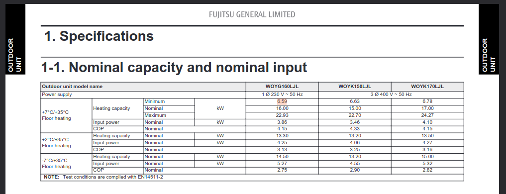

Anyhow he said that the Fujitsu pump can modulate from 16kW down to 2kW output so It can’t possibly be over rated for the job.

You could also try validating the modulation claim, does it really modulate down to 2 kW that’s an unusually large modulation range… If this is the right datasheet https://www.fujitsuklima.hu/vmfiles/attachments/Tervezési_segédlet_Waterstage_SuperHP_HMV_1f_3f_2020.pdf it suggests 6.6 kW heat output, which is roughly 40% of the badge output which is closer to the kind of minimum modulation range that we expect.

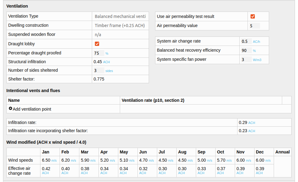

On the heat loss side of things can you share your calculation, I’d be happy to have a quick look over it. What air change rate did you assume, I assume this is not MVHR?

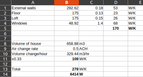

My heat loss calculations.
I added up total wall area of the house externally minus windows and doors = 292.62 sq m @ U-value 0.18
added the ground floor 175 sq m @ U-value 0.13
and the loft area =175sq m @ U-value 0.15
windows and doors = 48.92 sq m @ U-value 1.4
totaling this gives me 150.74
adding Infiltration Heat loss =Volume of whole house(658.88cu m) *.05 = 32.94
equals 183.69
Multiply that by 22 which gives 4041w
I’ve added 10% for initial heat up period which I’m not sure I need, as this calc derives from my old house with an oil boiler
this gives 4445w divided by 1000 = 4.445 kw
than added 0.87 for hot water to make a total heat loss of 5.32 Kw/Hr. max required boiler output

How did you get .05 here? Is that taking into account MVHR recovery efficiency somehow?
I guess either way the heat loss is still very low and this is heat loss before internal gains (heat given off my electric appliances 200-400W worth, heat from body heat 4 people 240W, solar gains on the coldest day is likely very low).

Do you think my calculations were correct apart from that?
Also you sent a link to Fujitsu’s Specifications but I could not find anywhere where it mentions the modulation range being from 16 down to ? I would love to be able to show the builder that they are claiming a modulation range that is wrong or even better that they are correct because maybe then I would not have to worry.

I guess if we’re going for ballpark calculation and there’s no MVHR:
For MVHR it depends on the recovery efficiency and infiltration test result, you could use the calculation in the ventilation section of SAPjs (based on SAP 2012 method) together with a blower door test result value to give an estimate of winter ACH: E.g achieving 5 m3/hr/m2@50pa (building regs <=8 I think Part L Building Regulations: What is the 2022 Update? - Building Energy Experts ?) and 90% recovery results in 0.42 ACH effective air change rate in terms of heat loss in January: https://openenergymonitor.org/sapjs/
Page 7: Heating capacity > Minimum: 6.59 kW
It would be worth double checking the actual model number of the proposed heat pump as this datasheet may not be the right one…
It might be when they say it modulates down to 2kW they meant 2kW electricity input, which would probably align with the 6.5kW minimum output.
