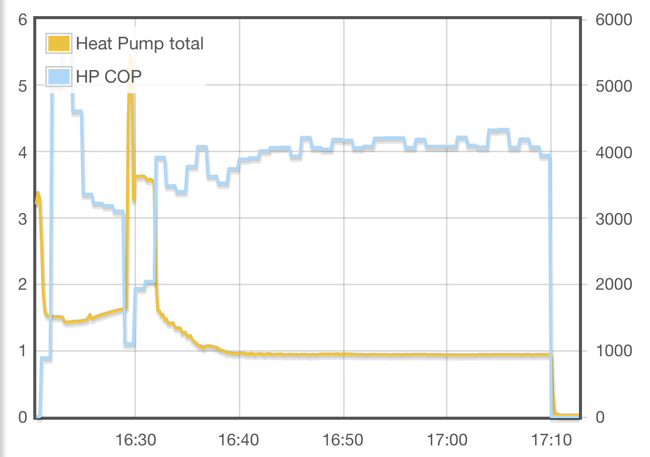

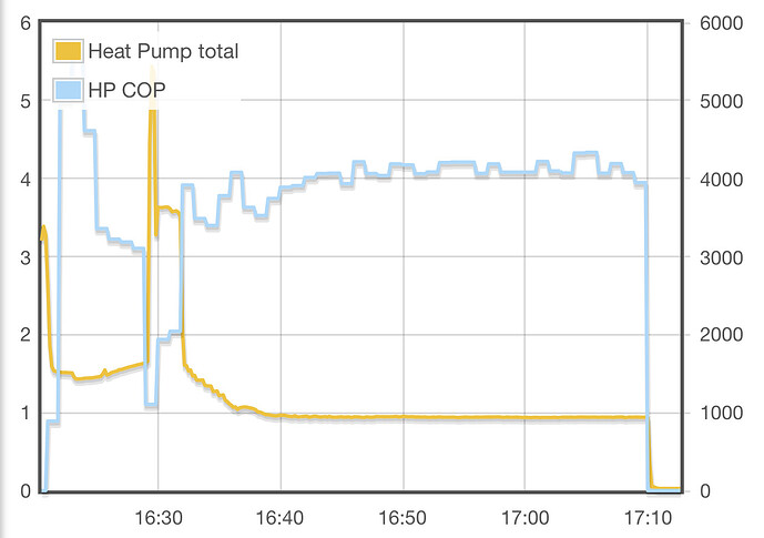

Hi there. Yes I am monitoring the COP in real time using an Emonpi2 that I installed a couple of months ago. The Daikin does measure the overall energy consumed versus energy used so you can calculate the SCOP, but doesnāt give instantaneous COP.
My system has long pipe runs and uses a buffer tank and separate circulator pump for the CH and I wanted to calculate the COP of the actual heat going into the house rather than the nominal efficiency of the HO itself. So I installed temperature probes on the flow and return from/to the buffer tank. These are monitored every minute by the Emonpi2 and also calculates the DeltaT by subtracting return from flow temperature.
The circulator pump is a Wilo operating at a fixed speed when running, and the volume it pumps is displayed on the pump - just have to convert from m3/hour to litres/s. According to Sczimon from Urban Plumbers the Wilo is fairly accurate. So taking the volume (l/s) multiplied by DeltaT multiplied by 4.2 (specific heat capacity of water) the Emonpi2 calculates the heat output (kW) of the HP after the buffer. The COP then just the heat output (kW) divided by the electrical input (kW).
Thereās also a calculation to determine if the heat pump is running or idle - where it still consumes 25 watts so I donāt record silly COP numbers when itās actually not doing anything but thereās still a DeltaT.
The actual COP obviously depends on the weather etc. but Iām getting values between 3 and 4.5, which seems reasonable.
Hereās an example from yesterday afternoon. You can see that there are big spikes on the heat pump consumption (yellow line, right-hand scale) when it decides to run the auxiliary heater for one minute a couple of times - still something wrong with the setup there I think - it should have more patience! The COP is in blue using the left hand scale. You can see it settles down to about 900 watts input and COP of 4. It switches off when the room temperature reaches the objective for the evening.
