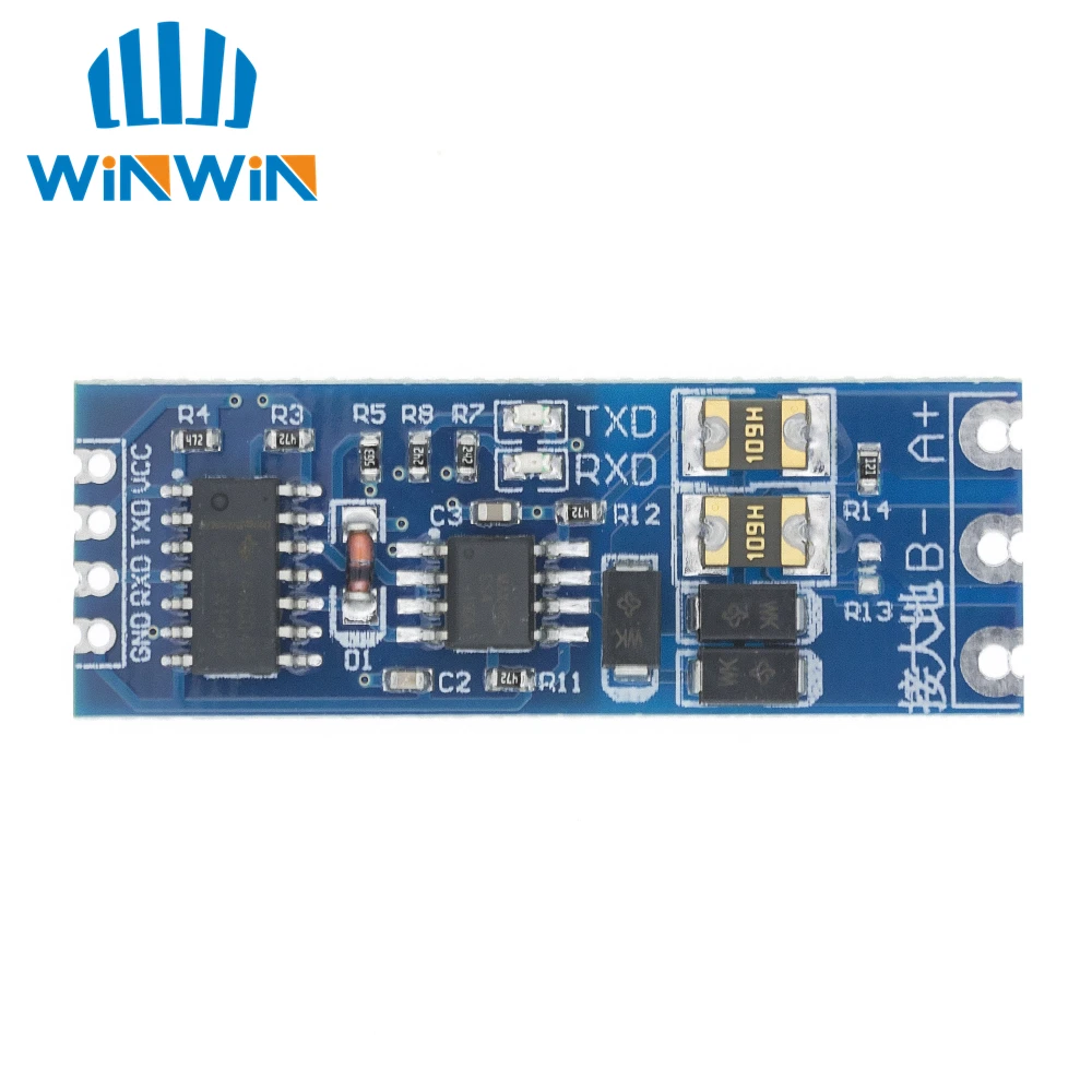

Yes, you will need a Modbus to TTL interface to use it with an Arduino.
Something like this:
