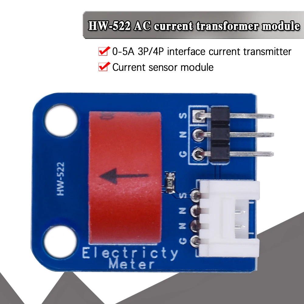

Also I visited local electronics shop and all they could offer me is a 250VAC to 9VAC 0.2A transformer in a PCB mounting package. No CTs and nothing remotely matching ZMPT107 specs.
So I’m doing my shopping on aliexpress :frowning:
But then I found a this with a description:
and a description http://henrysbench.capnfatz.com/henrys-bench/arduino-current-measurements/ta12-100-arduino-ac-current-sensor-tutorial/
Does it matter that they are using it for 120V?
It’s just a ct and a resistor connected to an analog input and ground in parallel.

That appears to be YHDC 5 A : 5 mA c.t. with a 200 Ω burden. It replaces the jack socket and the 22 R resistor on the Boardman diagram.
But in the process of checking exactly what you have there, I noticed that the YHDC TA12-200, which is a 5 A : 2.5 mA c.t., has a maximum burden value of 800 Ω. That would give you 2 V rms at 5 A, more than enough for a 5 V Arduino if you are using the full 5 A (you’d need a burden of 620 Ω to give you a small safety margin) but would read a maximum of about 4 A with the 800 Ω burden (again allowing a safety margin).
