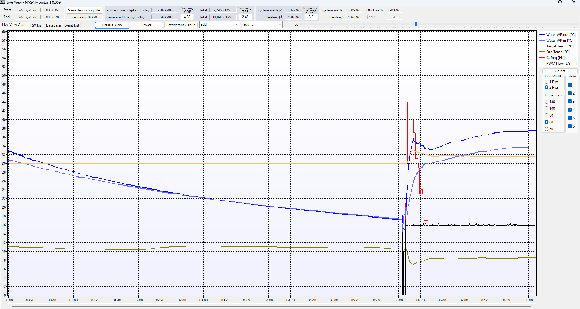

Nearly - I turned ours off one evening a week or so ago.
Outside temp was 5.2c increasing to 5.4c, heating was off for 45 minutes and lost 0.5c in the sitting room. Luckily, Mrs D didn’t complain.
On restarting it took an hour to return to the fairly flat line consumption and in that hour used 2.05kWh whereas in the hour prior to turning it off it used 1.72kWh.
So it’s more economical to do this but I’m happy to leave it running 24/7 as it’s easier, more comfy and it doesn’t cost much more in the grand scheme of things.
I agree with your point……….whilst efficiency is a big factor, I like the way my system is running right now, it has now arrived in the “ASHP ball park” and that fact alone takes the pressure off me, before I was constantly fiddling with Room stats and balancing Radiators etc etc . Right now I can sit back and carry out some minor tweaks and monitor the effects via the software tools and room temps.
I am favouring this constant ON approach, as it seems to be giving me a steady water outlet temp and therefore providing a steady heat to the house.
It was only my observation today that the actual Water Outlet Temp appeared to go no lower than about 39c…………the OAT today was around 10c……and the WL Setpoint was around 36c.
So I was interested to find out why for a WL setpoint of 36c the actual LW stayed up at 39c?

Hi Mike,
I switched everything OFF last night by setting T-Stat to 18c, as all rooms were around 22c and I was interested to see a start sequence from 06:00 this morning.
I also changed 2022 & 2032 down from 35c to 30c to see if that helped for the current weather condition of OAT 10c.
Also to confirm, I only have 1 Heating Zone (house with radiators only, no UFH) and I only use 2091, which as you surmised is set to 1 ,so that the Compressor runs constantly until Thermostat disables it. The rapid cycling I had before when this was not set to 1 was not good, so I will stick with this setting for sure.

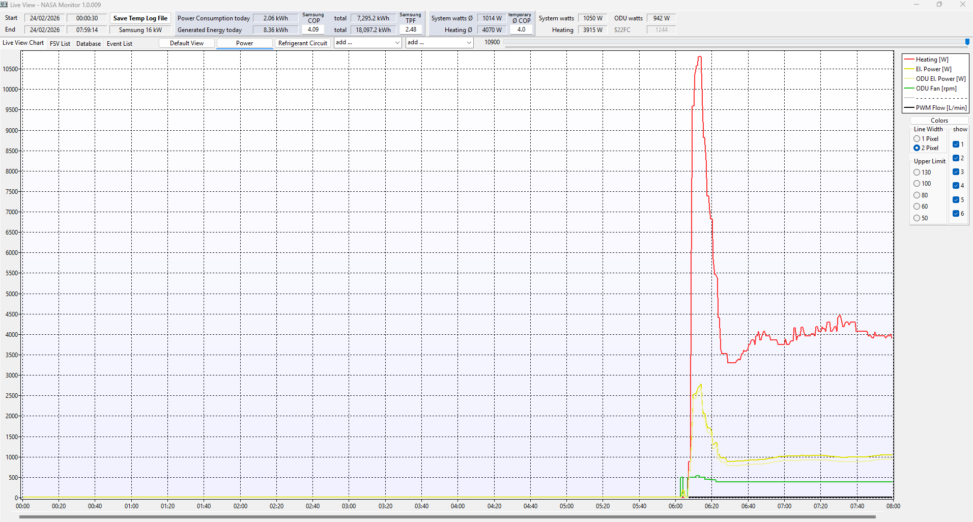

As of yesterday, I am using about 1kW of electric power and getting about 4kW of heating power.
You can see how things happened this morning.
It looks like the Water Outlet Temp was gradually rising, although seems to have steadied at around 37c, but maybe still gradually climbing, I think it was a similar situation yesterday.
Hi David, I think that confirms that your emitters are the problem. They are unable to emit the minimum heat output (around 4 kW) unless the LWT is 37°C or more. One possibility is that your TRV‘s are shutting off and restricting the amount of emitters surface area. I believe that it is better to balance the radiators, so that all the rooms are at the desired temperature, rather than using TRVs. It may be worth turning all the TRV’s to maximum position to see what affect this has on your minimum LWT during this mild weather. Ideally, the radiators should be balanced, so that all the rooms are at the desired temperature using Weather compensation alone.
It may be worth turning all the TRV‘s to maximum position to see what affect this has on your minimum LWT.
The other possibility is that you have a buffer tank. If that is the case, your radiators may be seeing a totally different LWT to the one that you are monitoring.

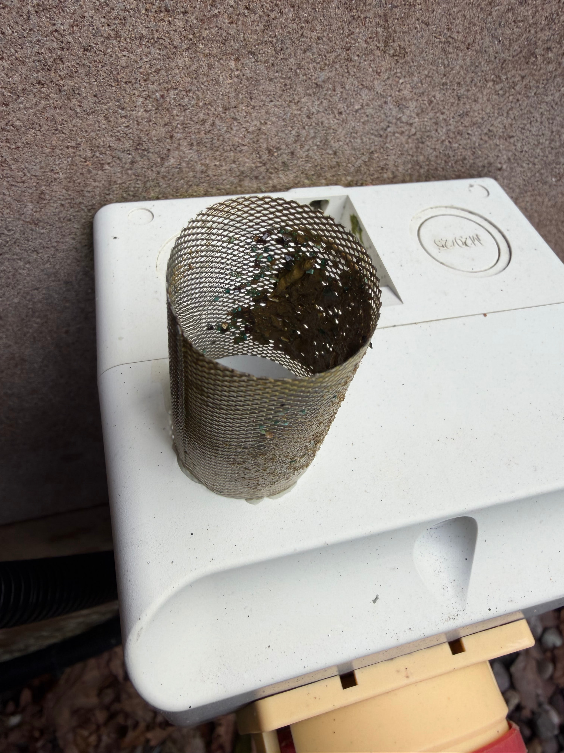

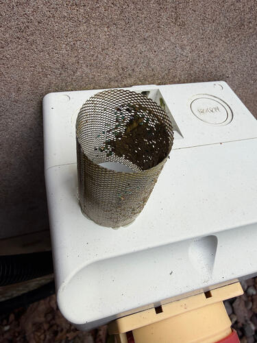

I’ve just quickly checked the Strainer to make sure it’s clean and found it was a little bit blocked, so I’ve given it a clean, also checked the MAG filter and gave that a clean too, just to be sure ASHP main circuit Flow rates are not being affected.
I have the same Samsung heat pump, except mine is the 12kW model, which is actually a top end limited 16kW model like yours. Ours behave identically at minimum output.
You are spot on with much of your assumptions. I too see minimum power draw of around 1kW (I think it’s closer to 800W for the outdoor unit, excluding circulation pumps etc), which equates to ~4kW of heat output.
Now some very basic physics - when running in #2091 = 1 mode (i.e, always on, no compressor cycling), the heat pump will continuously output a minimum of around 4kW. You may ask for a flow temp of 30C, but that 4kW of heat has to go somewhere. If your radiators are unable to emit 4kW of heat at the requested 30C flow temp, the water returning to the heat pump will not have lost sufficient heat, and when an additional 4kW of heat is added, the net result is the water circulating in the system will continue to rise, until it reaches an equilibrium point where the emitters can emit heat at the same rate heat being added (produced). For your system, this appears to correspond to a flow temperature of 39C. On my system this is around 33C at OAT of 10C (which simply implies my emitters are bigger than yours)
There are only two ways you can run lower flow temperatures:
  1. Install bigger emitters (radiators) that can dissipate the heat produced at lower flow temperatures
  2. Cycle the heat pump on/off allowing the circulating water time to cool.
You should be able to look up the output of your radiators (commonly given at dT 50C), and correct these value for any given flow temperature). Doing this is a spreadsheet should show that your radiators are capable of emitting ~4kW when the flow temp is 39C, which essentially just confirms what you are already observing.
Having such a spreadsheet is also useful for showing you the effect of any potential radiator upgrades, as you will be able to see the affect on flow temperatures those upgrades will make.

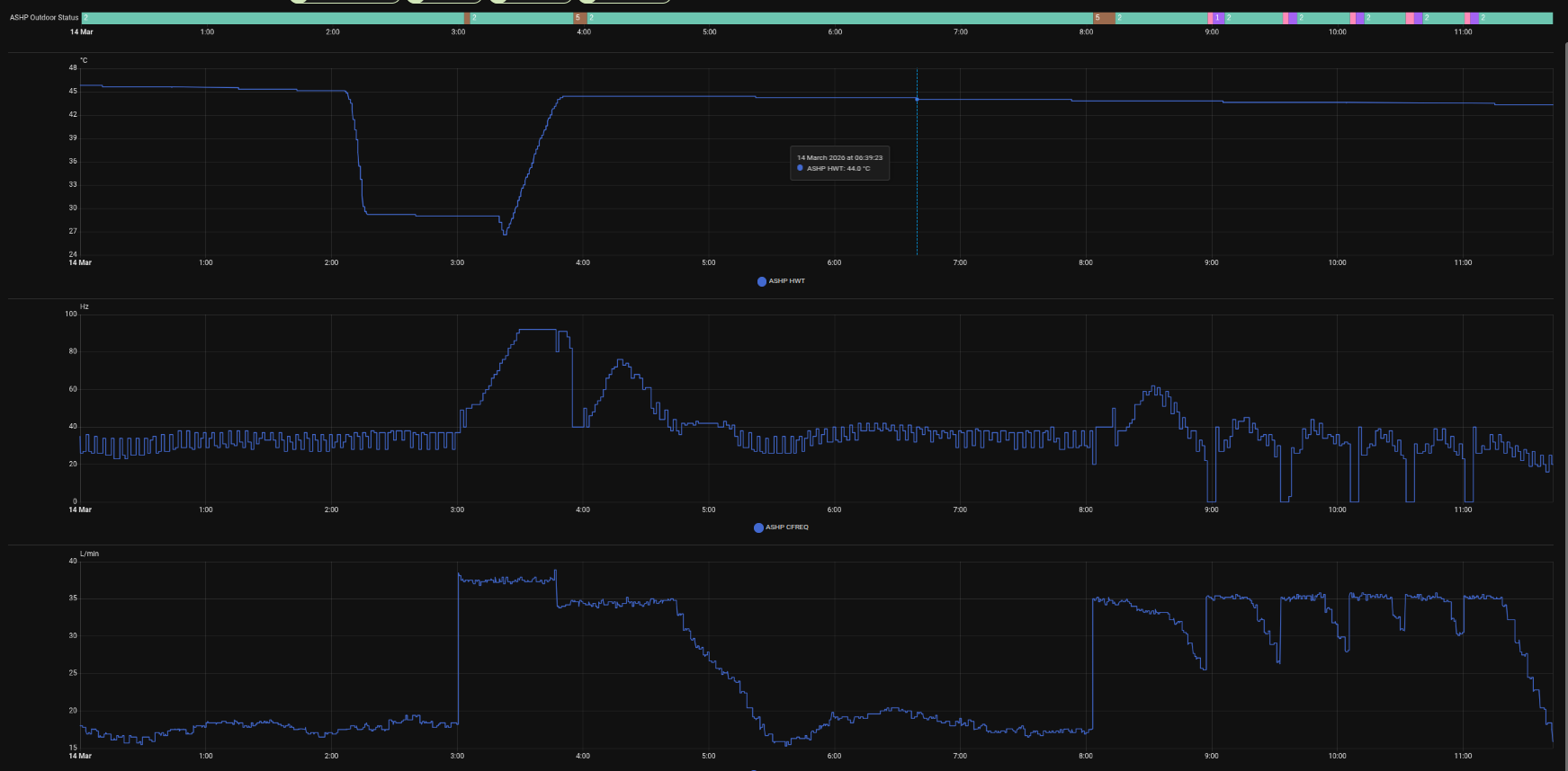

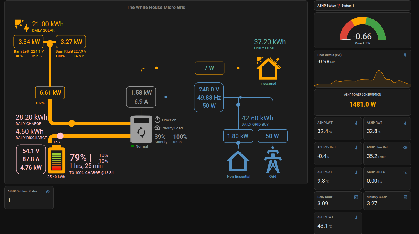

Don’t want to hijack this thread but I am new owner of a Samsung Gen7 AE160CXYBEK Integrated unit. It seems to be behaving a bit weird. it is set on Auto with only 1 DHW schedule at 3-4AM to boost the DHW up for the coming day. The temp last night got pretty low and the pump did weird things. As you can see it dumped all our HW around 2 and then didn’t have time to make it back up. Then it is cycling between off safety normal this morning also goes negavie COP quie a bit this morning. Running th epump at 100% for a loing time and strpping th heat it put in out. Can’t really understand the behaviour. OAT Temp has come back up this morning to around 9 degrees.
Its electrical use was very high and remains elevated. Heres a pic of its behaviour from midnight to now.
Just hoping someone recognises this behaviour and how to deal with it as it has been super wasteful using a lot of energy for no gain.
It is using water law fully with a setting of 4 for #2093 suing the satandard Samsung 15 35 -10 50 profile.
I monitor it using teh Modbus card and a Waveshare RS485 to ETH (B) POE device.
Here is it is dumping the heat out of the house. It has gone into standby but he pump is running full out and stripping heat.
