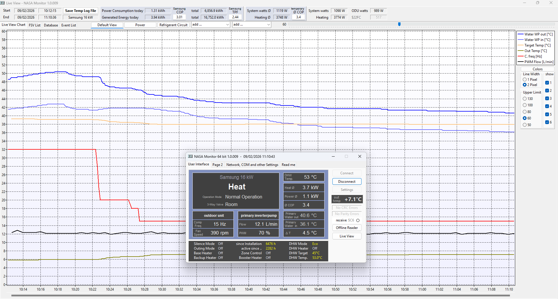

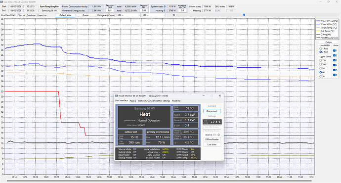

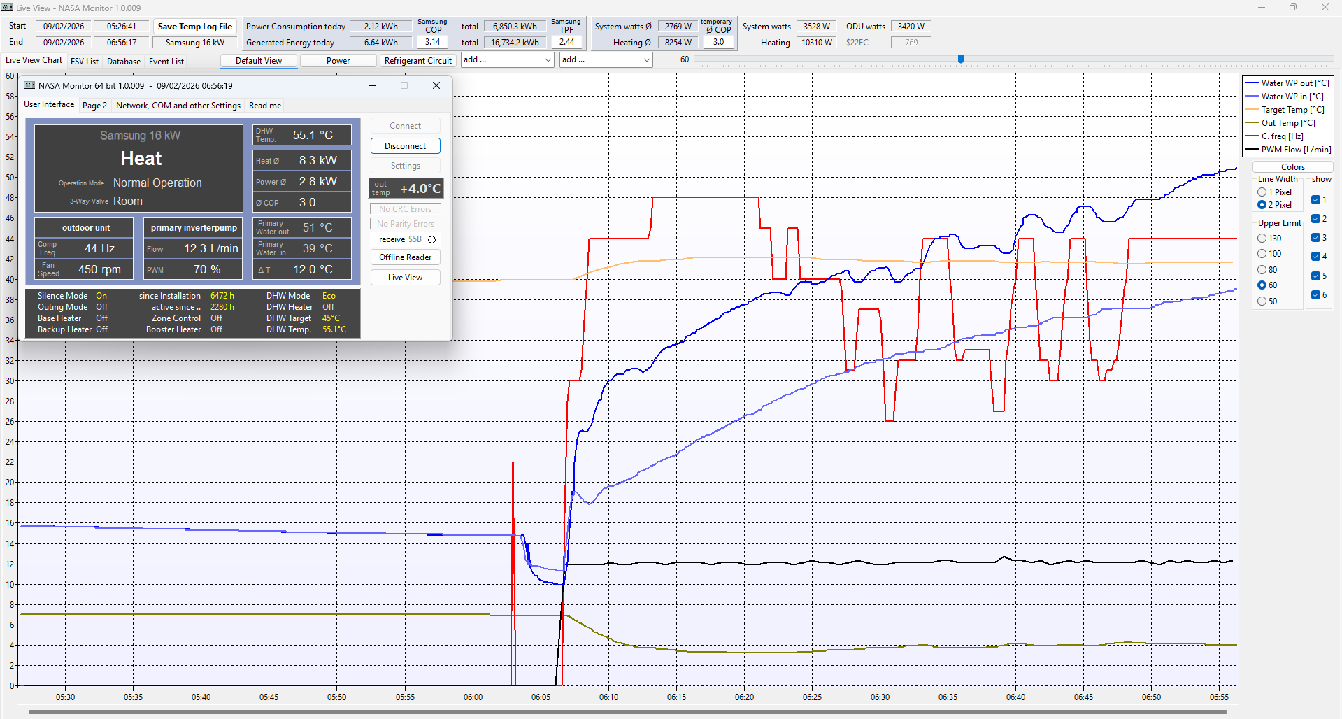

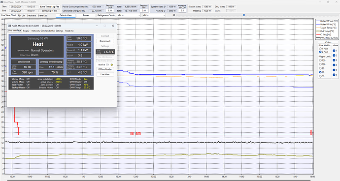

The system kicked back in this morning at 6am, but what seemed to happen was that the Compressor ended up running up to 44Hz and then eventually just seemed to stay there, even though Water Outlet Target was around 42 degC, the Flow and Return temps just seemed to keep rising well above this threshold.
I thought the Frequency of the Compressor would have modulated, to keep Water temps close to setpoint?
So that confused me to start with.
As an interim measure I changed 5051 to 1 to try and limit Compressor Freq, not sure if this will help.
I really don’t understand why Compressor frequency isn’t modulating to control Water Outlet temp?
Hmm that’s odd. I’d give it a bit more time than your display covers.
I haven’t used #5051, though I know some brave users have. (I don’t think that just setting it to 1 will do anything - you either need to apply a DC voltage somewhere (?) or send a Modbus command.)
Also I don’t use Quiet mode, but perhaps this is affecting the speed reduction algorithm.
A quick look at the FSVs you posted doesn’t reveal any howlers…

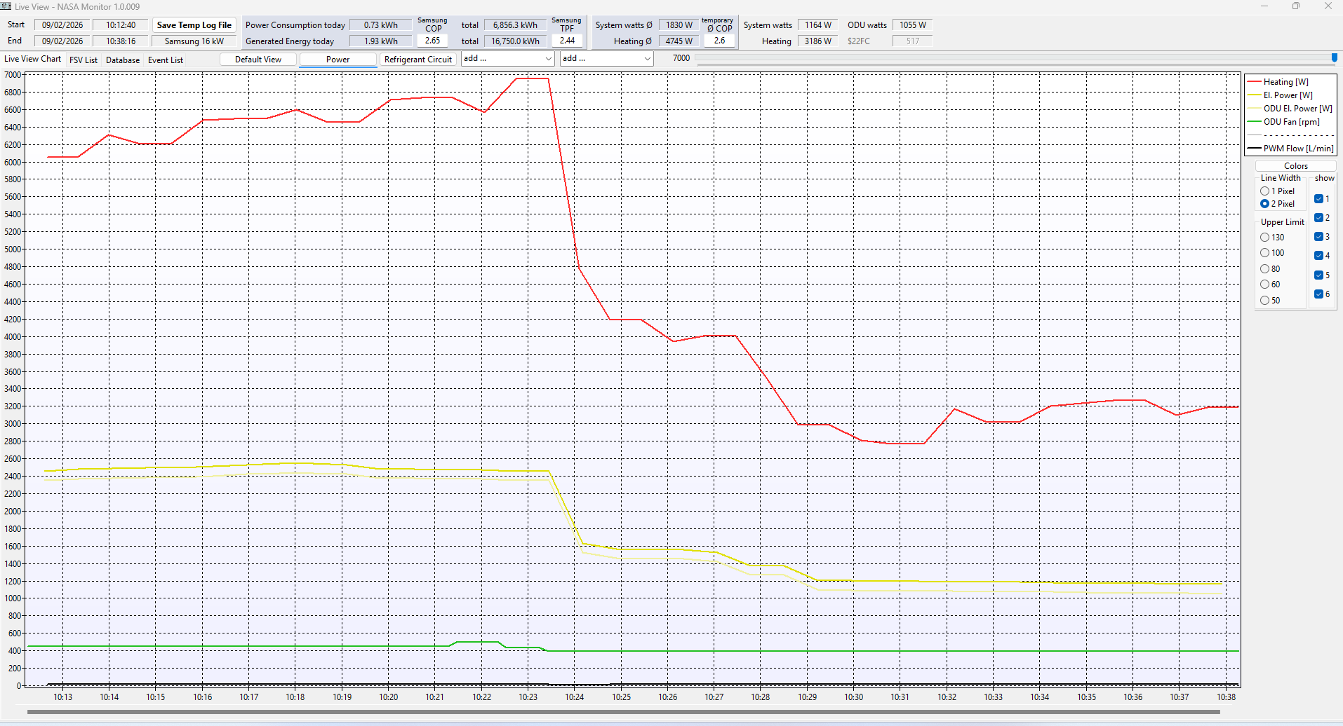

I still believe that reducing your LWT target might help. A quick and easy experiment would be to use the +/-5degC target offset available on your WRC. Set it to -5degC and watch your NASAmonitor display. You should see the yellow trace drop, and your compressor speed should also start to fall. Does it?

I set the parameters for Water Law to be more like default, ie for Outside Temps of -5 and +15 = Water Outlet temps of 50 and 30.
Things have started settling down a bit.
Brilliant :clap: :slightly_smiling_face:.
Have a look at the Power tab. You may find that your instantaneous CoP has reduced a little, but your power consumption should be satisfyingly low.
Interesting that your (LWT - RWT) deltaT is also reducing. Can you explain that?
Wow…………so that seems to have dropped from 2.5 kW (El.Power) to 1.2 kW (El.Power)
Delta T seems to have steadied now at around 4 DegC.

There’s a useful data point for you there. Assuming that your house temperatures are reasonably constant, your house heat loss is roughly what the HP is producing, i.e. about 3.2kW, for a (house-to-OAT) deltaT of (22 - 7) = 15degC. So you can pro-rate this for other deltaTs. At 0degC OAT you’ll lose about (22-0) /(22-7) * 3.2 = 4.7kW. You can use this to estimate what LWT you would need to supply this, and hence what #2021/2 settings you should set.

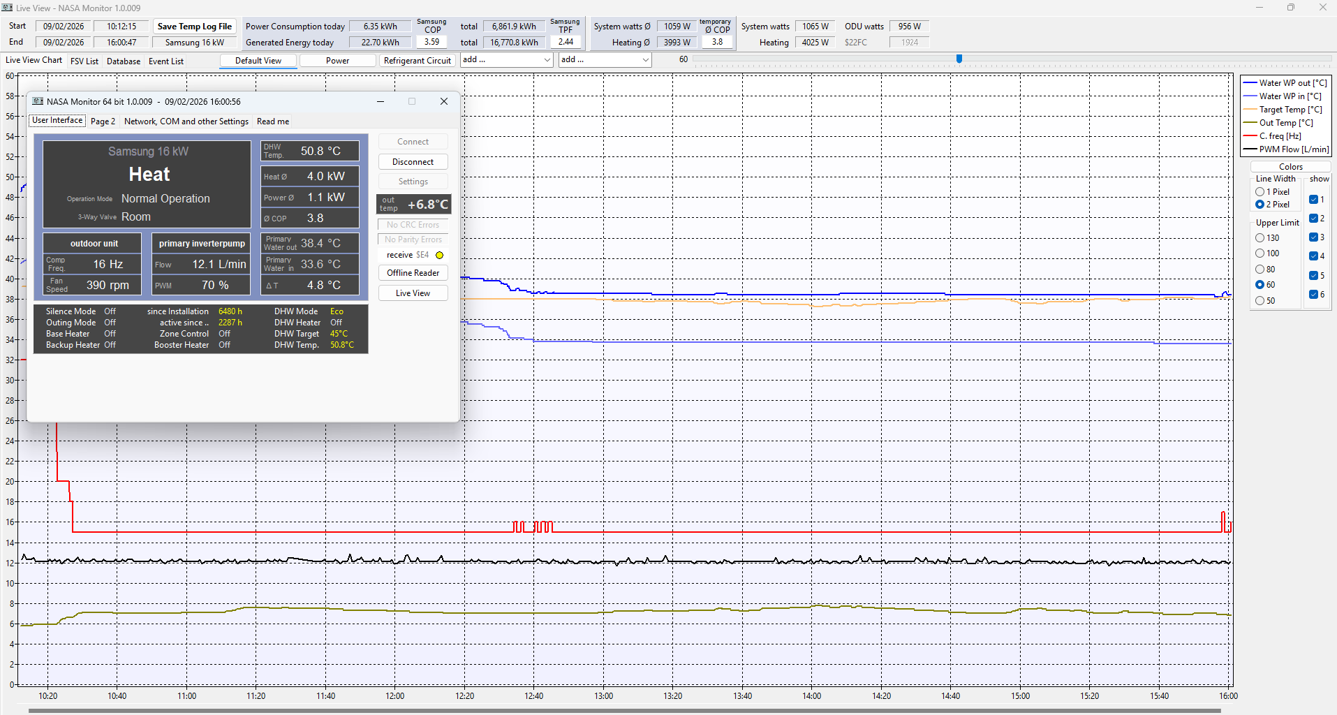

So at the moment I have my Water Law set to OAT -5 to 10 DegC corresponding to Water Outlet Temp of 47 down to 37 DegC.
To be fair, this seems roughly about right for my house, because all heating Zones are 100% open and most of the house is reading between 20 & 21 DegC, so no one is complaining about lack of heat, which is a great first step for me.
The only Zones I dial back at night are the Bedrooms, which I drop back from Target of 22 DegC to 19 DegC, just to be comfortable at night, but everything else stays on at 22 DegC target temp which never quite gets satisfied, so the call for heat is at the moment always there for the ASHP, hence 24/7 running.
Generally the ASHP seems to pull around 1kW, so pretty much I know it will use around 24kW/day give or take.
PS - I don’t use it for DHW, just heating.

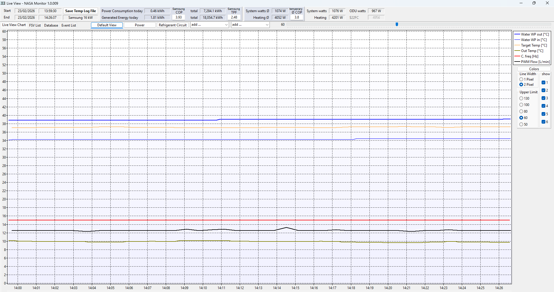

It produces at the moment a COP of around 4 as I can see from 1kW electric power it seems to produce about 4kW of Heating power.
Today we have OAT of 10 DegC, which is the top end of my Water Law.

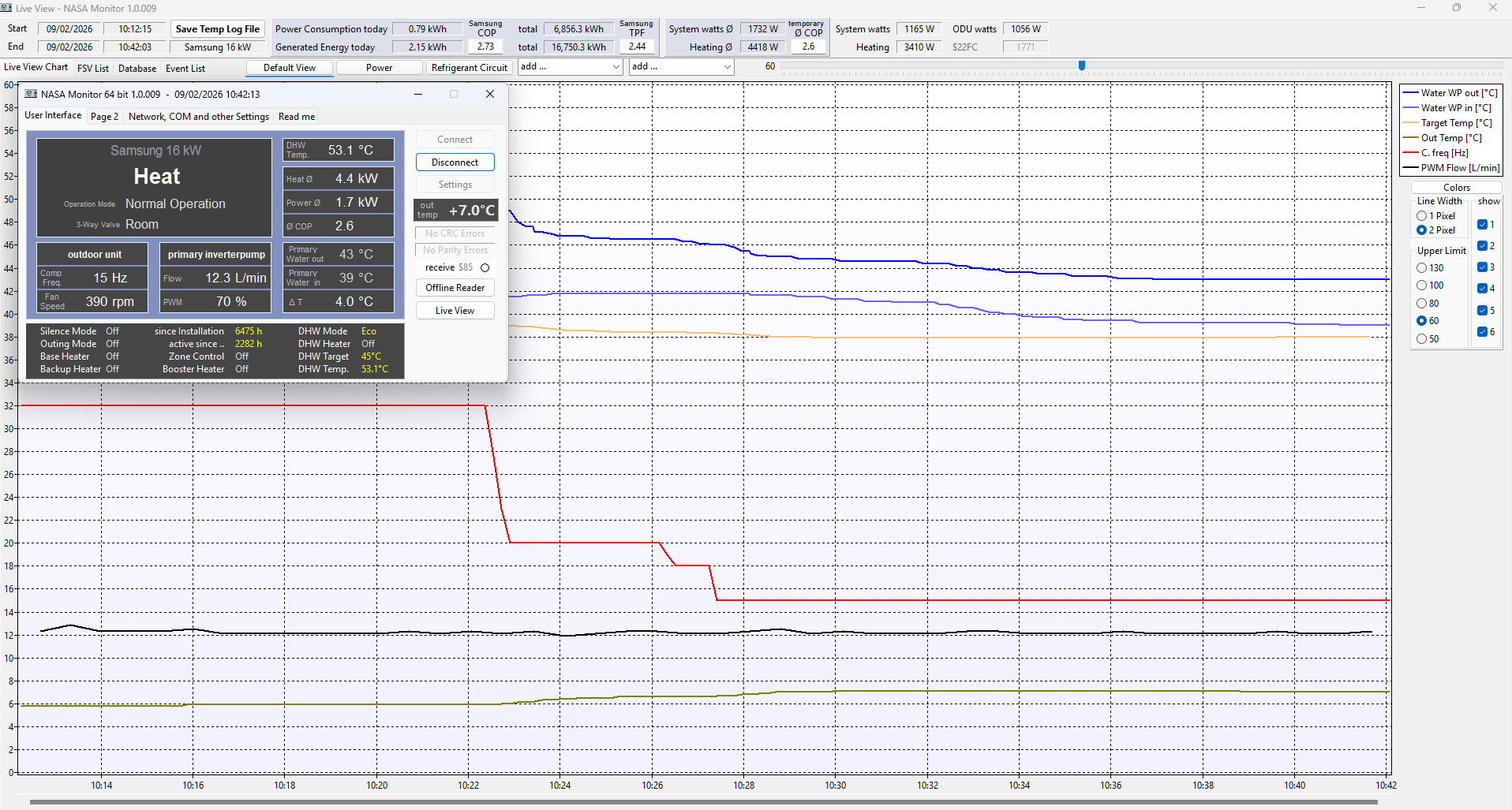

The setpoint is sitting at 37 DegC, but my Water Outlet Temp sits a couple degrees above that at 39 DegC and seems to be just flat lining.
I notice the Compressor frequency is also flatlining at 15Hz and the Fan speed is doing the same at 390 rpm.
Have I actually bottomed out here, ie is this 16kW ASHP just running now on its minimum and therefore I wouldn’t get any lower temps from it with OAT of 10 DegC?
Does this point towards too big an ASHP and/or too small the installed emitters (radiators) or can I derate the ASHP somehow to lower its heating output further?
I have a Gen 6 16kW Samsung AE160RXYDEG.
If the outside temperature is > 9.5c it won’t output less than 30c.
Ok, well good to know and I think I have the same model Samsung ASHP as yours AE160RXYDEG..
I guess if I could get it to go down to 30c then that would be great, but maybe other things in my system are preventing that from happening?
I am not sure whether the issue here is simply my Emitters are not large enough to drop the Water temp any further than current outlet temperature of around 39c or whether it is to do with Pump speed/Flow rates etc?
The Compressor seems to have “bottomed out” to 15Hz and Fan speed to to be “bottomed out” to 390rpm, which I am assuming is minimum running levels for both devices?
I just didn’t know whether I could change a parameter to “de-rate” the ASHP down to act more like a 12kW, 8kW unit?
